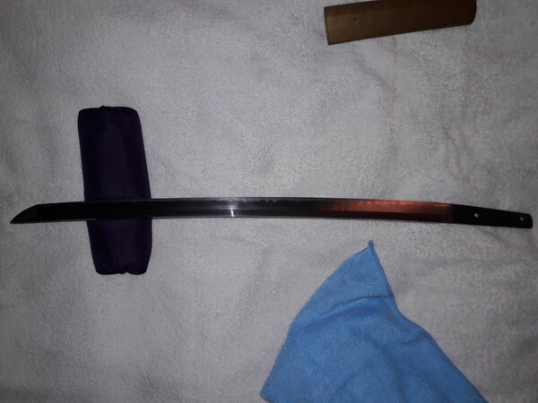

Juss...This "project" is for a possible Mino O-Suriage Waki. You might have seen it before as I posted it once or twice????

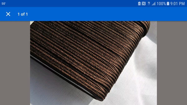

So far I've put together a Tsuba (Ko-Kinko Muromachi?), Fuchi/Kashira (looks to be mid to late Edo?), dark brown Japanese silk Tsuka-Ito and some really nice Tulip Poplar. I'm still looking for a pair of Menuki that would match and the Same.

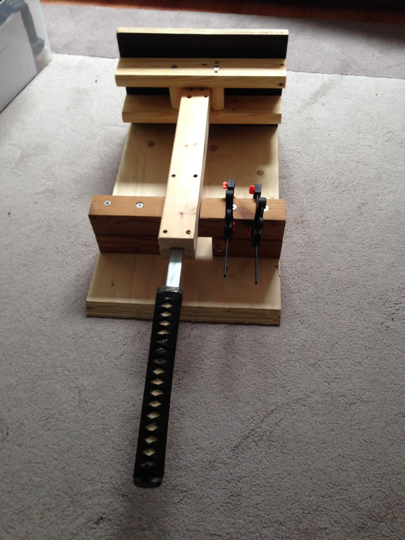

I'm in the process of making a stand using these plans. I did manage to find a nakago blank (forgot traditional name atm). It's made surprisingly well and powder coated.

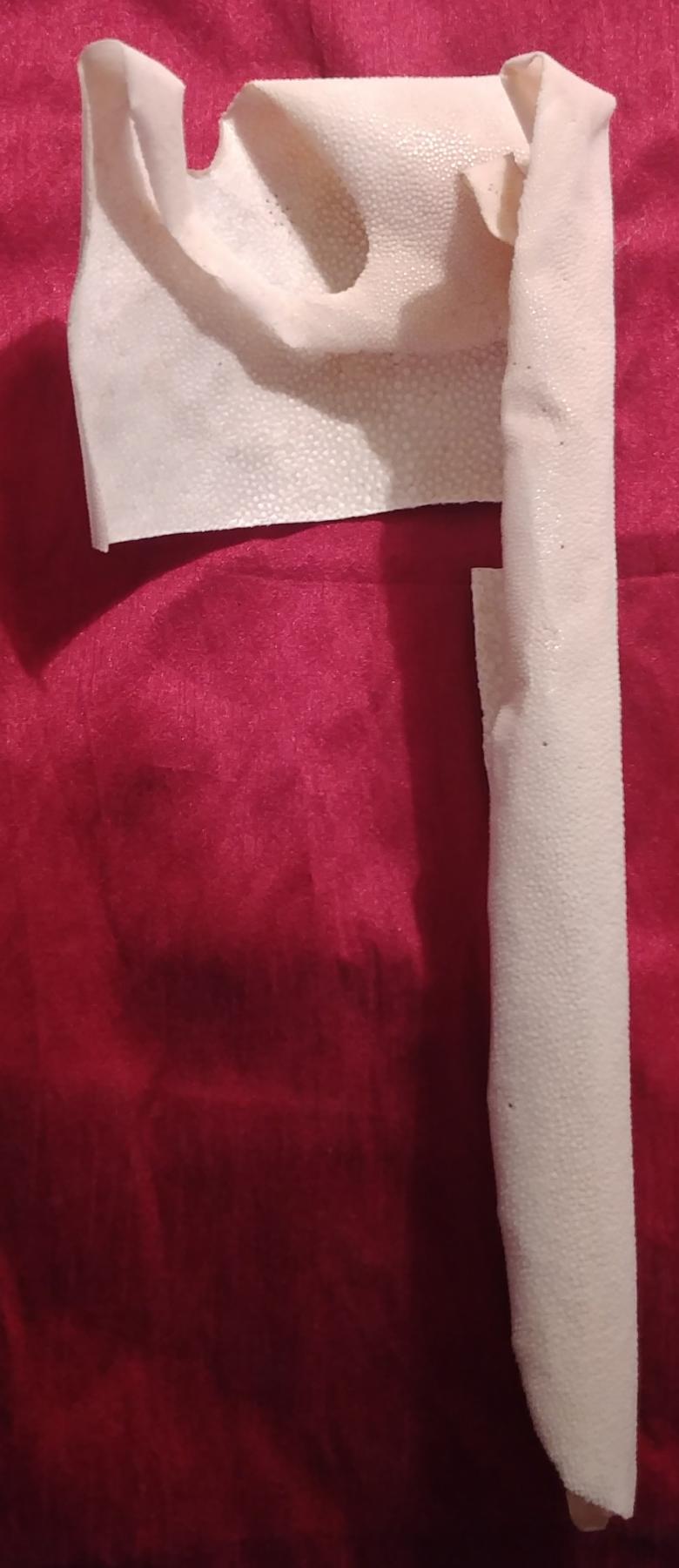

Actually, it does.  ;-)  If you're looking to start off with black samegawa, you're going to be buying ray *leather,* not rawhide.  It will not do the same job, and is a different animal altogether, so to speak...  It will be pliable and polished, not stiff and sharp.  Just an fyi.  :-)

Seriously thanks for the ideas! Oh yeah, here's the tsuka ito
