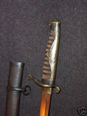

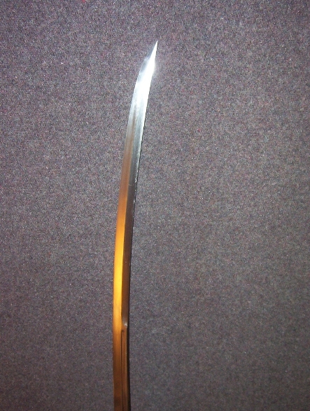

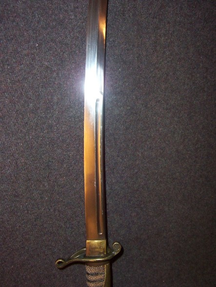

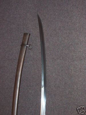

Here's a sword I just recently picked up.
It's in transit from the US so all I can give at the moment is a few photos.
My hope is that someone may be able to tell me straight off if I've bought a piece of junk here.
I don't think it is a low grade factory sword simply due to it's tsurikomi.
Anyway, I'm a novice so other opinions would be helpful.
:dunno:
Hmm....that is going to be interesting. It is not a regular military pattern blade. Looks like a nagamaki style blade?
I look forward to the nakago pics when you get it.
Brian
It doesn't seem to have a screw mekugi which is usually not a good sign as it means the bottom of the nakago has a screwthread. More than likely a factory made blade I'd say, the majority (but not all) of old blades in this style of mount have a mekugi.
Very interesting sword though, certainly not junk...

According to Fuller & Gregory (p.66, plate 87), this could be the mounting of a police sword dating from Meiji-period. One would not expect a quality blade in this case.

Guest reinhard
James,
If you find a copy of the "Kogarasu-maru" by a famous ShinShinTo-smith as Gassan Sadakatsu in a mounting like yours, I'll be the first one to congratulate. It is not very likely though. Good luck anyway.

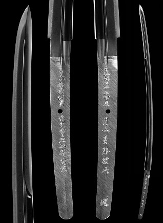

Thank you Morita-san, for the very interesting link to Murata-To and the Mukade-giri maru. Things like that you don't find easily in the "western wide web" ;-). (A tiny mistake on the page: Taisho 8th year is 1919, not 1933). Murata-To would very well fit the mounting (police sabre or civil-officer's sword during Meiji/Taisho-era). I'm looking forward to see the nakago.
