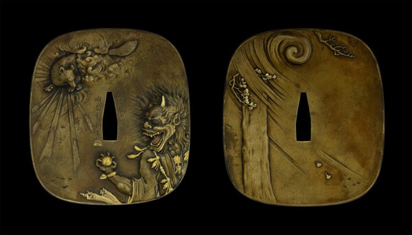

Gunome Posted December 24, 2018 Report Posted December 24, 2018 Hello Uwe, Thanks for the answere. Another point is nakago: nakago jiri between Tadayoshi and Tadahiro is not the same, and for Tadatsuna, both nakago jiri and yasurime are differents. Very desirable tsuba... ! Quote
