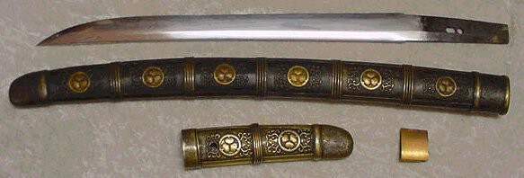

Lorenzo Posted June 26, 2008 Report Posted June 26, 2008 Are you talking about something like this? If so, kanji should be something like this: è¦å¤·æ‹µ Quote
Lorenzo Posted June 26, 2008 Report Posted June 26, 2008 Or maybe this: http://www.finesword.co.jp/sale/touken/ ... tanaho.htm Quote
Brian Posted June 26, 2008 Report Posted June 26, 2008 Hi Lorenzo, Good to see you here. (Assuming you are the Iron Brush Forum Lorenzo) That first pic isn't Ezo though...those are touristy Meiji period fittings, although in this case housing a much earlier blade. I have a tanto in those mounts too. Very late export mounts. Regards, Brian Quote
Lorenzo Posted June 26, 2008 Report Posted June 26, 2008 ehehe Brian you know me... i am a total messy I think so about the first one. I was trying to type ezo koshirae in kanji, to make a search to help Ford. Problem is i am not sure that ezo kanji are the ones i written (the first two). I wonder if the second one is what Ford means. Ford? Quote
Ford Hallam Posted June 26, 2008 Author Report Posted June 26, 2008 Hi Lorenzo, thanks for that image, but to be honest I think this is much later than the dates claimed for the group I'm interested in. I should have said Ezo kanagu really, or Sho-ki kinko. There are number of decent images of this grouping of metalwork, on the Tosogu forum. It would probably be a bit rude of me to "steal" them and repost them here I have the Henry D Rosin collection catalogue, with the tiny bit written by John Harding...not that it helps much regards, Ford p.s. sorry about the confusion, I had problems getting logged on again. Quote

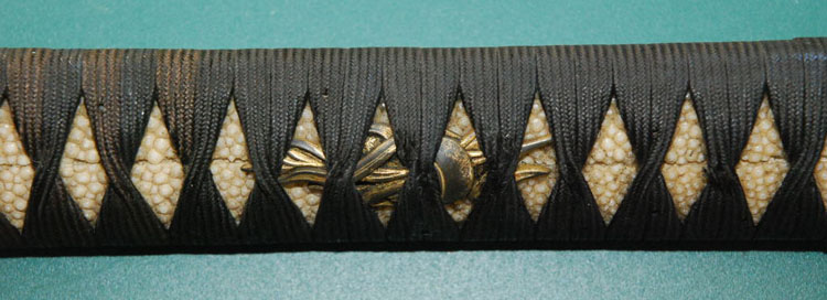

Bungo Posted June 27, 2008 Report Posted June 27, 2008 http://www.esnips.com/doc/c6e11a2d-aef5 ... 8/ezo_1270 example of ezo menuki.Posted here before but couldn't find the message, so here it is again. milt Quote

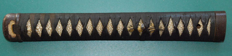

Pete Klein Posted June 27, 2008 Report Posted June 27, 2008 This is an example of Juyo level Ezo menuki: Quote

Bungo Posted June 27, 2008 Report Posted June 27, 2008 I have another set of ezo menuki ...........7cm long. http://www.esnips.com/web/menuki?docsPage=5#files milt Quote

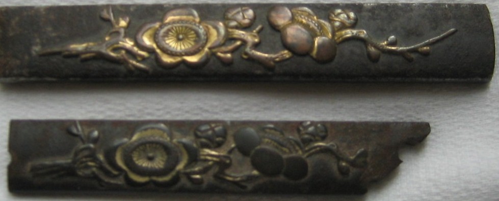

Jesper Posted July 27, 2008 Report Posted July 27, 2008 Hello all, Here are some images of what I think are Ezo menuki. The design is flowvers in a basket. They are quite worn and much of the gold is missing. They are approx. 5.3cm long. Jesper Quote
