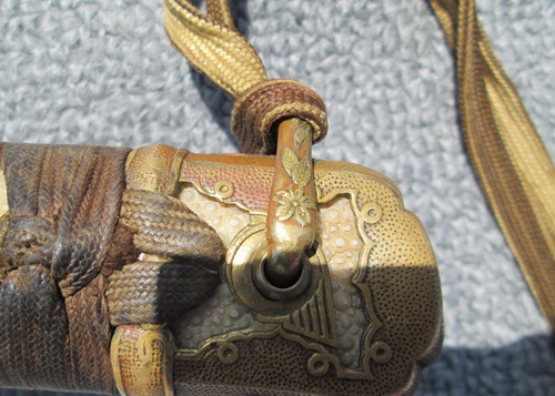

Bruce Pennington Posted December 13, 2018 Report Posted December 13, 2018 That is an oddball! Hopefully someone who really studies tassels can chime in. The general's tassel should look like this the attached. 1 Quote

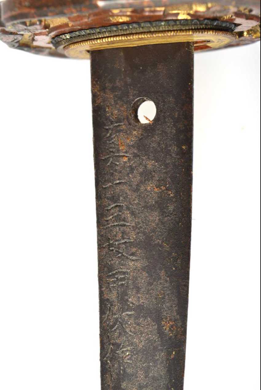

Windy Posted December 14, 2018 Report Posted December 14, 2018 It sold for £950 plus auction house (usually 23-30%). Description as follows: A Shinto Japanese Katana with Special Order Shin-gunto Mounts, the 67.5cm blade with large irregular hamon, bo'hi running for 24cm from the one piece copper habaki, the tang signed ''MUSASHI TARO YASUKUNI'' and ''MA JU GO MAI DO FUKU SAKU'', with parcel gilt bronze tsuba, the yellow braid bound same hilt with triple chrysanthemum head menuki, the prunus decorated copper kashira set with silver family mon, hung with yellow and brown cord and tassels, the browned scabbard with copper mounts matching the hilt, with a later mahogany display stand; together with, oshigata and research material, a hessian label inscribed TAKIYAMA, OFFICER, a leather and red velvet belt and pistol holster richly embroidered with flowerheads and leaves in raised gold bullion thread, and a printed photograph of the surrendering office in a leather folding frame (4) Provenance:- surrendered at Bangkok, Siam on or around 11th January 1946 by a General of the 18th Japanese Army. Blade with hagire 18cm from the tip. Numerous areas of delamination. Braid on hilt is soiled, otherwise good. Quote

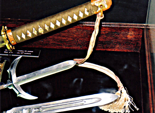

Stegel Posted December 15, 2018 Report Posted December 15, 2018 Quote Civilian admin tassels are a creamy (off white) and brown, i've only seen them with South Manchurian Railway swords, but no yellow exists to my knowledge. What i was referring to here, can be seen in these pics: Even this one shows evidence of wear and fading of the straps going towards the tassel itself. Ohmura says they were used by the Police-affairs organization which the South Manchurian Railways oversaw. 2 Quote
Stegel Posted December 15, 2018 Report Posted December 15, 2018 These are pics from the OP that i adjusted exposure/contrast to see variations in colour. The yellow is definitely there... crop of original picture supplied (rather dull lighting) adjusted picture : Quote
