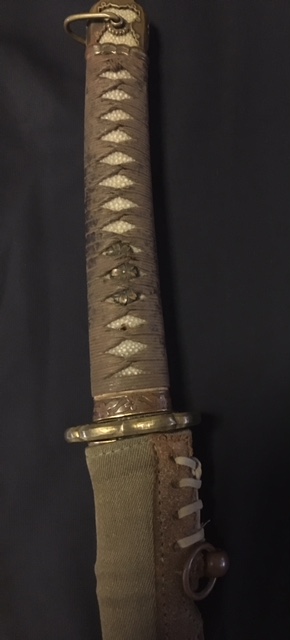

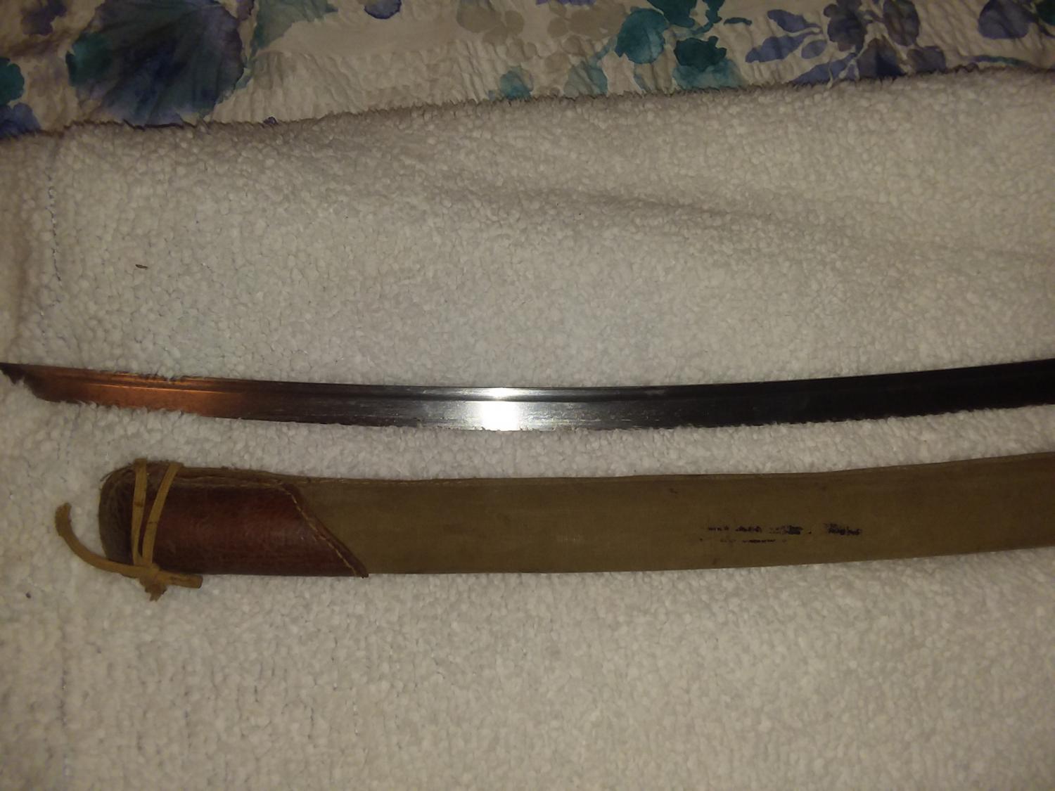

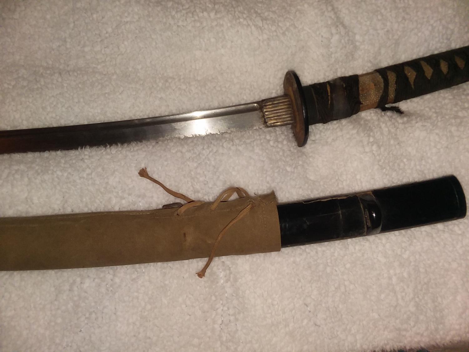

My grandfather captured 2 swords on Bougainville during WWII. This one is a military sword he took from a Japanese Captain. My grandfather was somewhat famous in the Corps for starting the Marine sniper program and he retired as a Brigidier General. He was awarded the Navy Cross at Bougainville and was nicknamed "The Beast" by his Marines. I don't think this sword is worth much, but it was captured by a true warrior.
George VO
Great family heirloom, make sure it is documented for future  generations of your family. While it is probably not a national treasure, it is worth preserving as is as a great WW2  artifact. Some members on this forum will ask you to pull it apart to show other details, just be careful, it is already fragile.
George,
as far as the photos allow an assessment, it looks like a civilian sword wilth a military cloth protection cover for the SAYA. It is obviously quite neglected, but here on NMB you will find lots of information about how to handle these items and how to prevent further damage. Besides its value as a war trophy, it may have some market value, and it would be a pity to see that being lost.
Thank you for sharing, George! I would bet your sword was made long before WWII. The fact that the seppa (washers) overlap the hole in the sword guard (kogai hitsu-ana) is also of particular interest to me, as it is also the case on my WWII gunto, which is fitted with an older civilian tsuba.
George's sword is interesting in many respects, among other things as a testimony to the use by Japanese officers of fully civilian-mounted swords during WWII with only minimal adaptation - here, the canvas saya-cover. I would be interested to know whether there ever was a tassel on this one, as (to my point of view) no army or navy sword would ever be worn without the corresponding tassel.
I have read somewhere that NCO leather tassels were no longer available by the end of the war - could that also have been the case for officer tassels?
It would probably had a blue/brown tassel, I think I can see a hole at the top of tzuka  for a sarute. The canvas cover was often used, finding good examples these days not so easy.

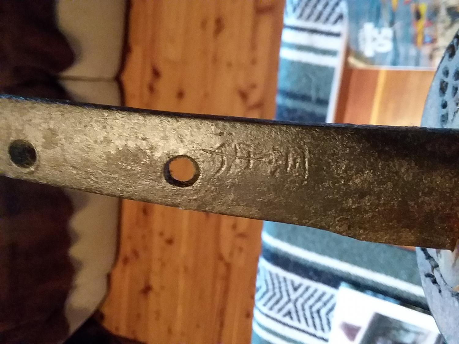

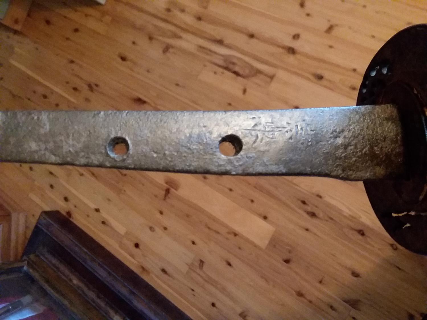

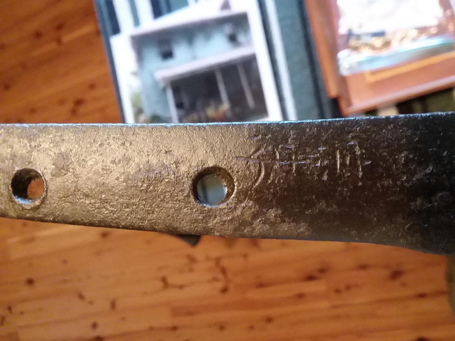

Here are pictures of the name under the handle of this particular sword. Not great pics obviously, but maybe someone can figure it out.
Thanks, George VanOrden

I do not want to raise hope or expectations, especially as we have seen only tiny snippets of the sword and not the entire bare blade (stripped of handle, metal collar, hand protector etc) and also close-ups of the pointed tip and the sides of the blade. I am deliberately avoiding more specialist language but can go into that as necessary.
Now, there were various older/ancient Bizen smiths who signed Munetada. The shape of the tang is indeed an ancient shape and could either indicate a very old age or a later smith emulating old, historic shapes. The tang does seem to have some old age to it, evidenced by not really visible file marks on the tang and the patina but needs a close inspection in hand as an original tang on a sword is a great indicator of age.
There were some of those Bizen smiths called Ichimonji and ko-Ichimonji. They had a hardened edge (hamon) which was narrow but quite active. Here I cannot see the hamon well to judge. Also, Ichimonji had an interesting feature like a shadow on the blade surface called utsuri. The older Bizen smiths had something called jifu utsuri (fingerprint like whitish spots above the hamon).
I think I can see some of that but not sure if what I see is an artefact of lighting or just staining due to lack of good polish.
However, on the balance of things - older looking tang, signature on that side of the tang (tachi mei), possibly older surface grain (jihada), I strongly recommend you have this looked at by someone experienced. It is not unusual for senior officers (such as your grandfather) to receive hereditary swords from similarly senior commanding Japanese officers (which generals’ swords sometimes were not machine produced but were in fact old).

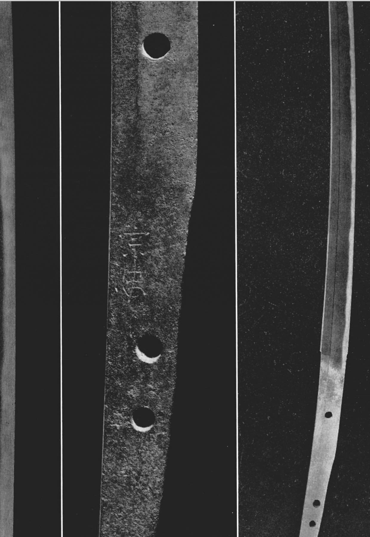

To go a bit further: below I attach images of very highly rated historic swords bearing the signature of Fukuoka Ichimonji Munetada.
There are some similarities in the “tada” characters to your sword and also note how one of the images has the same shape tang as yours and in fact even one of the (probably original) retaining peg holes is in a similar position vis-a-vis the signature and the bend in the tang. There are some differences in the “mune” character, but I have noticed that even in the documented examples I have there are differences among them.
All of this is making me even more curious to see the entire blade and look at closeups to check whether you indeed you might have a very valuable blade. Things to examine carefully are the signature chiselling (upturned edges or time-smoothed lines, patina in the signature grooves), the tang patina, the blade surface (jihada and shinogi-ji), the blade tip (kissaki) with its edge hardening (boshi), the presence of lack of that shadowy surface hardening (utsuri), etc.

Michael, Thanks so much for taking the time to write such an informative message. I have ZERO knowledge of actual terms, so I appreciate you breaking it down to an understandable form. I still don't have any idea of what age you are speaking of, but one of the pictures you posted looks exactly like what I have. The swords that my grandfather brought back fro the war in the Pacific were taken from soldiers that he had killed. The sword in this photo is a lot less substantial than the other one he brought back. I always assumed this sword was a mass produced military sword. You can see photos of the other sword if you search my past posts. I have not removed the handle from that sword and would prefer a professional did that.
I will take more pictures this afternoon and post them for you and others to see. Please let me know if there are any specific areas you need to see.
I'm not getting my hopes up, but what is a general value of the swords you mention made by Munetada?
Thanks again,
George VO
This needs to be combined with other post. Thanks Michael for the pix...the sword in question needs futher study as a possible rare find. Looking forward to where this is going.
Well, George and others. I am very intrigued as the nakago and the smooth-looking edges of the mei/signature seem to indicate age and possibly even Koto era (George this would be 13c-14c) but again - with these pictures one cannot tell. Frankly, I do not think the polish is good enough at the moment to judge the finer details but an overview of the bare blade shape and closeups of the surface (jihada) and tip (boshi and kissaski) and also sideways lengthwise photos with tip pointing towards a single light source to show the forging and shadow (utsuri) would help.
George - if this is a genuine Fukuoka Ichimonji Munetada (again, please do not raise hopes just yet but some of the indications are there), this will be a very valuable blade (several tens of thousands of US dollars) as that smith is rather rare. There are some very highly rated swords by him (Juyo Bujitsuhin and Juyo Bunkazai - these are ratings denoting historically important blades).
