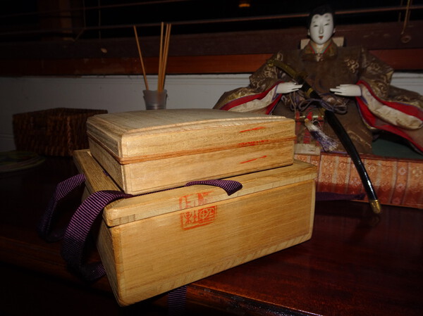

FletchSan Posted December 14, 2018 Author Report Posted December 14, 2018 Thanks so much Ford, really appreciate your feedback on my Tsuba and glad to see it's at least a genuine Meiji era piece. I've decided to keep it - I do really like it and I guess that's the main thing and understand it may not be as collectible to tsuba enthusiasts given the period and market it was intended for. Not sure it adds anything - though it came in two boxes which have a stamp. cheers, Ben Quote

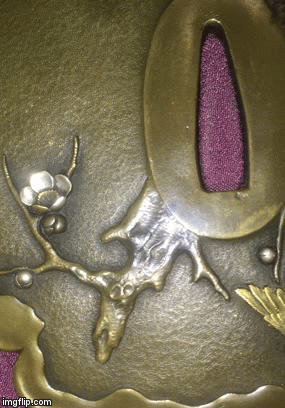

FletchSan Posted December 16, 2018 Author Report Posted December 16, 2018 A nice little animated gif of my Meiji era Japanese art object that shows the textures and detail Quote

parfaitelumiere Posted January 11, 2019 Report Posted January 11, 2019 I read page 2, saw the yahoo link, and watched details of both tsuba.Unless the tsuba on sale on yahoo is exactly yours, and it's not, it would explain why the carving details are identical.But it's not, because some casting defect on seppa dai on reverse side are different.The filing lines, engraving, and pinching are strictly identical, and this is impossible, even the ishimei pinching is identical, that is impossible, unless both tsuba would have been high precision casts. Quote
