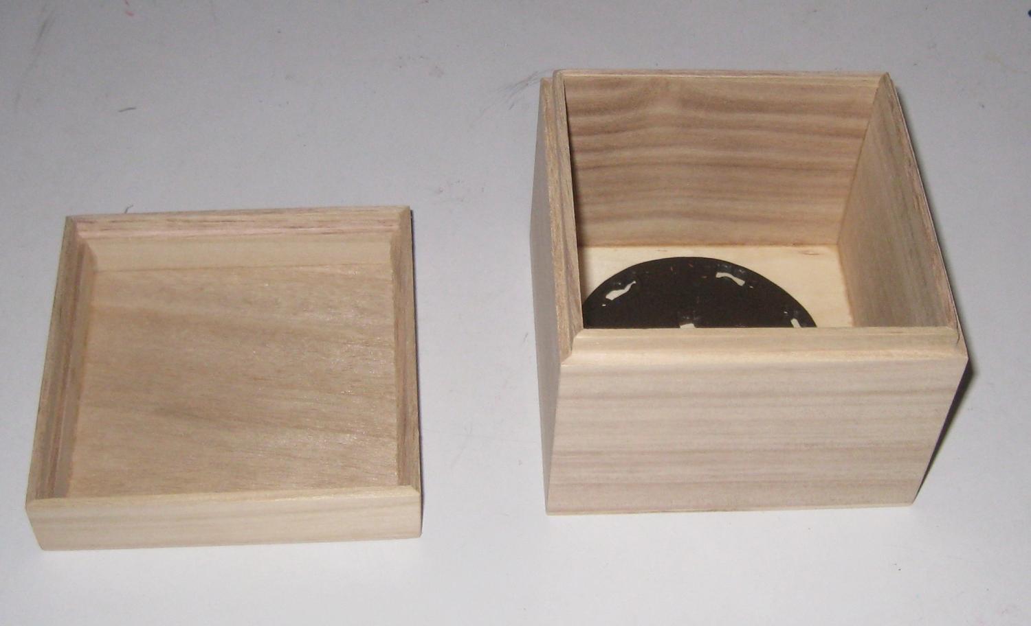

Gunome Posted December 5, 2018 Author Report Posted December 5, 2018 Many thanks for all the advices. I now see which kind of fabric I need to found. I will go near Montmartre, there is a many fabric shop with a huge choice. Otherwise I found a retailer of Japanese fabric in Paris, le Marais area. I know basalte, I used it in aero-modelism when I was young. I enclose pics to share my project with you. Yesterday I found this box in a shop. Very cheap 2.49€ ($2.. It is made of paulownia and measure 11.5 cm square (same as my tsuba box) and 10cm tall. I would like to create stages for at least 3 tsuba and/or maybe for fuchi kashira. Just to give you an idea, the tsuba Inside is 8.5 cm diameter. 1 Quote
TETSUGENDO Posted December 6, 2018 Report Posted December 6, 2018 Sebastian, Great find! Looks like it will work well for your concept, awaiting your post of the finished project. Bonne chance, -S- Quote

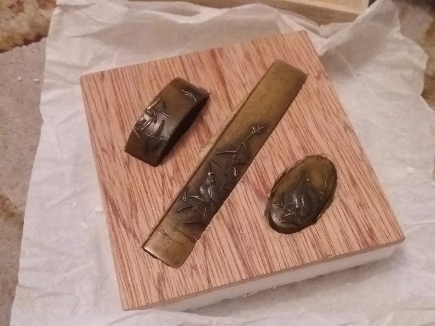

Gunome Posted December 20, 2018 Author Report Posted December 20, 2018 Hello, Just to give you an update on my project. I found a nice bleu fabric I made the bottom floor for a tsuba and I am now doing a tosogu set floor. Few pics to show you the first results. 2 Quote
Kurikata Posted December 20, 2018 Report Posted December 20, 2018 Well done. I like the way the print of the tsuba is integrated in the plate. It will be probably more complex with a kiku gata tsuba ???? Quote
Gunome Posted December 20, 2018 Author Report Posted December 20, 2018 Indeed Bruno, I chosen a marugata, more easy Quote
