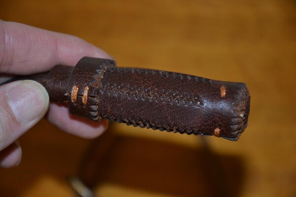

Bruce Pennington Posted December 8, 2018 Report Posted December 8, 2018 With WWII gunto, all the above options are possible. I have learned to never say "never" or "always" with gunto. Didier, as the owner will have to decide where he thinks this one lies on the spectrum of options and customization. Dawson has pictures of NCO's carrying civilian swords, NCO gunto, and officer gunto (as officer candidates). I was trying to find my reference for the officer candidate issue. Dawson has a couple of pics of NCO's as officer candidates carrying both Kyu- and T98 gunto, with officer tassels, but I thought I had seen some with NCO tassels on officer gunto as well, but cannot find the reference. Although my mind might be melding in the NCO T95 with Officer tassel instead. Didier, if you want to post some close-ups of the tassel barrel and the stiching on the buckle area, we might be able to help with ID'ing it as reproduction or original. 2 Quote

Yukihiro Posted December 8, 2018 Author Report Posted December 8, 2018 From the way it looks, I would be EXTREMELY surprised if this tassel were original... Quote
Bruce Pennington Posted December 8, 2018 Report Posted December 8, 2018 Thanks Didier. Yes definitely a reproduction. And agree with Dave on the interchangeability of saya - sometimes. I tried it on my Type 95s and some would switch and some wouldn’t, and those blades are more standardized than Officer gunto. But even with officer gunto there were some basic overall specs on dimensions, so always a chance of getting a fit on a saya made for another blade. 1 Quote
