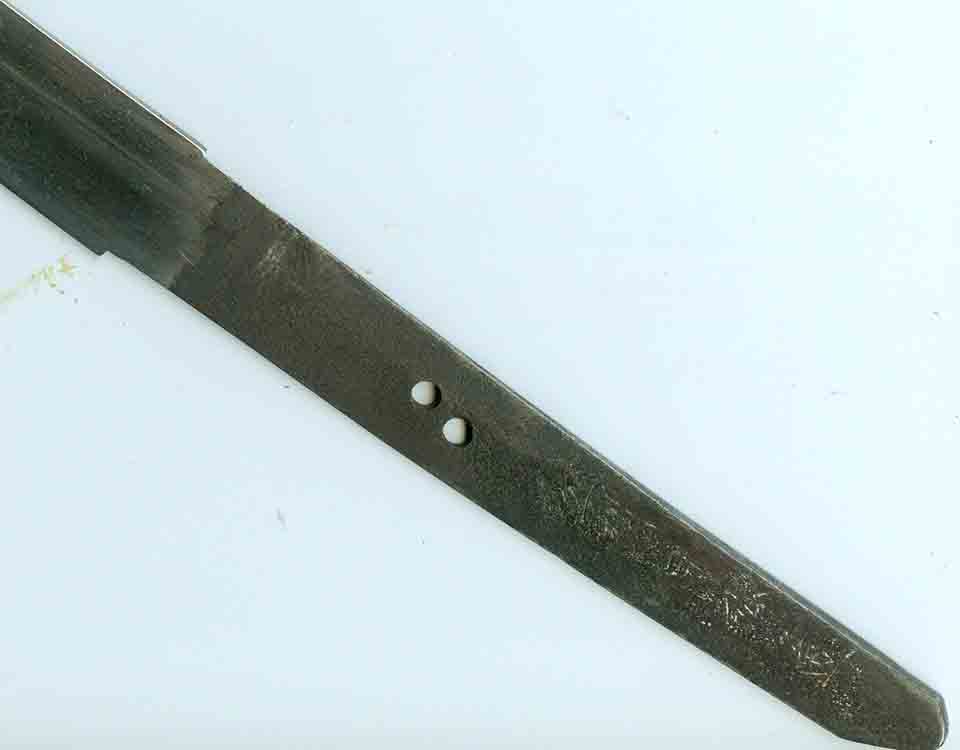

Just picked up this sword today from a Military Collector, the tag that came with stated as Maeda Hiromichi, is it correct and which period is this from?
Thank You... Joe

Guest reinhard
My mistake: the final character of the given name is the katakana for "ni". Therefore the (given) name probably reads: "Anthony" or "Antoni".
I can't say much about the mei. It is almost illegible for me and the nakago (especially the jiri) looks strange.
reinhard
Although almost illegible, the mei reads just as the tag "Maeda Hiromichi".
IMHO a Shôwa-like meiburi and nakago...

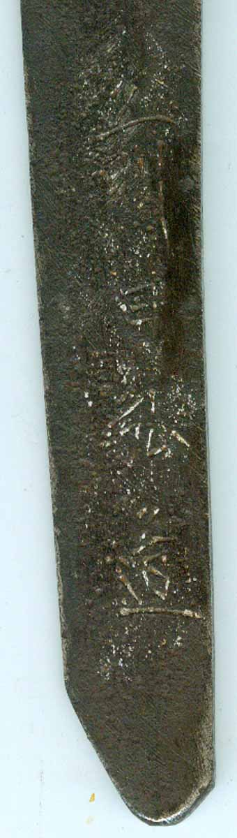

I don't see how anyone can be 100% sure that the tag is correct. If you ask, "can you see Maeda there?" then sure, but we could also see other things too. Whoever wrote the tag had the benefit of handling it and viewing it in different lights, an advantage that we don't have here, unfortunately. The area around the Mei looks very messy. Has someone tried to clean it up? Were there, at some time, other characters underneath? Can you take further shots from different angles under different lighting? :dunno:
This is what I see:
I think, together with the fact that there is the tag, we can agree that the mei
on the sword should correspond to the tag.
IMHO, the finishing of the nakago (that means the slightly rounded edges,
as well as the jiri) and the "tight" meiburi is very typical for Showa.
And of course, I am not 100 % sure. ;)
