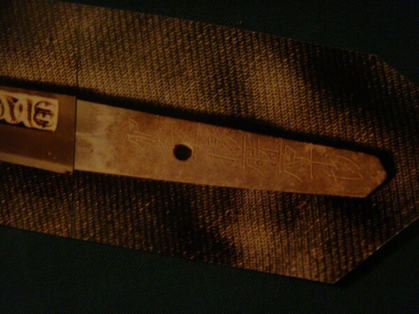

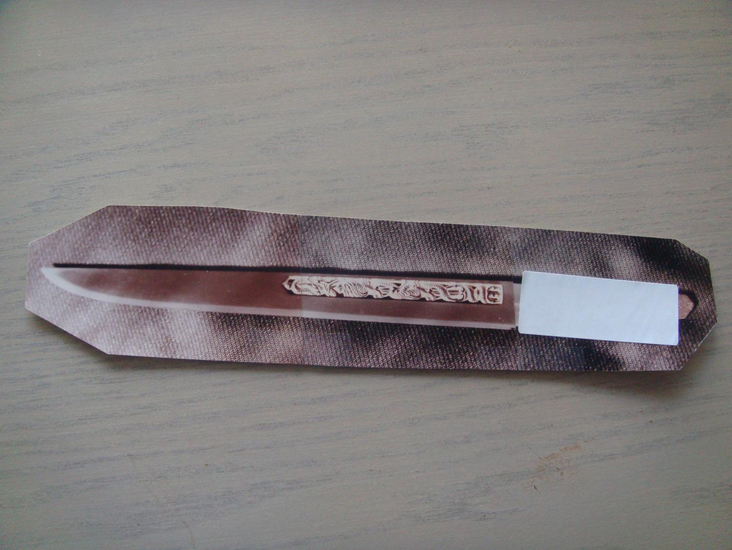

Tom Darling Posted November 28, 2018 Report Posted November 28, 2018 I owned this Nihonto 30 years ago, and thought you would enjoy seeing it. Your guess of Kaji is encouraged. Welcome to the party. Additionally, what is the most beautiful Nihonto - Under 2 shaku's! that you've ever seen? I will post the nakago in three days. Thank you. Kind regards, Tom D. Quote
Ray Singer Posted November 28, 2018 Report Posted November 28, 2018 Looks somewhat like Echizen-bori. If the horimono is not ato-bori, I would say it is an Echizen blade. 1 Quote
FlorianB Posted November 28, 2018 Report Posted November 28, 2018 No measurements and slightly blurry pictures make it not easy...Seems a very short but healthy blade with a top grade horimono and pointed nakago. That’s why I guess one of the Gassan smiths like Sadakazu or Sadakatsu could be considered.But it’s just a shot in the dark.Florian Quote
Surfson Posted December 1, 2018 Report Posted December 1, 2018 Two good and plausible guesses. I have nothing to add, as I am not a student of horimono. I do have a book on the subject of horimono, but alas, like many of my other books, I have not found time to read it. Unfortunately, the knowledge of unread books doesn't transmit nearly as well.... Quote
Tom Darling Posted December 1, 2018 Author Report Posted December 1, 2018 Hi Ray, Atari, Echizen-bori. "SHIMOSAKA YASUTSUGU" Regards, Tom D. 2 Quote
