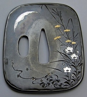

Unrecorded? Looking for comparison Mei.

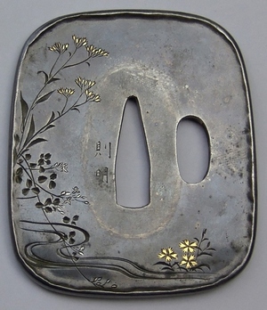

The Norisuke grandson signed Yoshisuke, though his artname was Noriaki. I did not know there even was an entry in Haynes under 'Noriaki' for Yoshisuke. If not the Norisuke grandson, then your tsuba smith is probably unrecorded.
I went through the Norisuke book and could not find an alternate reference mei for Noriaki, though Wakayama states in his Owari tsuba lecture that he has seen a tsuba by Yoshisuke signed "Iwata Noriaki saku".
From memory, it was Noriaki's widow who provided the NBTHK with the remaining Norisuke family books and tools around 1970 or 1971. If a reference example exists for Noriaki, they would have it.
Yoshitsuke looks to have used the same or similar chisels for signing as the shodai and nidai Norisuke. Your signature looks much finer than his Yoshisuke signatures.
Curran, thanks a lot for your input - I think I now can rule out the Noriaki listed, since the Iwata school worked in iron, even copying the "old masters". This Noriaki is purely Kinko, probably associated to Shonai Ikkin. I got some more material and will write up on it, but for now just some quick pictures:

Nice little tsuba. Most certainly not typical Norisuke work! :glee:
Yes, you are probably on the right track pursuing the Ikkin line or that general area. That is not a very strong area for me, and I have been trying to increase my library and familiarity with work from it. Nice little tsuba.
Many of the late Edo guys jumped schools several times and sometimes jumped names with it. See the "Toshitsugu" tsuba example at http://www.tetsugendo.com/
Sometimes I wonder if a name or two got dropped along the way. During the course of tracking down an unusual work recently, I came across one fellow who had changed his name about 13 times. It is possible your tsuba is either a transition name of a student, or just an unknown student.

Guido's tsuba is, indeed, very beautiful. I agree with Ford that the work is reminiscent of that of Ichijo Goto; the quality of the katakiri-bori is quite outstanding, and the balance of the design on the aoie-gata plate - rogin or shibuichi? - shows great skill. (Am I, perhaps, being a bit picky when I criticise the trailing stem on the bottom, left-hand segment of the ura surface?)
To me it suggests Kano Natsuo work, presumably by one of his many students. But realising that most of their work was signed as by Natsuo, and not knowing who Noriaki was, I am afraid this posting is of very little help!

It is precisely that trailing stem that has me captivated by it. I think because it is so unexpected and breaks the perfection of the subject matter, gives it a natural feel to me. I am sure the artist was saying something with it, but won't get too philosophical :)
The whole tsuba certainly is striking though, isn't it? Nice purchase Guido..I'm jealous again :)
Quite frankly, at first I had no idea about what you and Brian talked.
I found this tsuba very hard to photograph, especially the Katakiri-bori. I experimented a little with the lighting and angle, and thought that my photos showed the features as clear as possible. However, I now realize that not only the color is off (the patina is actually darker / deeper), but also those S-shaped lines look a little rounded or sculptured, which isn't the case at all.
For lack of more objective guinea pigs, I showed the Tsuba to my family and asked what they see. The answer was unisonous: a little stream; that's exactly what I saw all the time. Of course we still can discuss the artistic qualities of the arrangement, but holding the Tsuba in hand it really is obvious that we're not looking at a strange stem but water.

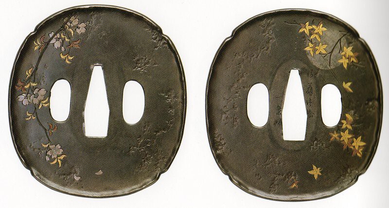

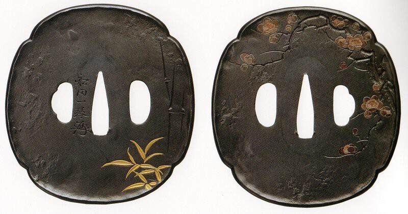

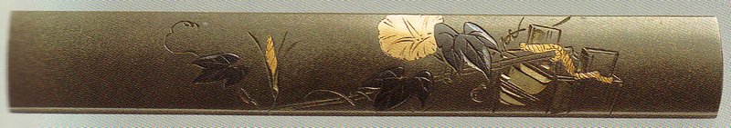

In any case, here are some pictures of works by the Ichijô Mon for comparison:
Now, I'm not delusional, and clearly see the differences in quality of the KodÅgu in the scans in comparison to my Tsuba. I like it very much nonetheless, especially the "modern" feeling it has to me. I bought it for what it is - as Curran put it, "a nice little Tsuba" - and not a piece equal to the masters themselves. But at least it isn't one of those "miniature iron steering wheels" ... ;)

Picture # 1 shows the Tsuba as illustrated in the magazine "Koetsu" in 1977, and pic # 2 in the NBTHK Kanteisho from 1992. It looked like in pic # 3 when I bought it, and pic # 4 shows it after I cleaned it. Pic # 5, after "repatination", was taken yesterday, and gets as close to its true color as my limited skills with a camera permitted; it also gives a good impression of the Nashiji effect Ford mentioned.
