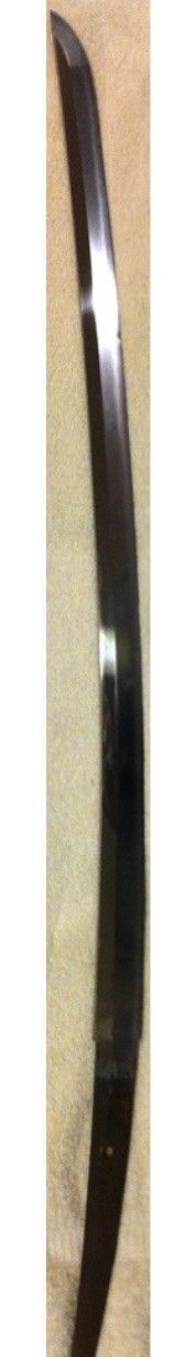

This katana is in WW2 mounting and I initially thought it was a gendaito blade (given it has no stamps and a light patina) but could it be older?
It has a very nice pattern that reminds me of gassan blades (even though the lines are parallel to the cutting edge so not really wavy).
Could it be a shinshinto work?
Thx for your ideas & thoughts
Eric
Eric,
looks like a nice blade! MEI says KANE....(MOTO? HISA?). Beautiful MASAME HADA! NAKAGO looks indeed SHIN-SHINTO, but I am not of great help here!
P.S. Un breton à New York?
Yamato school, Sendai Kunikane and Shigekune both influenced by Yamato masame/parallel lamination, with the
Sujikai-yasuri. My guess would be Shinshinto. Can't help you on the mei. Good luck.
Tom D.
The hada looks like a gendaito blade that shamsy shows here in the board some times ago. I can't remember what sword it was but i looks like very similar to this.
Eric,
now with Steve's invaluable help I have looked it up and it seems indeed to be a SHIN-SHINTO blade. KANESUGI, BUNGO province, KEIO period.
Congratulations, looks like a good find!
