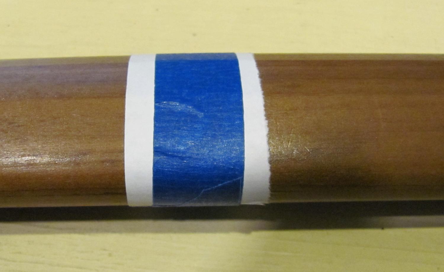

Andi B. Posted November 1, 2018 Report Posted November 1, 2018 Thanks. What about if a shirasaya sides are opening a bit? From mouth of shirasaya I just received, about 4 inches are not sealed together (using a rubber band to stop any further separation for now) . Rice glue? ? I remember having read that split shira saya can be closed by moistening the gap (actually the dried and broken rice glue in the gap) and then by pressing the gap till the reactivated glue is holding again. Rubber Bands can leave ugly marks on the wood if left there for years... 1 Quote
Grey Doffin Posted November 1, 2018 Report Posted November 1, 2018 Better than rubber bands for holding a split saya together: Cut a strip of paper about an inch wide and long enough to go once and a half around the saya. Wrap the paper around the saya about 6 to 8 inches below where you want the support and tightly wrap the paper with masking tape. Now, invert the saya on a table top and force the paper/tape band down towards the koi-guchi. Since saya are largest at the koi-guchi, as the band is forced down it will get very tight and offer excellent support. When the time comes for removal, shove the band the other direction and no evidence it was ever there will be left behind. Multiple bands at different heights can be used on the saya and the same technique can be used on a tsuka. These bands work well to hold the 2 halves of the saya in proper orientation when gluing with rice glue and I use a band around the koi-guchi of an unsplit shira-saya when I ship one, to lessen the chance that it split if the package is dropped. Grey 3 Quote
Blazeaglory Posted November 1, 2018 Author Report Posted November 1, 2018 Excellent! Thanks I don't want to leave the rubber bands because I know they can get gross after a while. That's a very smart method! Ok back to tsuka ito ???????? Quote
