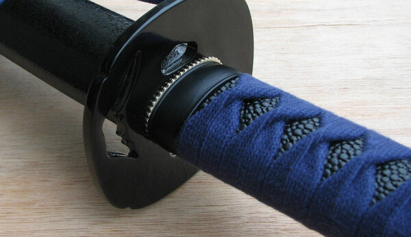

ROKUJURO Posted October 30, 2018 Report Posted October 30, 2018 Omar,that looks like a nicely crafted beefy SAYA, and as far as one can see, even the TSUKA-ITO was bound in a correct way. The blade may be well made, too, but it does not look Japanese in some aspects. It does not seem to have any HADA, and of course the polish cannot bring out more than is intended and 'invested' by the smith. It reminds me of many oil-tempered WWII blades with no activity in the HAMON. I am not suggesting to use it in TAMESHIGIRI, as I don't have the slightest idea about the technical qualities of the blade (resilience, hardness, correct cross-section a.s.o.), but it may be suited for that. Better than using a genuine (expensive) sword! Quote
PNSSHOGUN Posted October 30, 2018 Report Posted October 30, 2018 The fittings indicate a higher quality chinese production sword. 1 Quote
