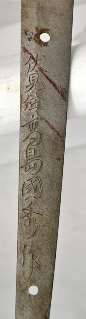

george trotter Posted October 25, 2018 Report Posted October 25, 2018 Hi all, may I ask a question of members? I have a very nice WWII RJT gendaito by Takashima Kunihide of Kyoto. Virtually nothing is known of him but his work is very good. He lived/worked in Fushimi, Kyoto. The sword I have (in good quality 'Alternative Standard' mounts), and two other mei of his I have seen, are all signed "Fushimi Ju Takashima Kunihide Saku". His work has papered. I don't have any evidence, but I have always suspected that he worked in the grounds of the Inari Shrine in Fushimi, Kyoto. Well, the other night I noticed on Page 185 of Markus Sesko's 'Index of Japanese Swordsmiths N-Z' that another Showa RJT smith Suketoshi (Kanasaki) worked at the "Kyoto Fushimi Inari-Jinja Token Tanrenjo". This information is the first time I have seen definite proof of a forge being in the Inari Shrine grounds. I suspect that both smiths, and others, worked there at various times over the war years. My query is, does anyone have any info on this forge? When was it set up? Who by? Who ran it? Who worked there? When was it shut down etc? Any help, info, pics etc would be most welcome. Regards, 6 Quote

Kiipu Posted July 27, 2021 Report Posted July 27, 2021 I followed-up on this and there is no 國秀 Kunihide listed in 1937. He could have been an apprentice though during this time frame. Since I am here, I transcribed the characters and this is what I see. Do you concur? 伏見住高島國秀作 = Fushimi jū Takashima Kunihide saku Quote
george trotter Posted August 17, 2021 Author Report Posted August 17, 2021 On 7/28/2021 at 3:29 AM, Kiipu said: I followed-up on this and there is no 國秀 Kunihide listed in 1937. He could have been an apprentice though during this time frame. Since I am here, I transcribed the characters and this is what I see. Do you concur? 伏見住高島國秀作 = Fushimi jū Takashima Kunihide saku Hi Thomas, just saw your reply/question....yes, that is the correct reading of his mei. Date side says 19/8. Very small numbers on nakago mune are 98...I have also seen same date/mei numbered 90 on nakago mune. Thanks for your interest... Regards, 1 Quote

george trotter Posted August 18, 2021 Author Report Posted August 18, 2021 Great info... Bruce, I checked my file on Kunihide and I can say tang numbers 90, 98, 99 are ALL star stamp. Also on this list is two more tang number swords: Masakuni (Osaka?) star 19/5 tang 78 Rinji mounts Endo Tomonari Kobe star 19/7 tang 24 Rinji mounts. Volker, I have tried to contact/email the Inari Shrine in Kyoto about my smith Kunihide working there in WWII but have never succeeded. If you or your friend can get some more information on the Fushimi Inari forge in WWII, can you see if there is any mention of (RJT smith) Fushimi ju Takashima Kunihide saku working there in 1944-45? (tang mei photo above). Great stuff, Regards Quote
