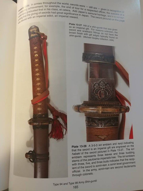

Thanks Peter.,
Interesting Habaki variation for a non Japanese Officer.
Imperial Gift swords to Japanese Officers usually were marked "Onshi" on the Habaki.
See Ohmura http://ohmura-study.net/931.html
See midway down the page devoted to type 94 Gunto.
There is something intriguing about the choice of Kamon, it shows Gosankiri i.e. 3 5 3 petal formation.
The formal seal of the office of Prime Minister is currently Goshichikiri i.e. 5 7 5 petal formation.
The Gosankiri 3 5 3 was used by the Imperial Guard division of the Imperial Japanese Army, so I wonder if that is relevant.
I wonder if the gift was actually from the Emperor or one of the patriotic organisations prevalent at the time.
The certificate has me beat at the moment.
