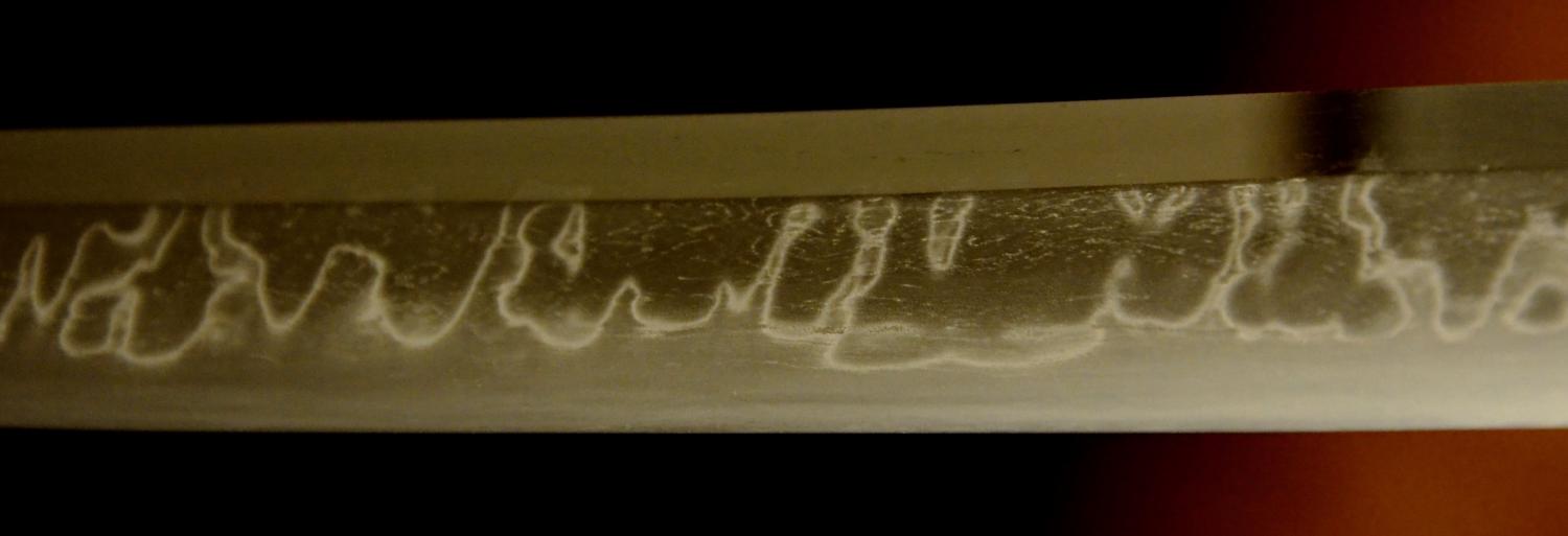

Mizuho_No_Densetsu Posted October 21, 2018 Report Posted October 21, 2018 Hi NMB, So, I don't have many local friends that are into nihonto, and I wanted to share the purchase of my third sword (the second added to my personal collection) I've been saving monthly, because I really would like to pick up a Hizen Oumi Daijo Tadahiro depending on what I can find... But during the course of budgeting and saving... I came across this curious fellow that stole my attention. I'm a big fan of Ono Yoshimitsu, and I don't know if I'll ever be able to justify owning one of his swords but the hamon on this particular blade kind of reminded me of something yoshimitsu/ichimonji-ish... Anway, the blade is mumei, muromachi jidai from bungotakada and it recently passed shinsa for Hozon Touken (should get the paperwork in a couple months). Anyway, I just thought I'd share with everyone! I think I got a decent deal on it considering it made Hozon Touken, but I'm looking forward to getting my sword account back up to where it was so that I can eventually grab an oumi daijo when I'm ready! Cheers! -Mario 1 Quote

Greg F Posted October 21, 2018 Report Posted October 21, 2018 Nice one Mario, it does remind me of the ichimonji/yoshimitsu style hamon where the hamon is produced without use of clay. I wonder if it was made this way, opinions? Greg Quote
Mizuho_No_Densetsu Posted October 22, 2018 Author Report Posted October 22, 2018 Nice one Mario, it does remind me of the ichimonji/yoshimitsu style hamon where the hamon is produced without use of clay. I wonder if it was made this way, opinions? Greg Mmmm I'm not sure, but based on what I was told it's supposedly hitatsurayaki... Which would have used clay, I think? My iphone really didn't do this justice so I'm going to try and get a few better pictures! -Mario 1 Quote

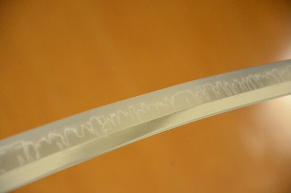

Mizuho_No_Densetsu Posted October 22, 2018 Author Report Posted October 22, 2018 Here are a couple clearer pictures...lol Kind of... And one more... -Mario 2 Quote
Jussi Ekholm Posted October 22, 2018 Report Posted October 22, 2018 Pretty wild hitatsura, I wouldn't have guessed Bungo Takada. Flashy one for sure, I like it too. 1 Quote
Blazeaglory Posted October 24, 2018 Report Posted October 24, 2018 Nice one Mario, it does remind me of the ichimonji/yoshimitsu style hamon where the hamon is produced without use of clay. I wonder if it was made this way, opinions? Greg Maybe enhanced? If not enhanced, that line on the hamon (nijuba maybe?) Looks awesome Quote
Mizuho_No_Densetsu Posted October 25, 2018 Author Report Posted October 25, 2018 Maybe enhanced? If not enhanced, that line on the hamon (nijuba maybe?) Looks awesome Yeah it's possible either way I might think... I'm not totally familiar with any type of enhancing process that might cause that but I'd be very interested in learning about it. I did some very brief research on different hataraki, and I see examples of a few different things here... I'm also no expert LOL! Thanks for taking a look Dwain! You've helped me progress in my research on this! -Mario - 1 Quote
Greg F Posted October 25, 2018 Report Posted October 25, 2018 To me it looks a little like they've used acid on the hamon bug could be the pics maybe. Others will know more. Greg Quote
Blazeaglory Posted October 25, 2018 Report Posted October 25, 2018 Yah seems really bright. I don't know if enhancing with acid is necessarily a bad thing as it brings out the hamon very brightly like that but it could just be a very well made sword with a really good polish. I'm sure the pros could say more. Either way I think it looks great! Quote
Brian Posted October 25, 2018 Report Posted October 25, 2018 Enhancing with acid is waaay near the top of the "NEVER do to a Japanese sword" list.Been covered many times. Do NOT do it.And yes,I think this one was. Or ferric chloride..same result. Reason lots of people didn't comment. It is a terrible look. But a nice sword. Hopefully oneday someone takes it back a bit to a natural look. 2 Quote

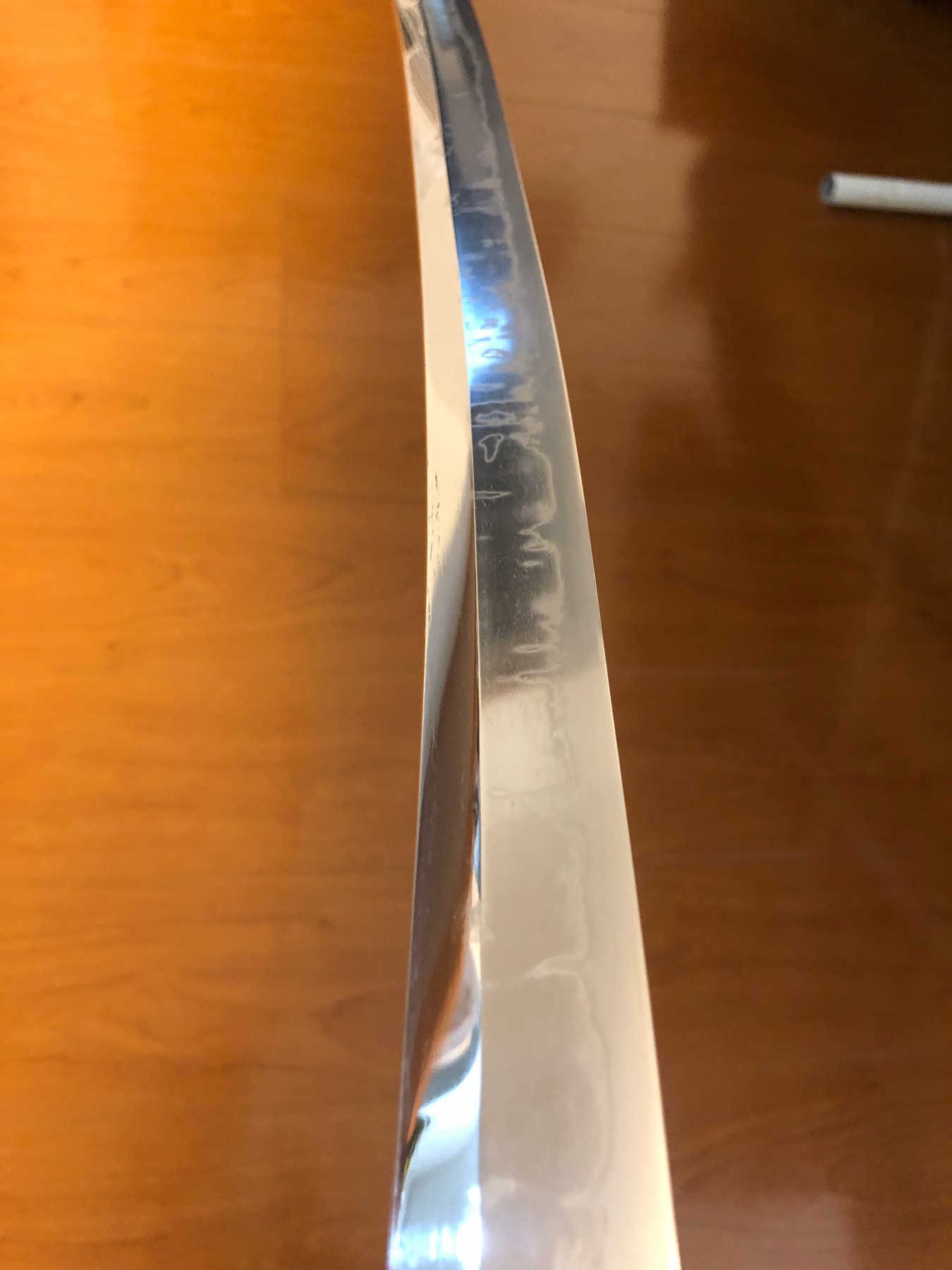

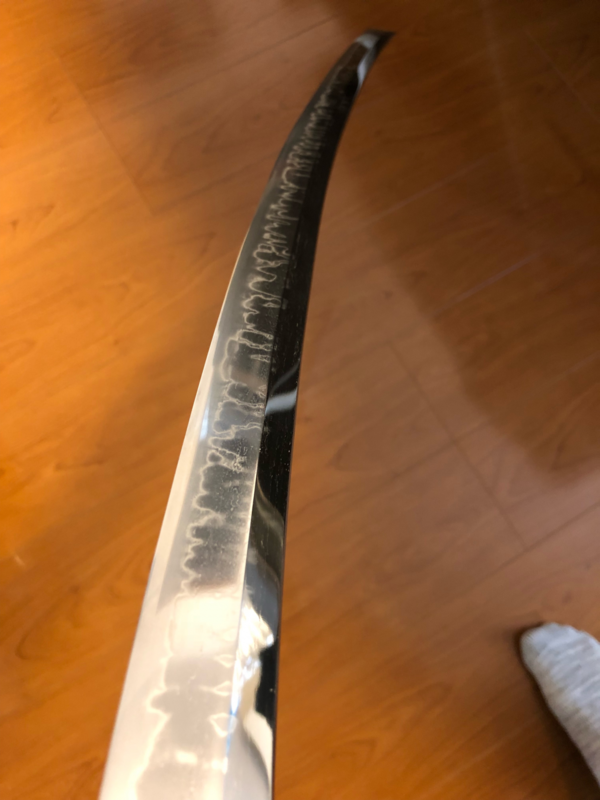

Mizuho_No_Densetsu Posted October 25, 2018 Author Report Posted October 25, 2018 This is all good to know! When I find time for a quick flight, I think I'll contact some people and get some additional insight on that, maybe a quote on polish as well! I had no idea Acid was even a thing... The hamon is a little bit bright, lol but now I'm just a bit worried that the photos I uploaded may be misleading because of the contrast presets after the import from my camera... I don't mean to beat a dead horse, lol but if anyone wouldn't mind giving me a comment or two with a less "enhanced" photo import I'd appreciate it! This is all really great information! Thanks everyone! Acid or no Acid I'm still pretty stoked! hahaha Will post pics in a bit, and would appreciate any opinions people are willing to share! Thanks! -Mario Quote

Greg F Posted October 25, 2018 Report Posted October 25, 2018 The more I look at it the more im convinced its been acid use on this blade. A shame indeed as it is a nice blade but would look much better with out it. Kinda like a lot of beautiful actresses that get plastic surgery and over do it. I hope you are able to get it corrected by a Japanese trained polisherand we get to see it in its full glory. Greg Quote
Mizuho_No_Densetsu Posted October 25, 2018 Author Report Posted October 25, 2018 So here is a direct data transfer jpeg from my camera... lol You'll notice that there is still a glow, but the contrast is pretty different. I'm going back to talk to the seller this weekend regardless lol...If anyone knows whether the authenticity of hamon plays into shinsa please please please let me know (if you can) preferably before I engage in any belligerence at the shop Saturday morning 11AM JST... lol Quote

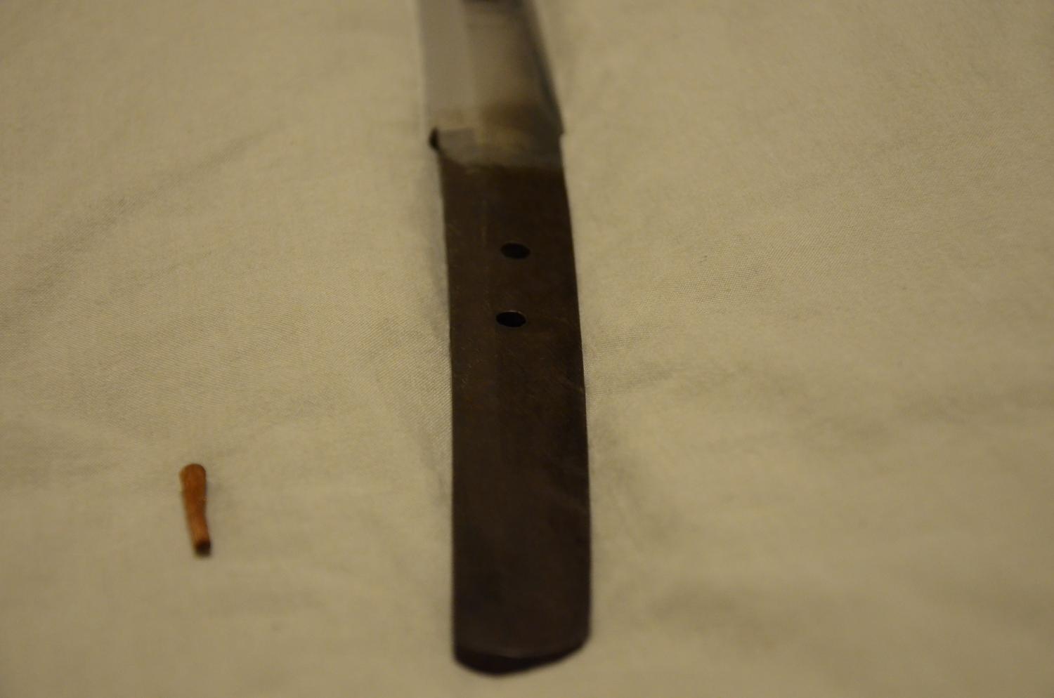

PNSSHOGUN Posted October 25, 2018 Report Posted October 25, 2018 Do you have photos of the Nakago as well? Quote
Mizuho_No_Densetsu Posted October 25, 2018 Author Report Posted October 25, 2018 Do you have photos of the Nakago as well? I can take some now! Quote
Mizuho_No_Densetsu Posted October 25, 2018 Author Report Posted October 25, 2018 ... lol Is there something out of the ordinary here as well? -Mario Quote
Brian Posted October 25, 2018 Report Posted October 25, 2018 Mario,There is no doubt about the authenticity of your hamon. The acid has just made it very prominent. But it is real and depicts what is there. A better polish would make it look more natural, but you didn't get conned. It is just that we all prefer a more subdued and correct polish. I think a shinsa may comment on it, but would probably still pass it. Hoping for someone to clarify that.Still a nice sword and as long as you keep it oiled a bit, will continue to be so. 5 Quote
DavidF Posted October 25, 2018 Report Posted October 25, 2018 Mario, Your blade has all the tell-tale signs of an authentic blade, even if (as already pointed out) acid was used to "enhance" the hamon. While a pretty crappy thing to do to a blade, acid etching is not the worst thing that could happen to a blade. At least, the nakago appears prima facie unaltered. If you take care of the blade, this is certainly a piece that you can appreciate and enjoy for years to come. Quote
