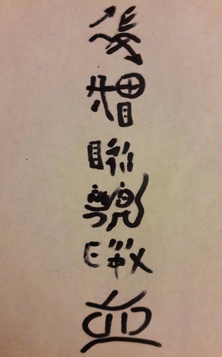

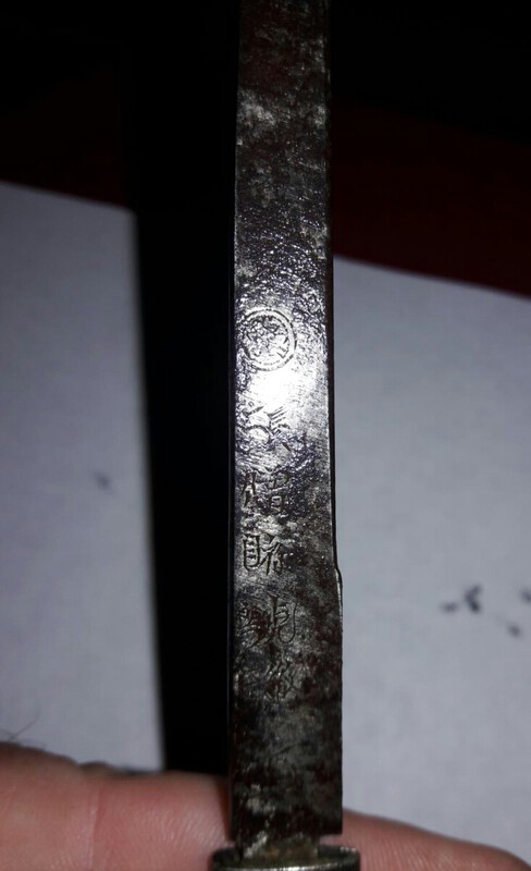

Blazeaglory Posted October 17, 2018 Report Posted October 17, 2018 Ok I know I butchered this but first try. Looks like a Tokugowa (AOI?) Mon on top and rest is hard to make out. I left out the AOI and tried to reproduce what I see in person but I'm sure it's not even close. Kudos to anyone who can translate what I copied or can see in the pic through the rust. Thanks in advance D EDIT:Photos are upright in my folder but when I upload them they show sideways. If someone could fix? Quote

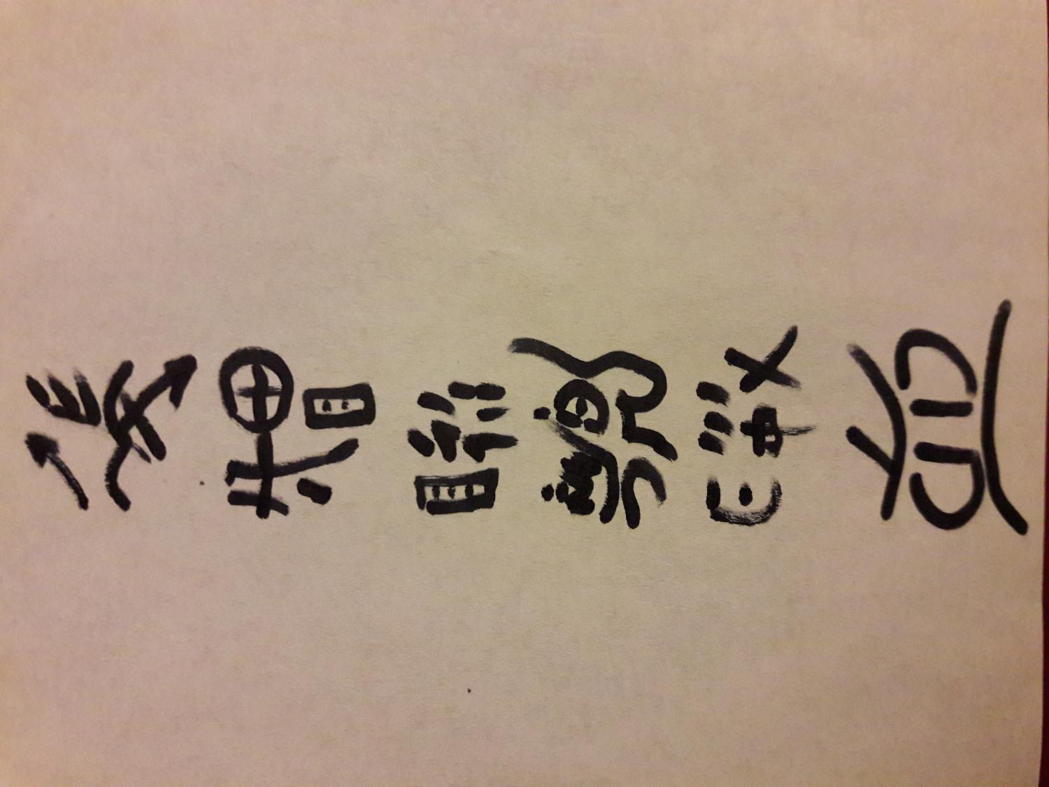

Blazeaglory Posted October 17, 2018 Author Report Posted October 17, 2018 On 10/17/2018 at 3:18 PM, TETSUGENDO said: 2018-10-17%20110728.jpg There you go. Thanks. No matter what I did I couldn't get them upright. Other photos are posting fine. 1 Quote
Blazeaglory Posted October 18, 2018 Author Report Posted October 18, 2018 Did I really translate that bad? Lol I understand that kogatana Mei are a debatable subject but this one came with an unusual Koshirae, plus it has the hollyhock. Really I'm just hoping it has an area or school in the sig Thanks Quote
Surfson Posted October 19, 2018 Report Posted October 19, 2018 I am guessing a poor attempt at nagasone okisato kotetsu 1 Quote

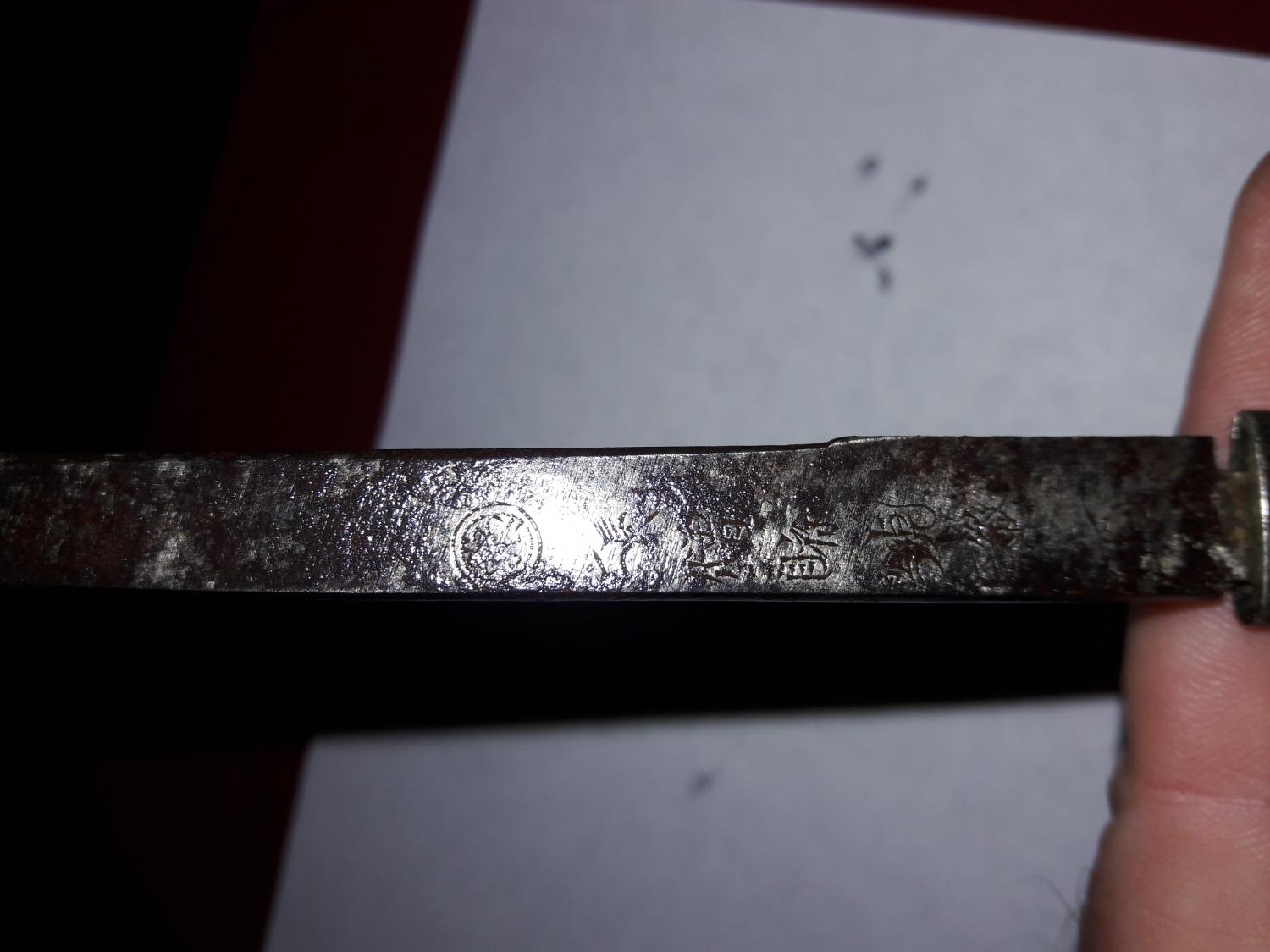

Blazeaglory Posted October 19, 2018 Author Report Posted October 19, 2018 On 10/19/2018 at 3:47 AM, Surfson said: I am guessing a poor attempt at nagasone okisato kotetsuThanks ill check it out but from what I read so far the characters don't look the same Also, I don't know if you or anyone else clicked on photo as It's much clearer and can zoom in, although from here it looks like it's impossible to read. The blade is surprisingly well made and the rust is only surface I'm finding out and is slowly coming off to reveal some clean metal! Quote
mywei Posted October 19, 2018 Report Posted October 19, 2018 I think Robert is correct 長曽祢虎徹 Nagasone Kotetsu (some characters appear to be in older forms) 1 Quote
Blazeaglory Posted October 19, 2018 Author Report Posted October 19, 2018 On 10/19/2018 at 6:41 AM, mywei said: I think Robert is correct 長曽祢虎徹 Nagasone Kotetsu (some characters appear to be in older forms) Ahh I see. Thank you! That would be pretty amazing if it was actually forged by him. Quote

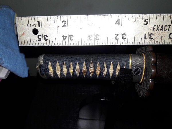

Blazeaglory Posted October 19, 2018 Author Report Posted October 19, 2018 On 10/19/2018 at 3:10 PM, ROKUJURO said: Yes, indeed! But chances are better that you win the National lottery the next three times in a row.... Haha, Yah you're probably right although the Koshirae this is a part of has some quality pieces The fittings are all solid gold and silver, as well as a silver Kozuka for this kogatana. Quote
Brian Posted October 20, 2018 Report Posted October 20, 2018 On 10/19/2018 at 7:26 PM, Blazeaglory said: The fittings are all solid gold and silver, as well as a silver Kozuka for this kogatana. I seriously doubt that? 1 Quote
Greg F Posted October 20, 2018 Report Posted October 20, 2018 I also doubt that they are solid gold but either way pics would be good. Greg Quote

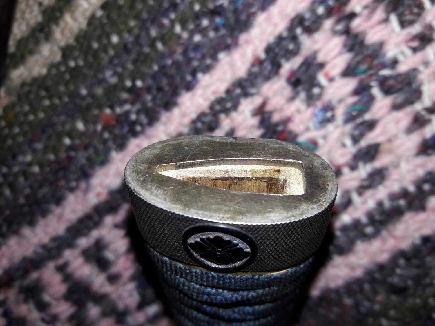

Blazeaglory Posted October 20, 2018 Author Report Posted October 20, 2018 On 10/20/2018 at 7:29 AM, Brian said: I seriously doubt that? The menuki tested for at least 22kt. Also, when I say silver, I mean possibly Shibuichi but it looks fairly high in silver content . If you look in pic you can see where the blade meets the fitting, there is scraping down into the "meat" of the Kozuka. Total length with blade is 8.5 inches lol Second pic of the fuchi looks much better in person and is aging like silver. Im not trying to brag or boast, just trying to share info. They are in the "1st Tanto" thread in Nihonto if you want to take a look. Ill send you pics of testing via PM and you can make up your own mind. Quote

Surfson Posted October 20, 2018 Report Posted October 20, 2018 The fuchi looks to be solid silver to my eye. The nanako is also very good on it. 2 Quote

Brian Posted October 21, 2018 Report Posted October 21, 2018 Solid gold was beyond rare, and seldom used. Sometimes by the Goto school etc, but far more likely to have gold foil over base metal.Not to say they aren't, but when you see gold, you assume foil and not solid. Still, the menuki are possible. Fuchi/kashira would be rare to be solid silver, but again it is possible.Ford would be the one to clarify here. 1 Quote

Blazeaglory Posted October 21, 2018 Author Report Posted October 21, 2018 On 10/21/2018 at 8:00 AM, Brian said: Solid gold was beyond rare, and seldom used. Sometimes by the Goto school etc, but far more likely to have gold foil over base metal. Not to say they aren't, but when you see gold, you assume foil and not solid. Still, the menuki are possible. Fuchi/kashira would be rare to be solid silver, but again it is possible. Ford would be the one to clarify here. No foil here. They have brownish/red paint that is coming off from the exposed areas, which is where I tested from. I started at 10kt and worked up to 22kt. None of them could dissolve so it's at least 22kt. They could be hollow behind so when I say "solid" I'm referring to content of gold The f/k/k are definitely silver or at least very high in content. No green blue discoloration anywhere and they are turning black with silver patina. You must remember this is a 7.5 inch tanto with a really small tsuka. The f/k and menuki are really small. The Kozuka is quite large tho but all other fittings are pretty small so I could see a well off samurai paying to have these fittings put on with his family crest. To me it's not really odd considering what I've seen rich people from antiquity spend their money on. Take care Brian! D EDIT:Ruler in pic is closer than tsuka, so makes it look bigger. It's even smaller in person Quote
