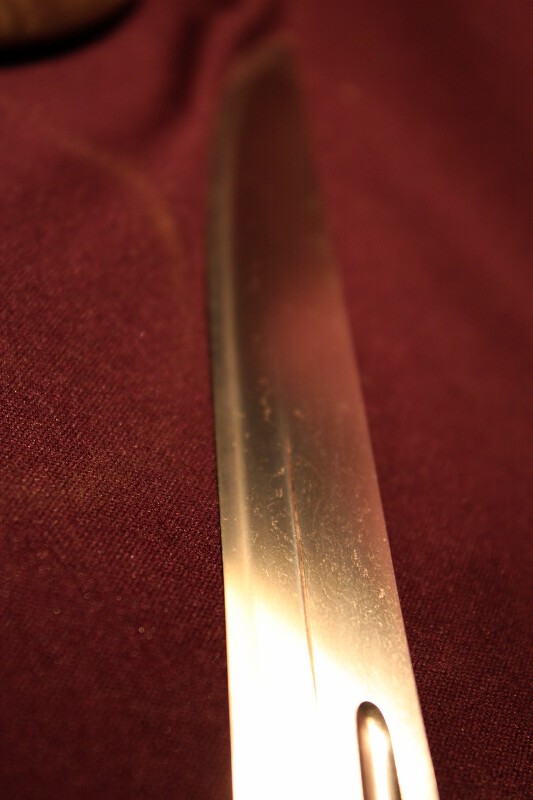

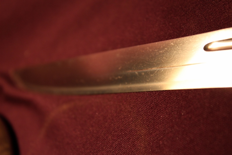

Offered for sale, a cute tanto in a shirasaya with a sword bag. This is a later copy of a Kamakura jidai tanto with the fanciful gimei signature “Rai Kuniyoshi”. Approximate measurements:
Nagasa: 22.8cm
Motohaba: 1.9cm
Motokasane: 6mm
Jihada: Itame with some itame nagare
Hamon: Suguba in nioi deki

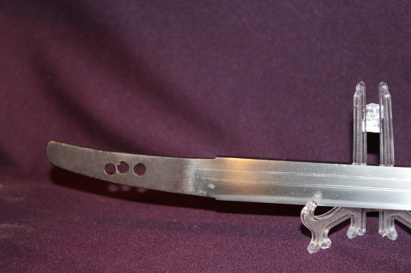

Nakago: Furisode nakago,Ubu (maybe slightly machi okuri), 3 mekugi ana, false signature.

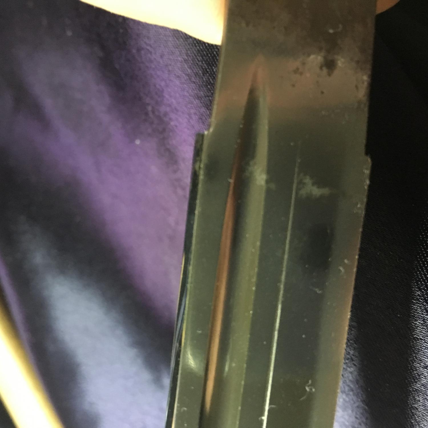

Horimono: Bo hi ni soebi on one side and something that is like gombashi on the other and for which I can’t find a name in Japanese: two lines but each comprised of two finer lines.

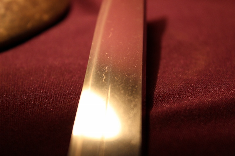

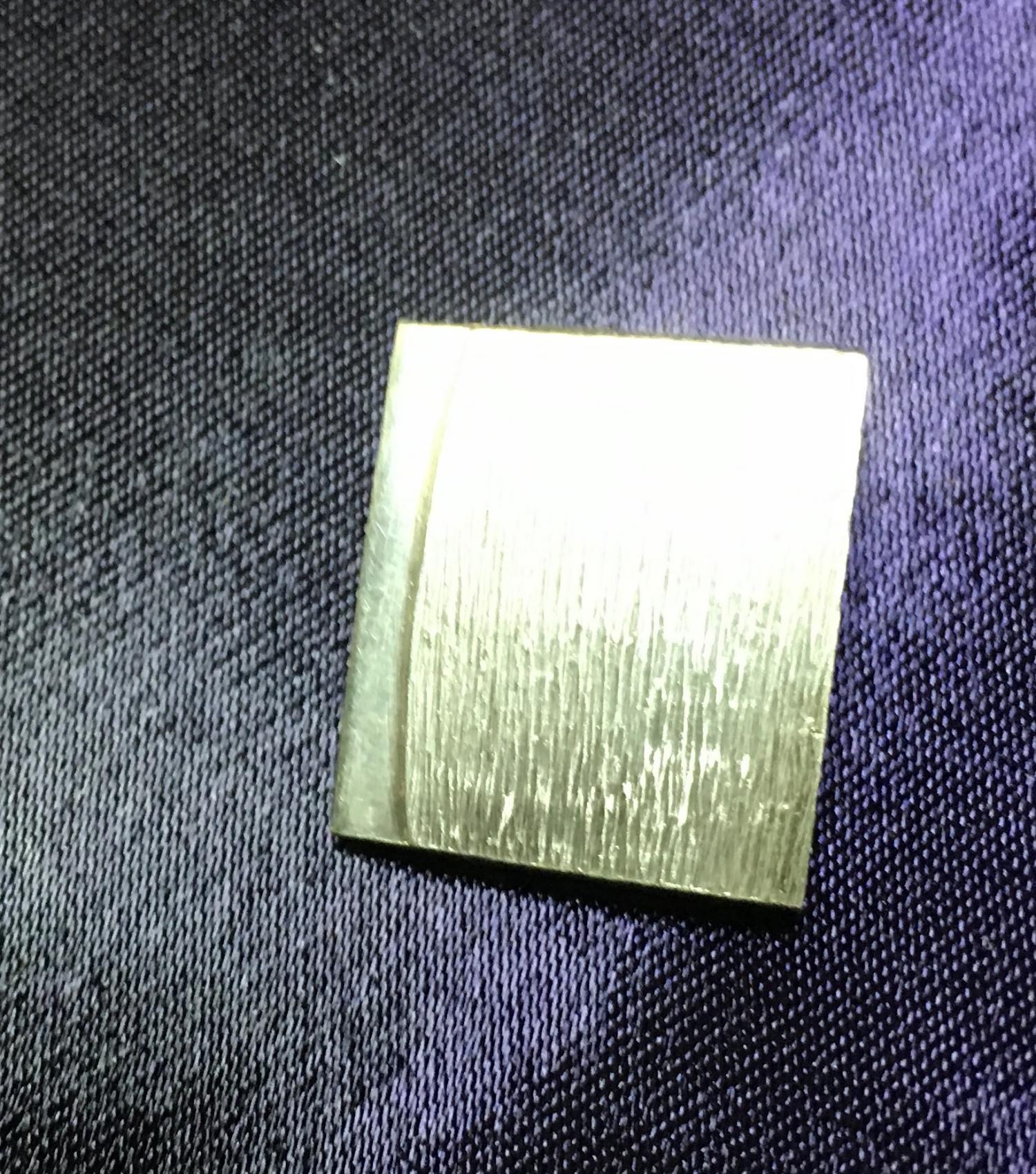

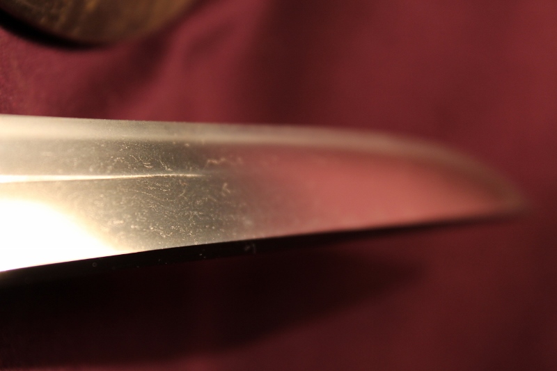

A nice, well-made tanto with no significant flaws beyond some scuff marks under the habaki and a minor scratch (pictured). Comes with a well made habaki covered with silver foil.
Priced as a good quality, mumei shinshinto tanto, asking £SOLD plus Paypal but will include worldwide shipping. Comes with the usual guarantee: if this signature proves to be genuine then I will be more than happy to take back the item and refund the sale price.  :)

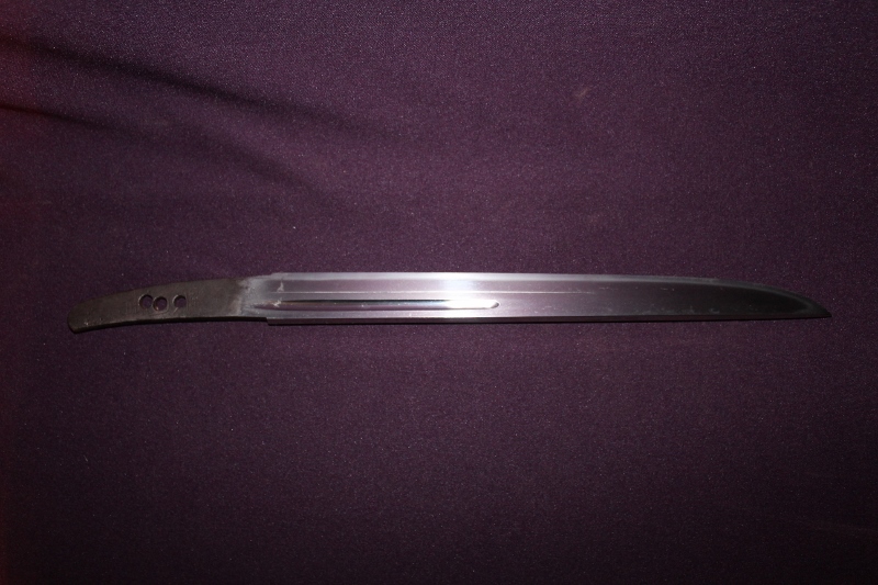

FYI: I used to own this one. Pictures do not do it justice.
This is a very nice tanto, so if you want an utsushi of a Kamakura tanto, the quality is very good and the price attractive.

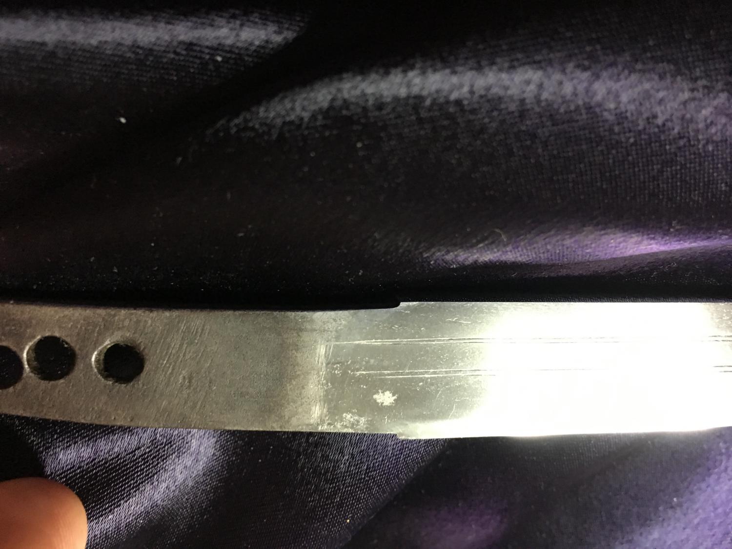

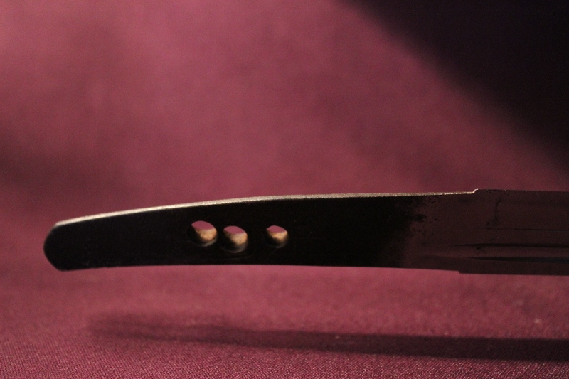

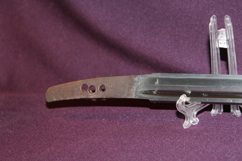

The nakago and machi area:
The patina isn't consistent with most Kamakura era blades - the colour is too light and there's much less pitting and the yasurimei are still visible, the width of the blade above the tang and that of the tang are more or less identical indicating that it hasn't had many polishes - I'd expect the tang to be wider, whoever made it or did the machi okuri didn't square off the mune machi properly - the angle is a bit off - I'd expect more care to be taken with the genuine article and there's more ha machi than I'd expect, on the real thing there is practically none left.
These things aren't necessarily conclusive, you can find exceptions, but throw in the dodgy signature - I believe there are no known extant works by this smith, and it all adds up to a newer blade. A nice newer blade though.
Very good observations!
