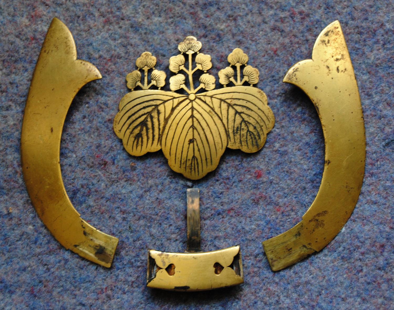

IanB Posted October 3, 2018 Report Posted October 3, 2018 Ken, What appears to be brass is more often gilded copper. I have several made in this material that I know are original - one ridiculously tiny pair of kuwagata (only about 8cm across) with a kirimon between them actually all takes apart but why you would want to do so escapes me. Wood and rawhide are also common enough, both being gold lacquered in the main. If the one you refer to is very corroded I would leave it. The gilding is inevitably porous and the corrosion products leach out onto the surface. Attempts to clean it will probably strip off the remaining gilding. Ian Bottomley 3 Quote

IanB Posted October 5, 2018 Report Posted October 5, 2018 Ken, Japan has / had an abundance of copper and until recently zinc was almost impossible to produce as the metal as it is volatile and vapourises as it is being reduced. Making brass (latten) in Europe involved adding a zinc ore to copper so that the zinc dissolved in the copper as it was reduced from the ore. Prof. Gowland in the 19th century did a great deal of analysis of Japanese alloys and mentions 'brass' only briefly - once as metal for coinage, a vase and as sentoku which is a copper, tin, lead, zinc alloy. Ian Bottomley 2 Quote

Bugyotsuji Posted October 11, 2018 Report Posted October 11, 2018 O-yoroi. Originally those thin kuwagata maedate would surely have shone on the battlefield. Patina on Shinchu though, is a strong indicator of age and can show original impurities which would not exist in modern brass replicas. For this reason I would be inclined to confine myself to giving a gentle buff to remove some of the active loose corrosion. Kabuto are heavy enough on their own, so a thick brass Maedate would make no sense. I have a circular shinchu Kuyomon 'Maedate' which is really too thick and heavy and must have been adapted from something else. Fine for a display stand though. Gilded or gold-lacquered wood or leather as Ian says above would have done the job just as well at a fraction of the weight. I have just gently waxed and polished a Noshi Maedate to remove trace physical dirt and to uncover some of the natural gold shine embedded in the lacquer. Quote
