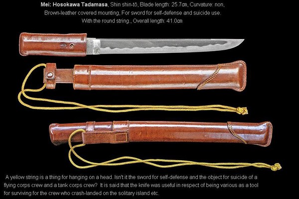

Ontario_Archaeology Posted February 26, 2019 Author Report Posted February 26, 2019 The mass amount of variation in the mounts and how un-uniform the gunto were make me think almost anything is possible. Here is the Ohmura page on the navy "crew" gunto http://ohmura-study.net/762.html Quote

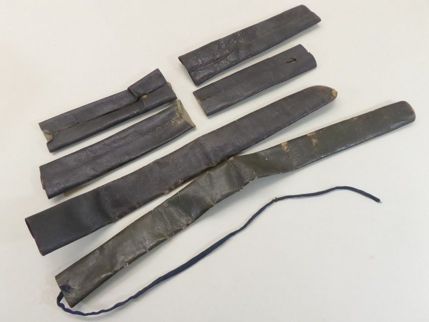

Dave R Posted March 2, 2019 Report Posted March 2, 2019 With what is now known about so called Tanker or Crew mounts nowadays, I think the terms are less an accurate description of use, and more a handy shorthand for a smaller blade in field mounts. Dealers of course love the term, along with "ancestral blade" as they are good selling descriptions adding value to what are otherwise just decent enough blades refurbished for the war effort. What I find very interesting are the markedly short blades, tanto length or only a bit longer in all leather covered mounts that turn up from time to time. 3 Quote
Bruce Pennington Posted March 2, 2019 Report Posted March 2, 2019 On 3/2/2019 at 12:11 PM, Dave R said: What I find very interesting are the markedly short blades, tanto length or only a bit longer in all leather covered mounts that turn up from time to time. Do I recall that there were a rare few leather covered saya in the "old" days, but not the norm? Regardless, the leather on the tanto you mention is obviously new, as in WWII, though, which was a norm for refitting blades for the war. Seems like I saw a photo recently of a trooper with a leather covered tanto slung on his gear. Quote

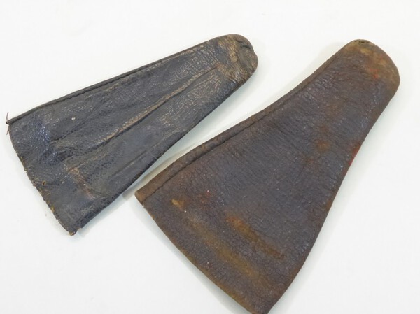

Dave R Posted March 2, 2019 Report Posted March 2, 2019 Generally Edo era leather covered saya and tsuka were lacquered to waterproof them, which includes the Same if it was meant for rough use in the field. Traditional Japanese leather was oil tanned, like buckskin, which meant that it turned into a wash-leather when soaked through. The removable foul weather covers were given the same treatment. They turn up from time to time on Ebay, and I have bought a few of them when they were cheap enough.. These pictures are of items actually in my collection bought from Ebay. 2 Quote
Bruce Pennington Posted March 2, 2019 Report Posted March 2, 2019 Wow! Those leather items are hundreds of years old!?! A testament to the treatment products. Quote
