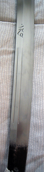

jblack Posted June 4, 2008 Report Posted June 4, 2008 Hi all, Yet another question. I have a katana signed Soshu Ju Yasuharu Saku with a Bonji carved on the ura and Shin no Kurikara on the omote. I have been searching for the defination/specific meaning of the bonji, but the only place I have see it is: Masamune, A Genius Swordsmith and His Lineage By: Sano Art Museum, 2002 on the following pages - 84,85; 85,86; 88,89; 90,91. Is it defined on any of the pages (Japanese text) or does someone know? Many thanks, Jeff Quote
Brian Posted June 4, 2008 Report Posted June 4, 2008 http://www.nihontokanjipages.com/bonji.html There seem to be a few possible ones there? Haven't got time to check them all out, will try a bit later. Brian Quote
Jacques Posted June 4, 2008 Report Posted June 4, 2008 Hi, Seems to be Reveal hidden contents Bato Kwannon (protector of the horse an peasant) Quote
Nobody Posted June 4, 2008 Report Posted June 4, 2008 My guess is; Reveal hidden contents ä¸å‹•明王 – Fudô Myô-ô http://en.wikipedia.org/wiki/Acala Quote
Jacques Posted June 4, 2008 Report Posted June 4, 2008 Hi, I think you are right Moryama san, i've forgotten a stroke Quote
Brian Posted June 4, 2008 Report Posted June 4, 2008 I also came to the conclusion that it was Fudô Brian Quote
jblack Posted June 4, 2008 Author Report Posted June 4, 2008 Thanks folks! I started with the Nihonto Kanji Pages, but had trouble with the script like characters. Something else to work on. ä¸å‹•明王 – Fudô Myô-ô it is then. Thanks again. Cheers, Jeff Quote
