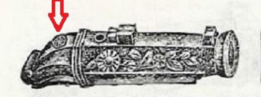

JPGH Posted September 9, 2018 Report Posted September 9, 2018 Hello everyone, Over the past couple of weeks I've been striving to research the history of a small 3-1/2 inch bronze "hand-cannon" found illustrated at the upper left-hand corner on page 61 of Francis Bannerman 1907 Military Goods catalog, but to no avail. Below is the illustration: In my research, all I've been able to find on the above are 20th century reproductions made in brass stating that it's a Chinese hand-cannon. Sadly, some auction houses and internet auctions are offering/selling these crude 20th century reproductions as "original period" hand-cannon. Below are a couple of images of the reproduction and a 1981 Dixie Gun Works catalog entry showing they are reproducing these "Chinese hand-cannon" and selling them at $5 USD each: My question(s) on another thread (http://www.militaria.co.za/nmb/topic/21648-pistols-avaiable-in-new-york-in-1907/) was/is.... can someone here please shed some light on this weapon? and member Piers D wrote: "Jo, it is a Japanese Kayaku-dameshi powder tester. 火薬試し Ignore the original description. Most of it is wrong. They are rare but not über rare. I have owned three of them. When a new batch of black powder was made up the gunsmith could test fire in the hand or nailed or strapped to a bench, judging the flash, the smoke and the report whether it looked good.By the same token as you say there are crude modern castings going around of inferior quality, so be aware! I have taken two or three of them in hand. A good one today should not cost more than $500 US in modern dollars unless it is of particularly fine or unusual workmanship. (No idea what a modern brass copy would make, but I would not want to pay even $50 for one.)" My question(s) should have been.... can someone here please help shed some light on the actual weapon illustrated in the 1907 Bannerman's catalog? Is it Chinese or Japanese in origin? Why can't I locate other examples of this exact "hand-cannon" anywhere other than 20th century reproductions? Why are all of these internet auction and even some reputable auction houses such as Bonhams offering/selling these repros as originals: Can someone please help? Thanks in advance for your time and replies. Quote
Bugyotsuji Posted September 11, 2018 Report Posted September 11, 2018 The feeling I get from the original 1907 catalog illustration is that this object itself was made for the tourist market! The chrysanthemum was a popular symbol used post-Edo, ie in the Meiji Period. It seems to be a mini mixture of different weapons, almost a toy. Certainly there would be no use for both rear and fore sights. The description underneath is suspiciously vague... Quote
Viper6924 Posted September 11, 2018 Report Posted September 11, 2018 And this ”object” also lacks the classic fish tale at the end, which is associated with Japanese powder-testers. I agree with Piers that this looks to be something in between souvenir and expensive toy. Jan Quote
JPGH Posted September 11, 2018 Author Report Posted September 11, 2018 I thank both of you for your replies and thoughts. Please excuse me for being a bit shocked and for my ignorance. But you both think that the item in question is some sort of souvenir and/or toy? That one of, if not the most renowned arms and military goods supplier of its day (Francis Bannerman & Sons, Inc.) would offer a souvenir and/or toy for sale in its catalogs? That every other weapon offered for sale on this page..... .... in their catalog is a real and/or authentic weapon except for one? The one in which I'm researching/inquiring about? I just find this a bit hard to believe. What makes you think this? Because of its size and having sights? If I'm not mistaken, researching gunpowder testers here on this site posted by members show a number of these testers being small and having sights. Is this not correct? Has anyone here actually seen an example of this bronze hand-cannon outside of the catalog in which it was/is illustrated in? Kind regards Quote
JPGH Posted September 11, 2018 Author Report Posted September 11, 2018 I forgot to add... From research, it appears most, if not all(?) of the weapons illustrated within the catalog's page posted above were pieces purchased by Bannerman and a number of experts who went with him on a weapons collecting trip to the Orient circa, 1904-05. Quote
Viper6924 Posted September 12, 2018 Report Posted September 12, 2018 Well, this might be a case of ”one bad seed...” After a quick glance on the page you added, I can say that most of the weapons depicted, looks to be genuine (the multi-barrel matchlock in the top right corner, might be a bit suspect ) and demonstrate many different styles and schools. Even in the finest collections there are fakes. I have yet to find an auction-house in the world, which has not sold an object of suspicious origin. Also, this ”hand-cannon” is completely unpractical. It’s not even 9cm in total length. The reason for two sights, can only be decorative. I myself got one of those genuine Japanese powder-tester, and I’ve handled a few more. Mine only got a small front-sight, which of course is a purely decorative feature. I don’t think I can add so much more to this topic. Let’s call this a decorative artifact within the field of antique firearms. Jan Quote
Bugyotsuji Posted September 12, 2018 Report Posted September 12, 2018 Read their description again carefully. It is phrased in exaggerated terms with nothing precise. They admit that no-one they showed it to could shed any light on it, and they cannot even remember where they bought it. I am guessing it was quite possibly cast by the same process as genuine old testers but extra features and decorations were added to it for attractiveness and appeal in the contemporary market place, as with many Netsuke and other artefacts of the time. My gut feeling is that one of their dealers got sold this at too high a price, so they whipped up some fluff in order to move it off their books. PS The first line is making out that it is some ancient hand gonne, a single-shot Chinese gun from the beginnings of powder weapons, which it most definitely is not. Quote
JPGH Posted September 13, 2018 Author Report Posted September 13, 2018 "Let’s call this a decorative artifact within the field of antique firearms" My apologizes, but I don't believe this is something a can accept at the moment without evidence. I mean..... I respect your opinion and appreciate your replies and thoughts, but I'm not ready to throw in the towel just yet and toss this item up as a mere decorative tourist item/toy. If the item is just that (decorative tourist item/toy) where are they? If this item was made for the tourist market, why can't any be found for sale or have sold anywhere? Was there only one made and then sold to Bannerman's group in search of rare weapons in that era? Highly unlikely. Where are these other decorative tourist items/toys? Quote
Viper6924 Posted September 13, 2018 Report Posted September 13, 2018 I think I managed to cover all bases by calling it a ”decorative artifact” To me that elevates it from toy to something, well I just don’t know. One thing I’m pretty sure of; this is not a gun. As it doesn’t look like a genuine Japanese powder-tester, I guess it’s anyone’s guess to what it is. Jan Quote

Bugyotsuji Posted September 13, 2018 Report Posted September 13, 2018 Looking again at the catalog gun again it is quite different from the photograph Chinese 'repro' you posted. I was kind of assuming they were the same. Compare the bores for a start. Although I strongly disagree with the inferences in the Bannerman catalog, the narrowness of the bore and the thickness of the barrel walls do suggest the 'original' could have been a later Meiji period powder tester. Were some perhaps elderly gunsmiths still using crude traditional ways of measuring gunpowder mixtures? Assuming that Banneman staff bought it in Japan on their travels (but later forgot even which country they found it in), then a Meiji period chrysanthemum-decorated Kayaku-dameshi powder tester might indeed be possible. In such a scenario I would would be willing to retract my earlier suggestion of 'toy'! A feeling still remains that just as Hinawa-Ju continued to made in the Meiji Period, a swansong from gunsmiths who yearned for the good old days or had been unable to adapt, or needed to record their skills for posterity, there was no real market for them outside of the curios and tourist and perhaps unsuspecting collector market. Quote

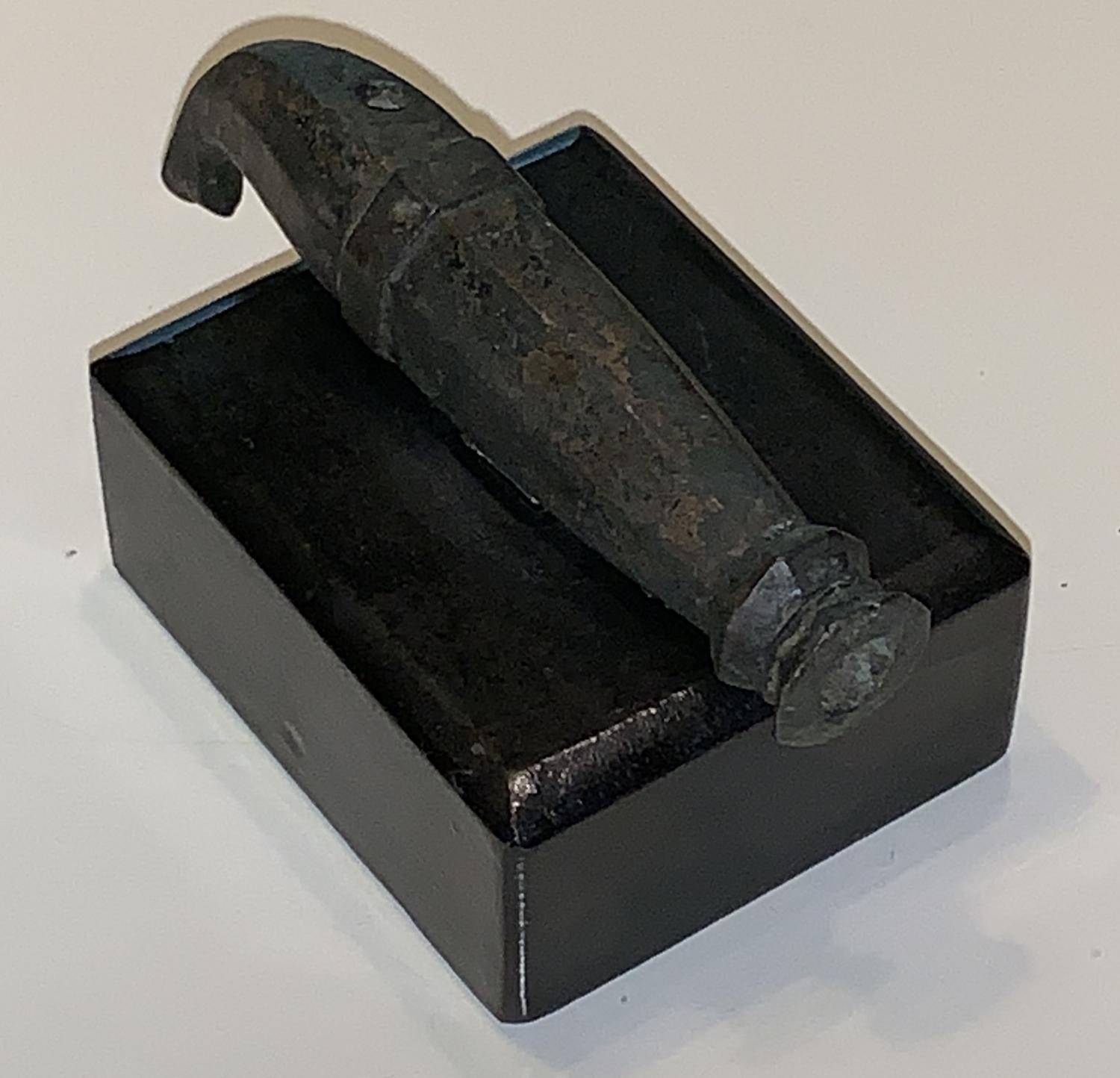

JPGH Posted September 18, 2018 Author Report Posted September 18, 2018 After some consideration, I decided to post images. As you can see, the piece is quite different in refinement compared to the 20th C. brass reproduction that as been selling on the market for years as the original. The touch-hole is very small compared to Piers & Jan's powder testers, but mirrors this "stippling" effect at sides that's found on Piers's 'miniature cannon' with wooden base seen in my last post above. It's 3-1/2 inches in size, weighs nearly 1/2 lbs. and is marked near the base ring with an unidentified hand-incised maker's(?) mark. Your thoughts, if any? Quote
JPGH Posted September 18, 2018 Author Report Posted September 18, 2018 Piers, Jan, Ian, Ron, etc. Your thoughts on the above? Quote
Viper6924 Posted September 19, 2018 Report Posted September 19, 2018 Well, being far from an expert on these miniature guns/testers/artifacts, my first impression is that the touch-hole looks very small. How would it be possible to ignite the main cache of black powder? The shape of the end is also interesting. Pretty sure that I never seen anything like it before. Again, the vaste majority of Japanese powder testers I’ve seen, sports a fish tale at the back. Piers got in interesting theory about that So my humble conclusion is that this can’t be a weapon and I doubt very much that it’s a Japanese powder tester. But in this game you must have an open mind... Jan Quote
Bugyotsuji Posted September 19, 2018 Report Posted September 19, 2018 Well, I think you have described it rather well. I agree with your comparative observations too. The patina on yours suggests younger rather than older, so I would stick by my sense of Meiji at the earliest, although the one you own seems to differ in several respects from the one in the catalog, so it could in fact be even later. Iam not sure what the mark behind the touchhole represents. (My little stippled cannon you posted above has a mekugi bridge loop underneath for fixing to a base; there is also a Mei underneath.) Yours seems to have crossover attributes of miniature cannon and powder tester. Good luck with your research. I hope you will keep us updated as there is still much to learn in this area. Quote
Baka Gaijin Posted September 20, 2018 Report Posted September 20, 2018 Hi JoJo., Can you please show a close up down the bore, I am curious as to the mottled effect shown in the wider shots. As to the mark behind the touch hole that Piers mentions, it does not look like a normal Kamon, perhaps an interpretation of Maru Ni Yotsume? Quote
IanB Posted September 20, 2018 Report Posted September 20, 2018 Gentlemen, Two points strike me as significant. First is that the barrel is texture / stippled on top but not below. This suggests it wasn't seen and that originally it sat in a wood 'stock' of some kind that was confined between the muzzle and breech moulding. Secondly I can see a change of patina behind the touch hole, especially on the right side. This suggests a band of some kind to hold it into a stock. Now here is a mad idea. If it did sit in a wood stock on a smooth board and was charged with a given quantity of powder, the distance it slid on firing would indicate the 'strenght' of the powder. Just a thought. Ian Bottomley. Quote

JPGH Posted September 21, 2018 Author Report Posted September 21, 2018 On 9/20/2018 at 4:59 PM, Malcolm said: Can you please show a close up down the bore, I am curious as to the mottled effect shown in the wider shots. I assume this is the image you're requesting? Quote
JPGH Posted September 21, 2018 Author Report Posted September 21, 2018 I just wanted to add a couple of close-up images for you alls viewing I thought to be interesting. The texture/stippling on each side of the barrel as well as the "maker's mark" is all hand-applied/punched. Quote
