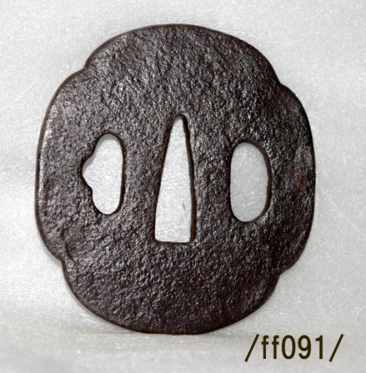

Japan2112 Posted July 25, 2020 Report Posted July 25, 2020 Great intellectual discussion and much said on the topic of Japanese aesthetics. Thank you guys. Here is one that I enjoy under spot lighting for its aesthetic quality. Owari-Kanayama (deeply dished with 8 mm mimi thickness). Best, Mark 6 Quote

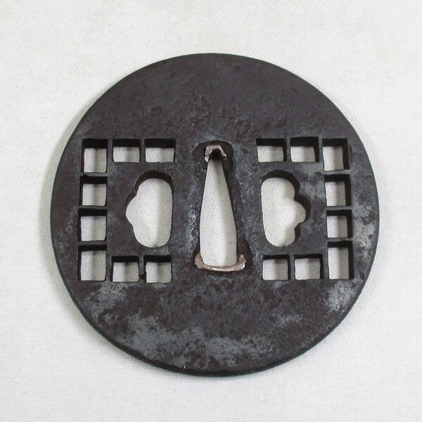

Steve Waszak Posted July 25, 2020 Report Posted July 25, 2020 Yamasaka Kichibei. Owari. Late-16th Century. Kuruma-sukashi. 5 1 Quote

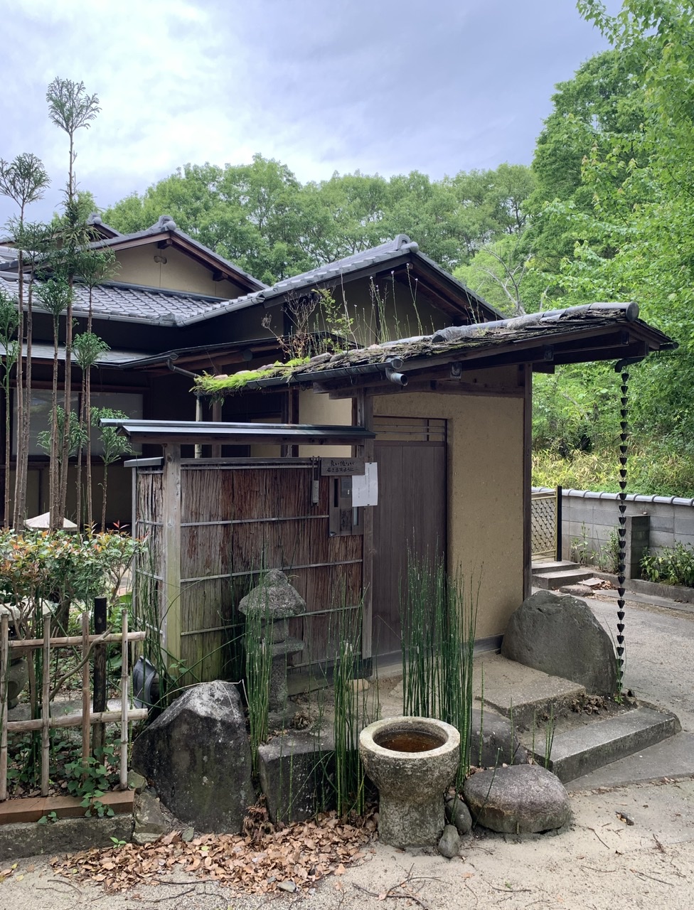

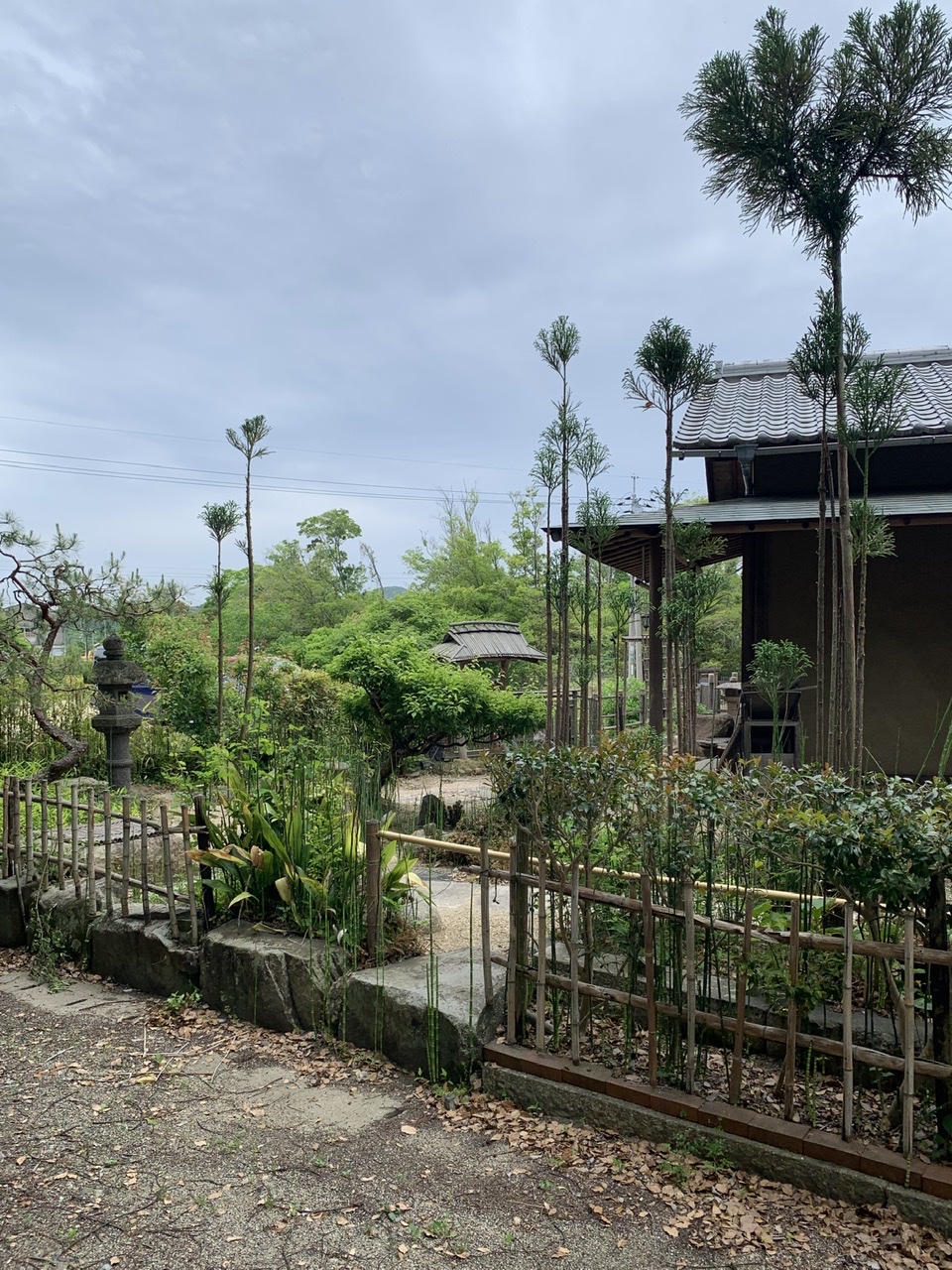

Bugyotsuji Posted July 26, 2020 Report Posted July 26, 2020 INTERMISSION Some light scenery, i.e. the Gūji’s house. 1 Quote
Babu Posted July 26, 2020 Report Posted July 26, 2020 That house and gardens IMHO epitomises Wabi Sabi. Quote

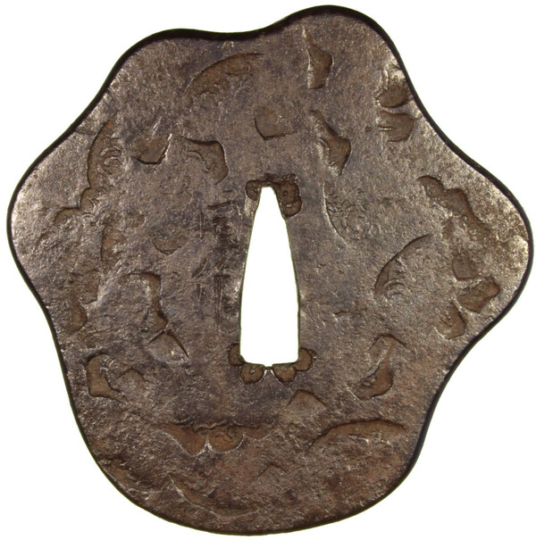

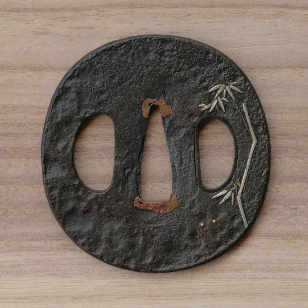

Dave R Posted July 26, 2020 Report Posted July 26, 2020 I am posting this one, simply because a much more knowledgeable friend described it as "very Wabi Sabi". I bought it in 2013, and I am posting the vendors pics because they are better than my own. Nothing very special about it in my eyes, but I like it all the same. Quote
kissakai Posted July 26, 2020 Report Posted July 26, 2020 I like Steve's and Marks examples the best Quote

vajo Posted July 26, 2020 Report Posted July 26, 2020 On 7/26/2020 at 12:33 PM, Babu said: That house and gardens IMHO epitomises Wabi Sabi. What is Wabi Sabi on the house pictures? For me it looks like a Japanese thought of shabby chic. Nothing in that pictures that let me think its wabi sabi. 1 Quote

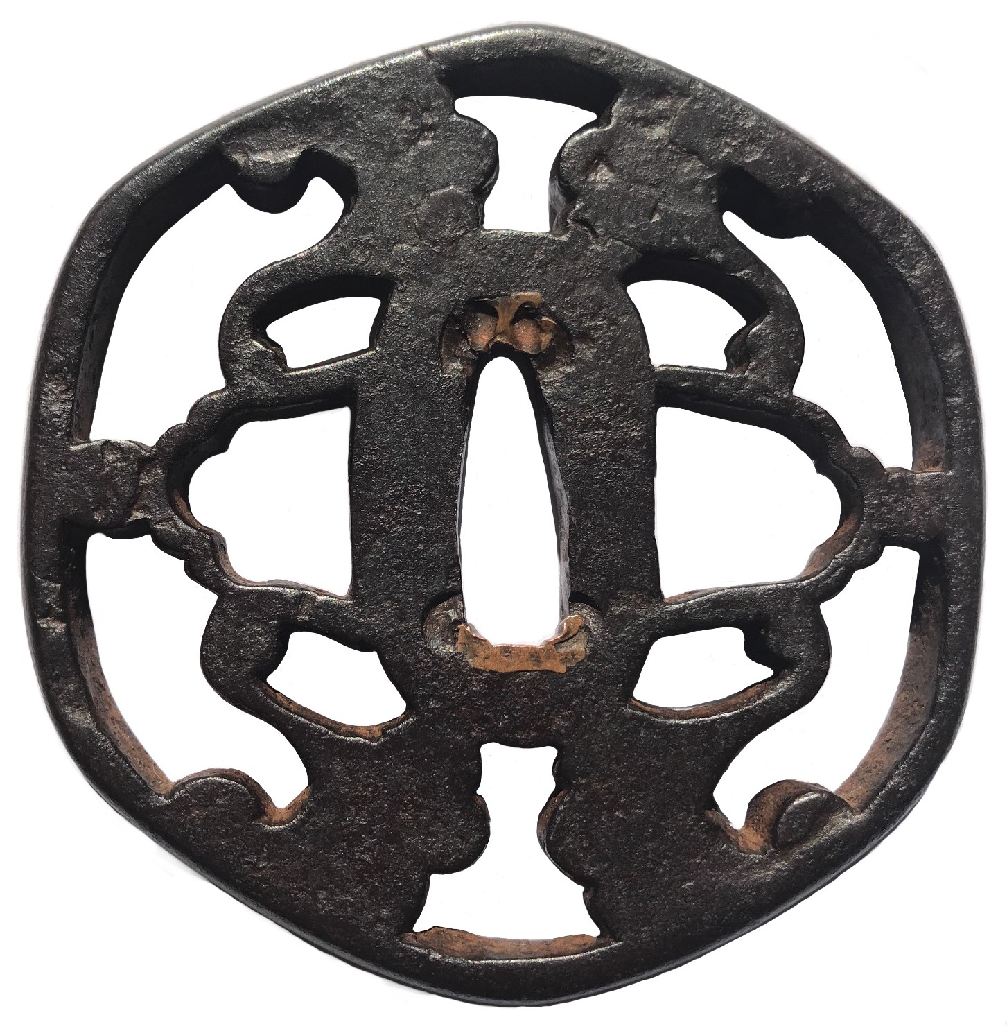

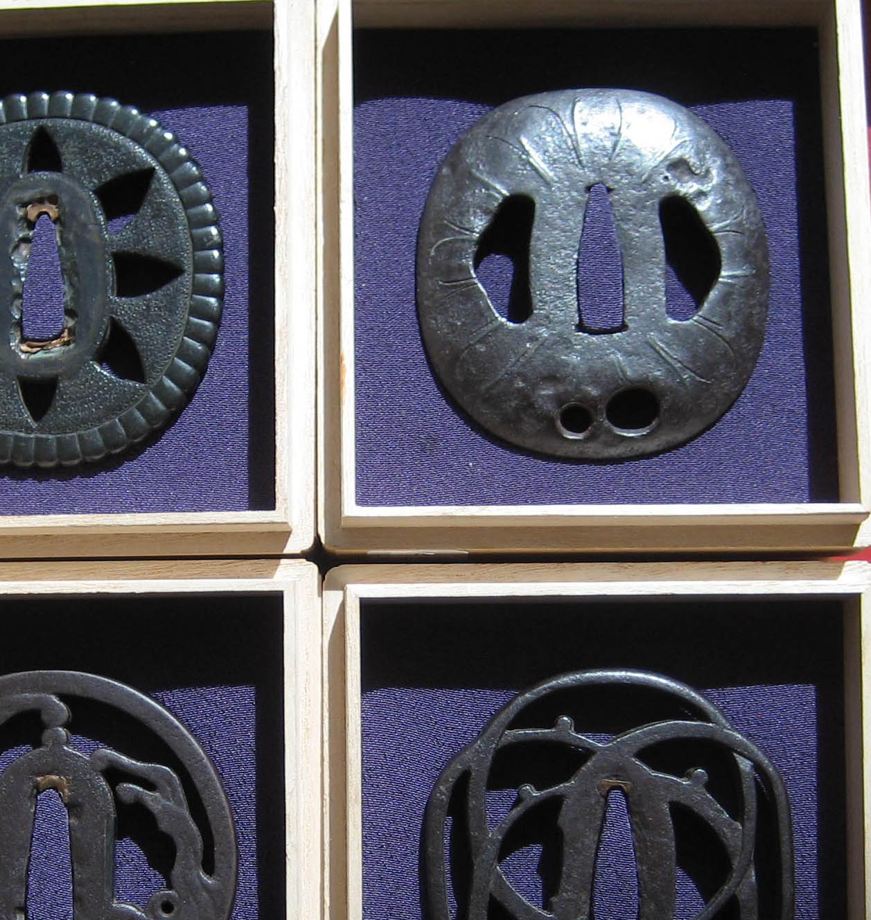

kissakai Posted July 27, 2020 Report Posted July 27, 2020 I've shown a few examples any my own personal take on this theme Happy for any comments about these tsuba and no need to hold back and it would be nice to have a lively discussion and maybe some controvesty Fire away! No 1 A good example of wabi sabi No 2 Difficult to say. Are the hammer marks contrived or a random (ish) pattern One the tsuba is struck there is no going back and as this is from a decent smith I assume he was happy with the result No 3 Being old (circa 1500) doesn’t make the a wabi sabi tsuba No 4 Has age but a ‘designed tsuba so definitely not wabi sabi No 5 Absolutely nothing to do with this subject but makes me smile and that is another story/theme 2 Quote
Babu Posted July 27, 2020 Report Posted July 27, 2020 On 7/26/2020 at 6:19 PM, vajo said: What is Wabi Sabi on the house pictures? For me it looks like a Japanese thought of shabby chic. Nothing in that pictures that let me think its wabi sabi. The old bamboo fences,and the stone features which are stained by age with subtle Grey and brown tones, reflects sabi, and the contrived rock garden wabi. Quote
Babu Posted July 27, 2020 Report Posted July 27, 2020 Here is another Ryōan-ji (late 16th century) in Kyoto, a famous example of a zen garden which was designed on the principles of Wabi Sabi. Quote

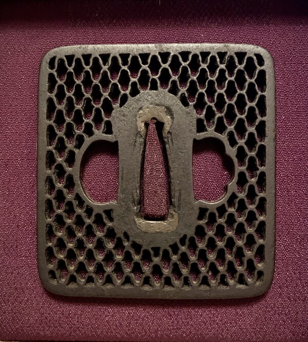

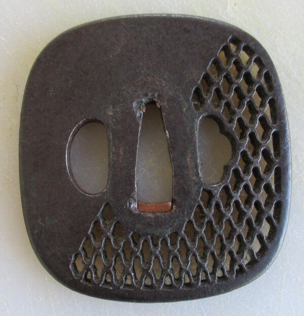

Bugyotsuji Posted July 27, 2020 Report Posted July 27, 2020 This small iron tsuba is for a Wakizashi. Alluding to a garden lattice fence, or perhaps a fishing net? Simple and rustic, yet somehow satisfying. 5 Quote

Japan2112 Posted July 27, 2020 Report Posted July 27, 2020 I like Piers' fishing net design. Hayashi design duplicated by Akasaka in the 6th generation. Not totally speaking wabi sabi to me though. The kaku gata shape is extra nice. 1 Quote

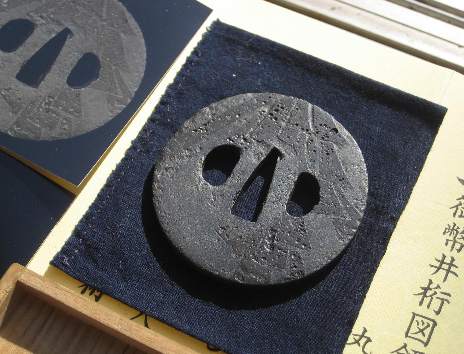

suketaka Posted July 28, 2020 Report Posted July 28, 2020 3rd Yatsushiro Jingo, TBH Paper. Much better in Hand, deep black glossy steel, impressive Tsuchime. 4 1 Quote

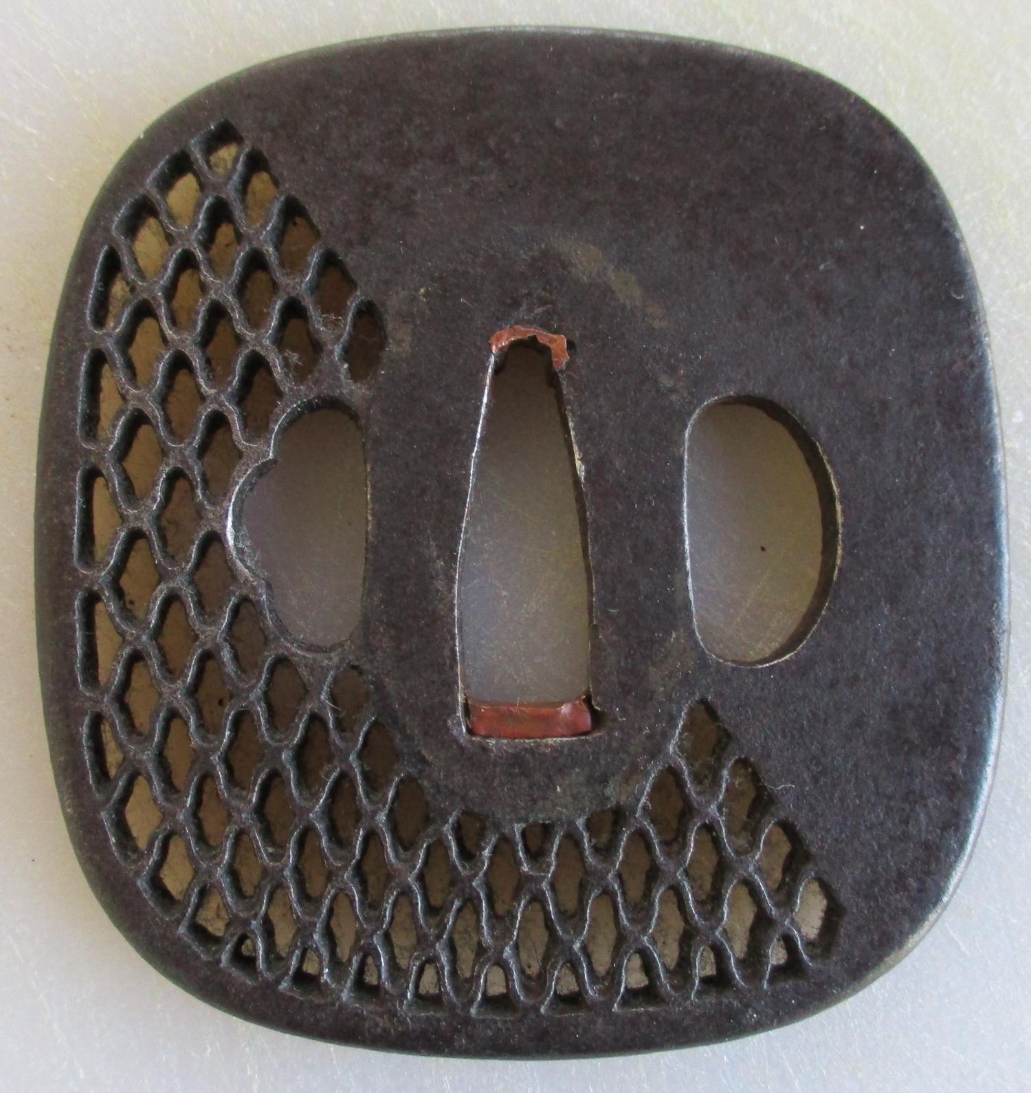

kissakai Posted July 31, 2020 Report Posted July 31, 2020 Just another net - mine has nothing to do with wabi sabi 4 Quote
