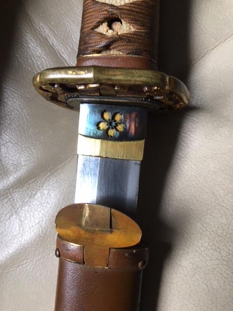

optimus Posted September 2, 2018 Report Posted September 2, 2018 Hi guys! I need some help! What do you think about this one? 2 Quote

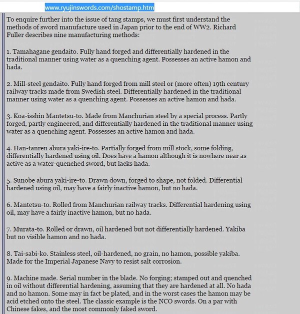

Dave R Posted September 2, 2018 Report Posted September 2, 2018 Real indeed, but not a Nihonto. It looks like it has a Seki stamp and so non traditional in some form.The list below is now a bit outdated, but still ok as a basic guide. 2 Quote
seattle1 Posted September 2, 2018 Report Posted September 2, 2018 Hello: Thank you Dave, I've never seen that laid out so clearly. Arnold F. Quote

Bruce Pennington Posted September 2, 2018 Report Posted September 2, 2018 Guys, somebody talk to me about that horrible hot-stamp in the habaki?!?! Never seen anything like it! When I saw that and the icky quality of the seppa and tsuba - I was leaning to Fake. But the mei looks good, as does the saya. What the heck is that on the habaki? Quote
Stephen Posted September 2, 2018 Report Posted September 2, 2018 Looking closer it looks like its cut into blade or am i seeing something thats not there? 1 Quote
PNSSHOGUN Posted September 3, 2018 Report Posted September 3, 2018 It's a poor rendition of this style of Habaki: 2 Quote
IJASWORDS Posted September 3, 2018 Report Posted September 3, 2018 Hey Bruce, you occasionally see things like that. This is on a latch/throat cover example of mine. Quote

optimus Posted September 3, 2018 Author Report Posted September 3, 2018 On 9/3/2018 at 2:54 AM, Stephen said: Both nice example but not same. John is boars eye...a high grade for gunto IJAswords. Wheres your name ? Yours is a famly mon. One in question needs a better look please Peter Sry, I have no more pictures. Quote
Bruce Pennington Posted September 3, 2018 Report Posted September 3, 2018 John & Neil, Thanks guys, I have never seen that on habaki before! Oh, so much to learn!!! Stephen, I thought the same thing, though, after zooming in on it, I can see the metal of the blade, and some rust on it, through the hole. So it seems the habaki is thick, or built over another layer of metal. Low quality work, imitating high quality ideas I suppose. 1 Quote
