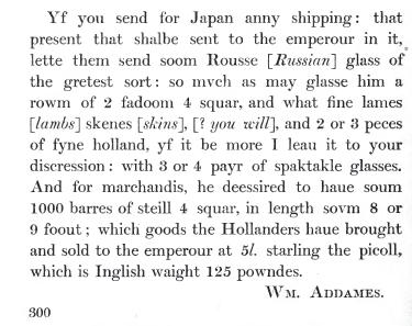

IanB Posted May 28, 2008 Report Posted May 28, 2008 The following may be of interest. It is taken from letters written by Will Adams to the East India Company. The first being sent home in the ship Cloves in 1613. In a list of trade items worth shipping from England he states: 'Stylle in long barres still holding his old prise at 20 crown the picoll, which is 125 l Inglish wayt and sometymes being coum worth 3 l 15s'. In other words long bars of steel 125 lbs sometimes fetching as as much as £3 15shillings. In another letter (undated) he describes the most suitable presents to send to give to Ieyasu and says: ' And for marchandis, he deessired to haue soum 100 barres of steill 4 squar, in length soum 8 or 9 foout; which goods the Hollanders haue brought and sold to the emperour (Ieyasu) at 5 l starling the picoll, which is Inglish waight 125 powndes'. In this case square bars of steel 8' or 9' long that the Dutch had sold for £5 sterling. Ian Bottomley Quote
Brian Posted May 28, 2008 Report Posted May 28, 2008 Yep..don't you love those English to English translations? Brian Quote
Tavroch Posted May 28, 2008 Author Report Posted May 28, 2008 Hello Ian, Thank you for the pointer to Wm Adams' letters. I've been reading those as we speak, but haven't come to the part you refer to yet. Did a search in the text for the term "steill", and shure enough there it is: on page 300 from "More Queer Things About Japan", a text from 1905, available here http://www.archive.org/details/morequeerthingsa00sladrich, for anyone who's interested. I'll bring this to the attention of the NT-project people too. If this also is new to them, I think they should start paying us for the research we're doing for them. Quote
IanB Posted May 28, 2008 Report Posted May 28, 2008 I've just done a few calculations and if Adams was right about the weight, the bars of steel he was talking about would be somewhere near 1.7cm square. We also know that the Japanese were getting steel imports in the form of 'gourd shaped' ingots as well as 'nail shaped' ingots. The former may well have been from the Portuguese base in Goa since this was not a form that the Europeans would have produced. If so it would have been wootz steel from an Indian or Central Asian source. Since the structure of this material breaks down above 750 deg. Celcius, to the Japanese it would work like any other carbon steel. Jan Piet Puype of the Legermuseum, Delft did some work on the export of sword blades by the VOC. I had done some similar work at the Royal Armouries and what seems to have been happening was that they would obtain a native sword and have copies made in Solingen. These copies would then become a desirable item of trade in that region. I found that in the RA's collection of Indian swords, some 75% had either Italian or German blades. I also bought an aiguchi for the RA collection a couple of years ago with a blade made in Solingen (with an inscription surviving in the fuller) that had been reshaped from a cavalry sword or a hanger and then re-hardened in the Japanese style to produce a yakiba. This was mounted with fittings bearing a Matsuura kamon and a saya covered with Dutch leather. I also own an armour having the front of the do covered with Dutch leather. Quite a trade Ian Bottomley Quote

Tavroch Posted May 28, 2008 Author Report Posted May 28, 2008 You're talking about some real treasures there Ian. You wouldn't happen to have some pictures of them that you are willing to share, would you? Especially of the Aiguchi. Sounds like you have a dream job. If you want I can bring you into contact with the people from the Namban Tetsu project here in Holland. Because if you want to take this any further its out of my league. And there's that Wootz again. If you can point me to some accessible articles about Wootz steel I'd be much obliged. If I understand correctly, and if it was indeed Wootz steel they were importing, the Japanese unwittingly destoyed the unique properties of the Wootz by treating it like the steel they were familiar with (i.e. Tamahagane/Orishigane)? But this is mere speculation, right? Would you care to tell us who is doing this speculating? Any references? I for one would be very interested. Don't you love it how everything seems to be linked? The Dutch, Adams, the first Shogun, iron, Nihonto and now Wootz comes up. I think I'm going to apply for an extra life, because I think I'm gonna need it. Quote

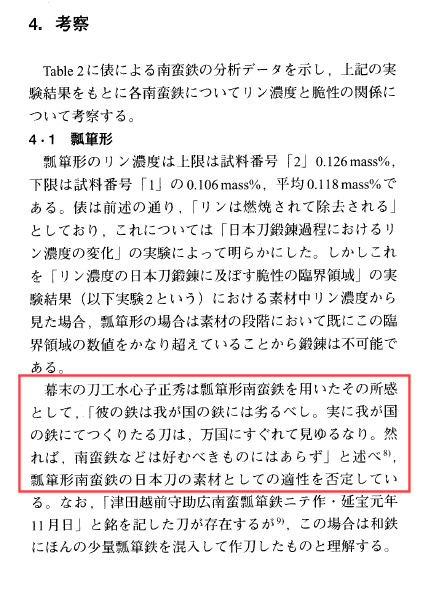

Jacques Posted May 28, 2008 Report Posted May 28, 2008 Hi, I've already posted this link, but i think it can be helpful (it seems wootz was good for forging Japanese blades). http://ci.nii.ac.jp/naid/110001457670/ Quote
Nobody Posted May 29, 2008 Report Posted May 29, 2008 Jacques D. said: I've already posted this link, but i think it can be helpful (it seems wootz was good for forging Japanese blades). http://ci.nii.ac.jp/naid/110001457670/ Thank you for the info. That seems to be an interesting paper. I found the whole text. This is the full text (Japanese) of the article. http://nels.nii.ac.jp/els/110001457670. ... 019481&cp= In general, the article says that Namban-tetsu is not good for sword making, though some types are not so bad. Quote
Carlo Giuseppe Tacchini Posted May 29, 2008 Report Posted May 29, 2008 Jacques D. said: it seems wootz was good for forging Japanese blades. Only if re-melted, becoming something else then wootz-pulad. Otherwise it definitively isn't for the reasons quoted by Ian. And still it have to be fixed *what* is intended for wootz. The word is used for all indian steel, and that's incorrect. Quote
Jacques Posted May 29, 2008 Report Posted May 29, 2008 Hi, Quote In general, the article says that Namban-tetsu is not good for sword making, though some types are not so bad. However, it was largely used and by some big smiths such Masahide. A quote of Kanzan Sato Sensei: Quote Early Period of Shinto (Early - Middle 17th C.) All swords made earlier that Keicho era (1596-1614) were classified as Koto, or Furumi (old blade), and those made since then as Shinto, alias Arami (new blade). So called because the Momoyama age (middle-late 16th c.) was a time which witnessed the disintegration of th eold order of the thigns and the rise of a new culture under the reign by military rulers who reunited Japana after a long civil war age. those military rulers were straight-forwarded men unfettered by conventionalities and gave free scope to their tastes. It was only natural that the swordsmiths who came gathered and worked in the new rising cities and towns reflected the ruler's taste in their works. That is, so long the civil war age in duration that classic art of tempering sword had been submerged by the prevailing custom of rough making sword. Another new wave of this time is the use of Nanban-tetsu (Western steel) brought from Holland and Portugal mixed Wagane (inherent Japanese steel). Although widely used by swordsmiths throughout Japan, only Yasutsugu in Echizen province clearly incised on the tang as Used in Nanban-tetsu with a pride of skillful use of Western steel, that relates the habit of their secret use of Western steel. Modern science had discovered that it is more difficult to use Nanban-tetsu to make Japanese swords compared to Wagane. Quote
Carlo Giuseppe Tacchini Posted May 29, 2008 Report Posted May 29, 2008 Jacques D. said: However, it was largely used and by some big smiths such Masahide. Again, the word wootz is improperly used for generic indian steel, there are no sources stating the nature of the different steels imported and Masahide used Nanban Tetsu that definitively doesn't mean "wootz/pulad", there is no way to know which type and how much was used. Kanzan merely talks about "Nanbantetsu" and "western steel". Let's try to not mix "Nanbantetsu" with "wootz" just to prove previous statements. Quote
Brian Posted May 29, 2008 Report Posted May 29, 2008 Yes, I think we have to clearly differentiate here between Nanban-tetsu, Wootz steel and other imported steel. That article does say that the steel that was imported from India was called Wootz steel, but I think that they would have lumped all the steel under that classification possibly, and it was likely not all Wootz but more plain steel. It seems from all the articles together that Nanban tetsu was sometimes used, and that could be both Indian Wootz...or Dutch, Portuguese etc plain steel. The Wootz was only really useable when forged further until it lost its inherent properties and became more like normal steel. Most likely these were all mixed and forged with Japanese steel to create a forged billet of useful properties. Brian Quote

Nobody Posted May 29, 2008 Report Posted May 29, 2008 Jacques D. said: Quote In general, the article says that Namban-tetsu is not good for sword making, though some types are not so bad. However, it was largely used and by some big smiths such Masahide. As for gourd shaped ingot at least, Masahide denied its applicability. In the article which you introduced, there is a description of Masahide’s words. After using gourd shaped Namban-tetsu for his sword, he said his comment. That is loosely as follows; “The iron is inferior to Japanese iron. The swords made of Japanese iron seem to be the best in the world. So, we do not have to prefer Namban-tetsu.†Quote
