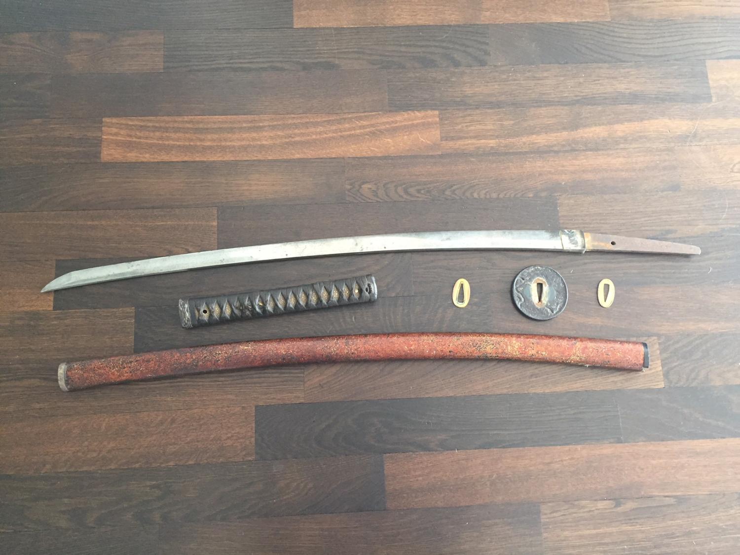

xmr Posted August 28, 2018 Report Posted August 28, 2018 Hello, my name is Alex, I'm fropm germany. My father gifted that sword to me. He got it as a present in the 60s while studying in GB. I have absolutely no idea how old it is, if it's valuable or an industrial WW2 sword etc. Before having it professionally restaurated I'd like to know what it is. Thanks for any info! I can take more pictures if needed. Thank you very much! Alex Quote

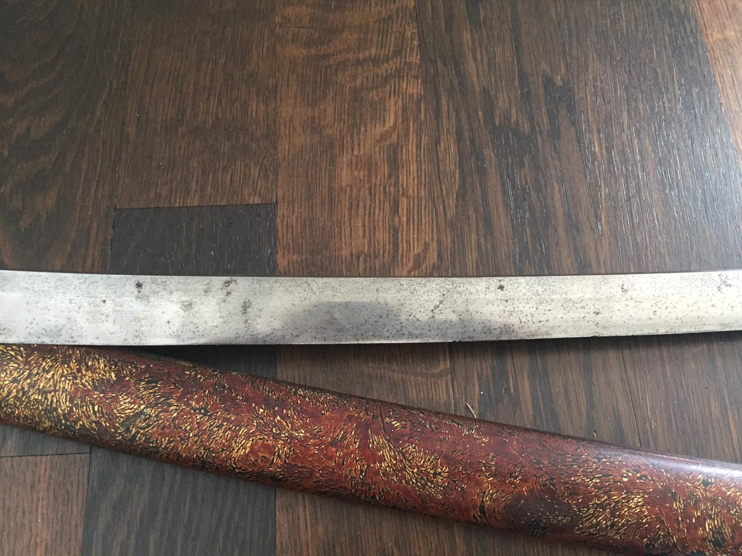

Ray Singer Posted August 28, 2018 Report Posted August 28, 2018 Hi Alex, the image hosting makes it difficult to evaluate (especially on a mobile device). You may want to attach the photos directly to your post. There appears to be a very large fukure (blister) located directly within the hamon. I don't think that this is a viable candidate for restoration Quote

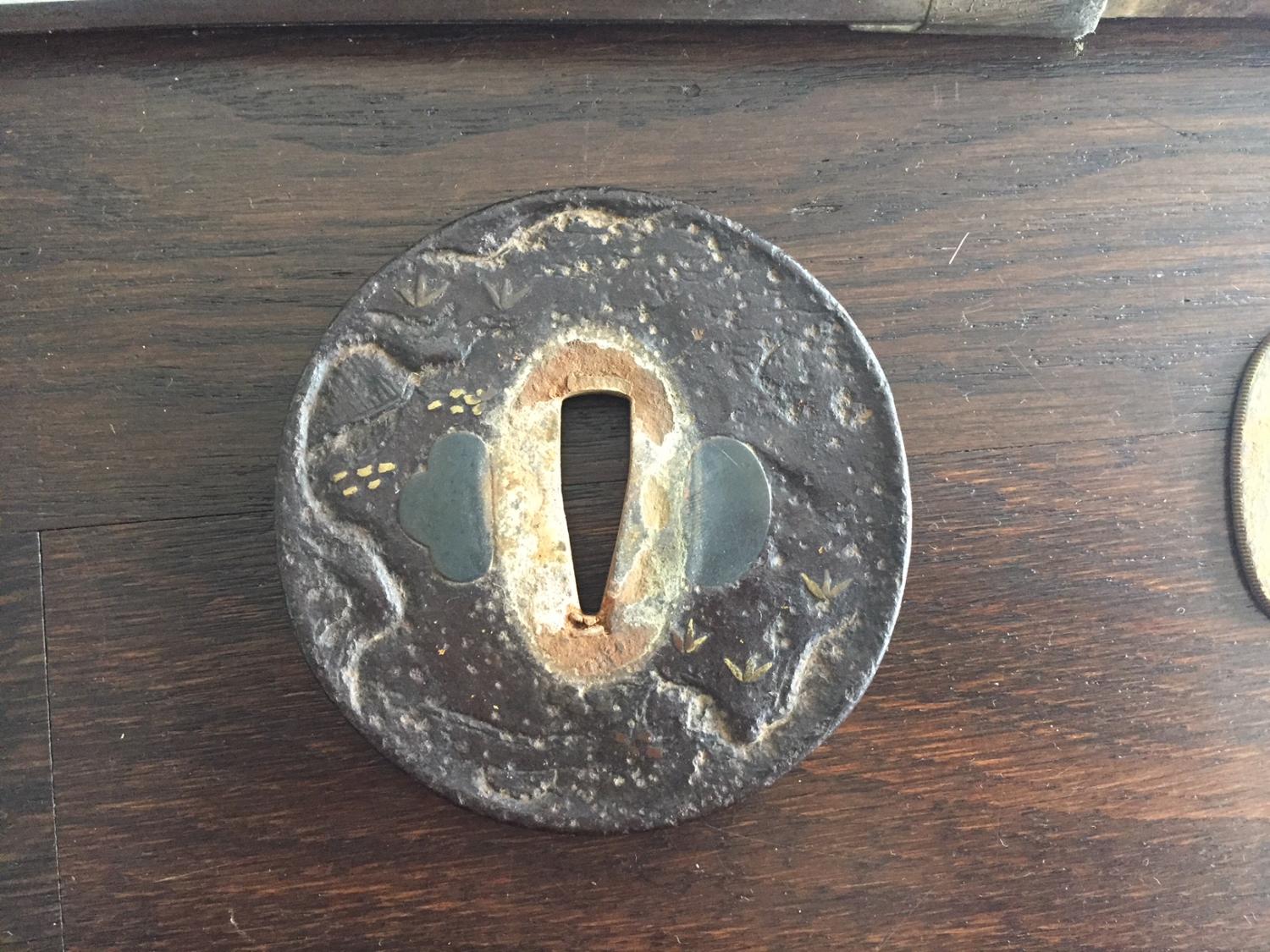

Geraint Posted August 28, 2018 Report Posted August 28, 2018 Dear Alex. However the good news is that you have a genuine Japanese katana, albeit one that has been a little neglected. The fuchi kashira appear to be in iron with a hare running across waves. Whatever you do don't attempt cleaning or restoration until you have shown it to someone who can advise you having seen the sword in hand. If Ray is correct, and he has a very good eye, and there is a fukure or blister in the hamon then the sword will not repay your investment in restoration. ( I have to say that when I zoom in it does look as though there is a jagged void near the edge just below the point, if that is the case then....) However we are only working from basic photographs, one of our German members might be able to look at the sword in hand and give you some advice. I am assuming that there are no characters on the side of the tang that you did not photograph and so at best what you have is a shinto, unsigned sword. In the collectors market this is not a great thing but it is none the less a genuine sword which has value to you. All the best. Quote

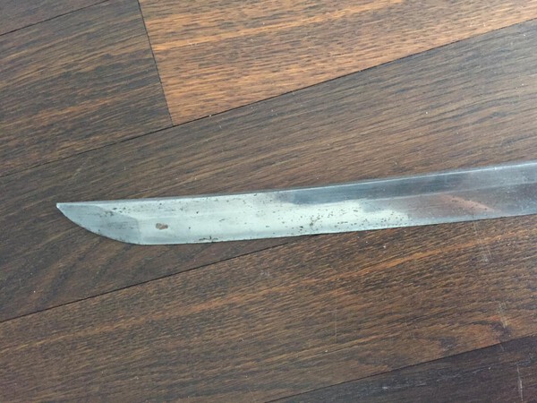

xmr Posted August 28, 2018 Author Report Posted August 28, 2018 Yes, very neglected indeed... and not signed. I'm not planing to sell it. It's been in my family a long time and it'll stay there. I have no idea how much a resoration cost - but I'd like to remove the years of negligence a bit and know something about its age. I made some better pictures of the blade in it's sorry state: Quote
Grey Doffin Posted August 28, 2018 Report Posted August 28, 2018 Hi Alex, We are concerned by the black mark in your 1st picture just above, the one near the edge just below the point. If this is an opening in the skin, restoration makes no sense. If, however, it is just a spot on the surface, there is hope. Proper restoration (polish, new habaki, shira-saya, and a wooden blade to hold the original mounts together (you never put a newly polished sword back into the old mounts lest grit inside mar the polish)) will cost at least $2,000. Improper restoration (by an amateur) is a sin. There is nothing you can do yourself to restore the sword and lots you might try that can do serious damage; don't do that please. Here is a link to a care & etiquette site: http://www.nbthk-ab.org/Etiquette.htm Grey Quote

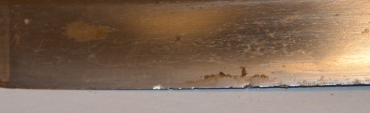

xmr Posted August 28, 2018 Author Report Posted August 28, 2018 Thanks for the link! I wouldn't dare to touch it on my own...Any idea how old it could be? Do you mean this spot: Quote
Ray Singer Posted August 28, 2018 Report Posted August 28, 2018 This is the main area of concern. Separately, there is fingerprint visible in your other photo. Although the sword is not in fresh polish, it is best not to handle directly in order to avoid promoting further corrosion. http://www.nbthk-ab.org/Etiquette.htm Quote
xmr Posted August 28, 2018 Author Report Posted August 28, 2018 I made a better picture of this area Quote
Geraint Posted August 28, 2018 Report Posted August 28, 2018 Dear Alex. This picture looks more hopeful than the earlier ones. When you look at it do you see a surface mark on the blade or a nasty jagged depression? All the best. Quote
xmr Posted August 28, 2018 Author Report Posted August 28, 2018 It looks and feels flat - looks like a discolouration imho. Quote
Ray Singer Posted August 28, 2018 Report Posted August 28, 2018 That is much better news. Clearly not a fukure in the hamon. Apologies for the false alarm. Quote

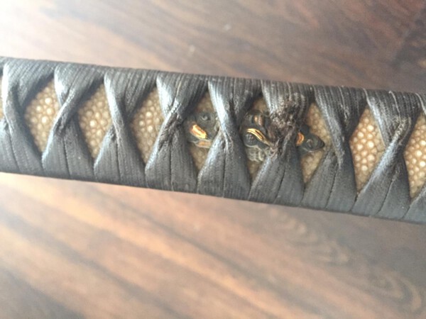

Stephen Posted August 29, 2018 Report Posted August 29, 2018 From the curve (sori)and patina of the tang. Id place it in shinshinto era. 17-1800s. The mounts should be keep org With a wooden filler blade (tsunage). The blade polished and put into shirasaya. Grey has pointed out thats well over $2000. Willing to take it that far? Dont get talked in to having the handle rewrapped, its in good enough condition that ut can be stabilized. Personally id just uchiko and keep oiled being sure to remove those fingerprints. 2 Quote
