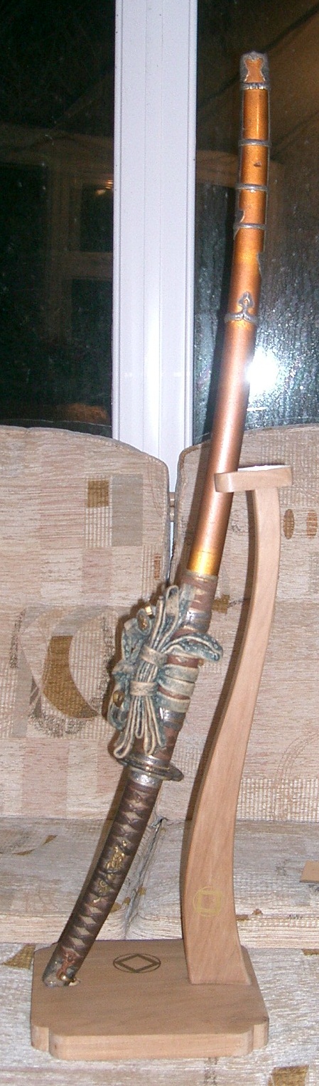

Jussi,
           thanks for your comments, my reply to Mark above must have crossed in the ether with yours, as can be seen from Marcus's description of his lineage there seems to be an issue, maybe the guy never existed I don't know but I guess there must be extant blades by him somewhere, and by default a signature e, or at least a reference in some book or another, as he is listed both by Marcus and Hawley.
    As to whether the blade has a mid-Nanbokuchō shape and Nakajima-Rai characteristics I am unsure and do not feel suitably informed enough to make that call and would suppose there would be numerous variations for the uninitiated to fall over another reason perhaps why I have prostrated myself here in front of the mighty and learned in order to learn.

Paul:
 The second kanji is not "nari" IMHO. Many here are better kanji readers than I am, so if it is "nari" please chime in. Otherwise this is a wild goose chase for sure. It appears to be "gatsu" to me as mentioned above.
 Arnold F.

This is not Rai. You’re headed in the wrong direction, I’m afraid. Without seeing it in hand my vote is that it’s not a nihonto. But if it is – and it certainly could be! – what you have is something much younger and far inferior workmanship to Rai or any contemporaries of Rai.

              did you look at Fujishiro pages 24 and 25, as suggested ,because if you have you cannot fail to see the kanji for nari is almost identical to the one I have presented here.

              thanks for the interest, wasn't aware that I was suggesting it was Rai but just asking if it was, as I have suggested previously as far as Nihonto is concerned I  am a complete novice that is why I have come here to seek advice.
     The one thing that this thread has shown me however is that advice has  been given by various members that contradict others as above some are saying the blade is a Chinese fake others say that the blade is kosher but the horimono are not so please tell me what a mere novice like myself ,without the years of experience some of the commenters on here have, is to think ?     I imagine that with uncertain blades there are probably as many different opinions as there are blades this is why , if someone is offering an opinion it is not unreasonable to it to be backed up by hard fat otherwise said opinion is merely conjecture.
      Paul

              I am not sure if you are saying that you agree with my initial view that the Kanji illustrated in Fujishiro bear a strong resemblance to those on my blade if only in form, where I think it falls down is in the execution of them would appear from my very simplistic view that they lack confidence in execution, not really looked at enough  mei to know if I am right or wrong on this.
            It would appear to me that there are, what I thought to be, a few initial simple questions to answer regarding said blade and to my mind they are as follows
  • Is the blade Japanese -  some say yes some are saying no
  • Is the mei correct - are there examples known - Messrs Hawley and Sekso  et al must have got their information to include his name in their various tomes from somewhere
  • Any similar examples known of the execution of the kanji on the blade -  are they real characters - what do they translate as
  • What is the status of the dragon horimono _is it just a crude rendition of one and poorly executed _ are there any similar examples known
       With regard to the dragon I have spent a little time looking at the beast and would suggest that it has been on the blade for some time and would offer up the evidence for this assumption in that if you look carefully  you will see that on what would have previously been the high spots on the carving that they have now developed flats , which would suggest that the blade has been polished several times after the carving of it.

I think the most likely scenario is that your sword just has false signature of one of the most famous Japanese smiths added on. My guess would be that it is genuine Japanese sword (fairly new) with crudely made horimono and roughly 75 cm blade, I think it is original length and not shortened. Possibly a suguha hamon but I am not sure as I can't see much in the pictures. Not sure if the characters on the other side of the blade are carved or etched? I'd dare to think that the horimono is Japanese made too, I am sure most of us have seen lower quality work on some lower quality Japanese swords. The horimono is tamaōi-ryu, a dragon hunting a gem, it it quite common design of horimono and usually takes a lot of space on the blade. I have seen large horimono of this (and other large dragon) design many times on lower quality swords, possibly added in later to hide some flaws for example. Or maybe someone just wanted a huge dragon on their sword.. :dunno:
I am not sure if there are mei examples of Settsu Tomonari. Sometimes in Japanese sword tradition the family trees etc. get passed down by tradition and there are errors and impossibilities in them. As you see with Settsu Tomonari and date given to him, where as his supposed father Yoshiuji worked c. 50 years later than him.

         thanks for your insightful reply but as always more information elicits more questions, with regard to the dragon I too have seen examples of large dragons but to date not one going through clouds so would be interested , from an academic point of view , for a reference to one the kanji on the blade are actually carved into it, incidentally do you know what they mean ? , as I would be most interested in the meaning behind it, if any

Jussi, interesting that the Bizen Yokoyama '56th Tomonari' that you found also signed "Kimi Banzai" which incidentally is the crude kanji horimono on the ura of this blade

I think that most of the "negative" and/or suspicious comments you have received about this sword have less to do with the details of the signature than with its general appearance. This signature looks fresh and craftlessly made. If you were presented with a letter signed by Shakespeare you might reasonably examine the handwriting. As good as it might seem, you would also have to look to see if it were written with  quill pen or a ballpoint. Your sword seems - to me (!) - to have a signature that looks brand new and written by someone who was not practiced in sword signing.

There is a possibility here that we have not mentioned.  There is a type of sword often referred to as a coronation tachi.  The story goes that these very recent tachi were produced for the coronation of the Showa emperor.  Some of them have Gendai blades made by smiths working at the time, some have older blades.  It is conceivable that this rather utilitarian sword was recruited to serve in this capacity and that the rather sketchy horimono and mei were added to reference the tachi that Matt names, the "Kimi Banzai Tomonari".  Perhaps someone with a distant family connection to the sword wanted to carry it as a symbolic reference to a great past.
Whilst this will not satisfy your search for an oshigata for comparison purposes it might provide an answer that accounts for the fact that this is a true Japanese sword but with more recent horimono and mei.
I have an example with a mei for Kuniteru though the blade is clearly of very recent make and has nothing to do with the smith named.
