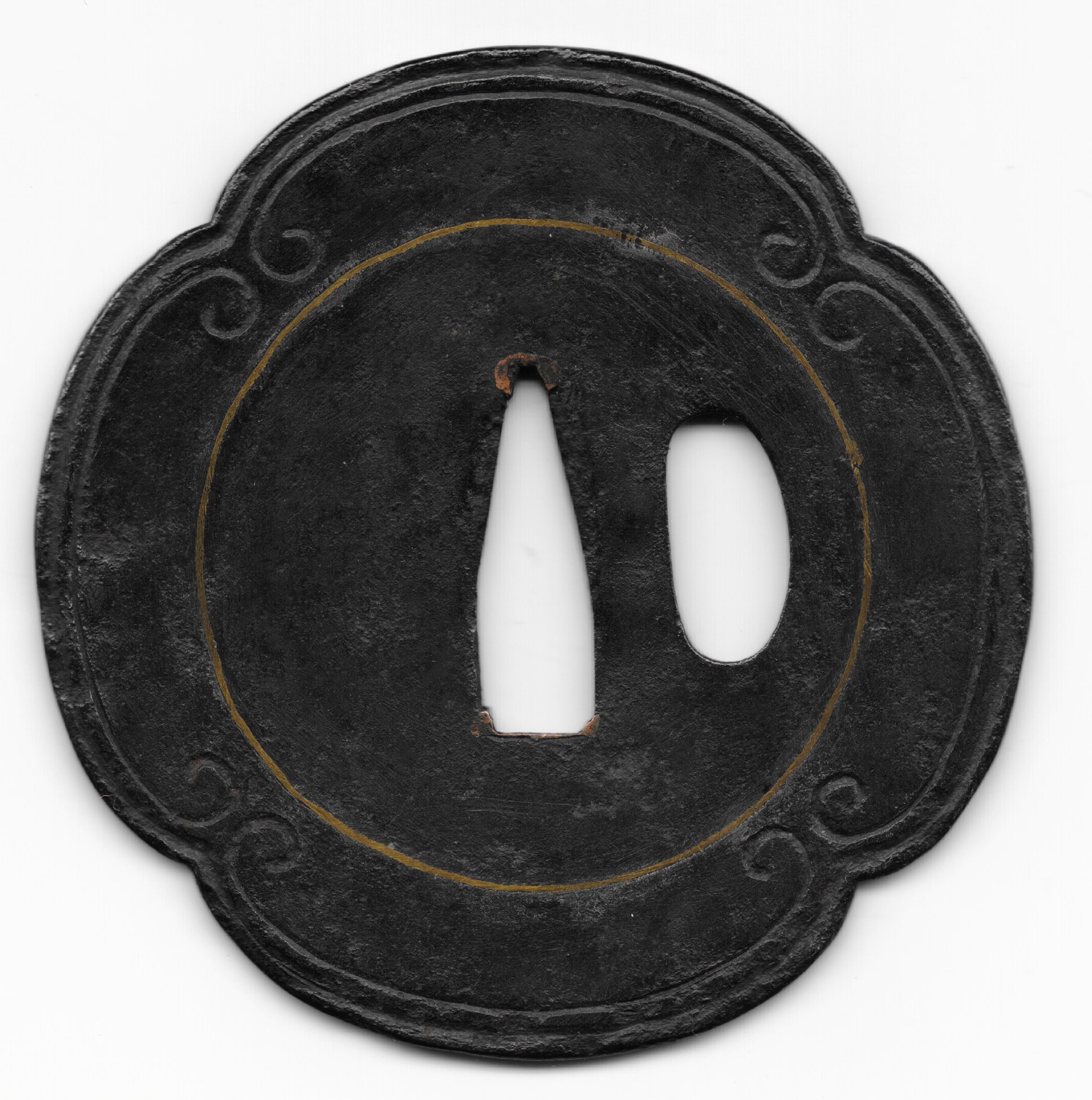

svarsh Posted August 8, 2018 Report Posted August 8, 2018 I had this tsuba for quite a few months, I found similar in books, and I was sure it was a kamakura-bori piece of late Muromachi period, ca. 1400-1550. It was even papered. Recently, I acquired a look alike tsuba, also attributed to kamakura-bori style by the seller, a knowledgeable person. The second tsuba, however, was signed Kunihide, whoever he was, and had clear mokume treatment of the surface. Now, there are two similar pieces in books: 1) Dr. Walter A. Compton Collection, 1992, Christie’s auction, Part II, pp. 14-15, №16: “A kamakurabori type tsuba, Muromachi period, circa 1400. The thin, six-lobed iron plate is carved on each side with a wide groove that follows the shape of the rim, and with six scroll lines and a single thin circular groove. […] The hitsu-ana was added at a later date, circa 1500-1550. Height 8.3 cm, width 8.6 cm, thickness 2.5 mm. The tsuba was initially intended to be mounted on a tachi of the battle type in use from Nambokucho to early Muromachi period (1333-1400)”. 2) Robert E. Haynes Catalog #9 on page 24-25 under №23: “Typical later Kamakura-bori style work. This type of plate and carving show the uniform work produced by several schools in the Muromachi period. Some had brass inlay and others were just carved as this one is. The hitsu are later. Ca. 1550. Ht. 8.8 cm, Th. 3.25 mm”. A question I would like to address to community is: How come a kamakura-bori tsuba got a signature and mokume surface treatment? 1 Quote
Shugyosha Posted August 8, 2018 Report Posted August 8, 2018 Hi Sergei, I think you've answered your own question. I'm guessing maybe a later revivalist piece or utsushi mono: it looks like the hitsu ana were put in at the time of manufacture as the carving seems to stop before the edge of the ana rather than the hitsu ana cutting through the carving. Some interesting information here: http://varshavskycollection.com/kamakura-bori-tsuba/ Best, John Quote
Shugyosha Posted August 8, 2018 Report Posted August 8, 2018 Sergei, Have I been dumb and linked to your own web page?? Sorry, John 1 Quote
zanilu Posted August 8, 2018 Report Posted August 8, 2018 Same design with brass inlay: http://buyee.jp/item/yahoo/auction/f285347549 Regards Luca 1 Quote
svarsh Posted August 8, 2018 Author Report Posted August 8, 2018 That's what I found at Nihon Tō Kōza, Volume VI / Japanese Sword / Kodōgu Part 1, page 231: Enju Kunihide, a tōshō from Higo: "...forging of the jigane is excellent, and there are also pieces with mokume hada." Cannot find this Kunihide anywhere. When did he live? Quote
Pete Klein Posted August 8, 2018 Report Posted August 8, 2018 Haynes Index Vol. 1, pg. 741: (sorry it's a bit slanted but the best I could do due to the binding). 3 Quote
svarsh Posted August 8, 2018 Author Report Posted August 8, 2018 Pete, this was most helpful! Thank you very much indeed. Quote
Kurikata Posted September 26, 2020 Report Posted September 26, 2020 I Have just purchased this kamakura tsuba. Even if it is mentioned in books that some had brass inlay , I was wandering if in mine, those inlays were original or a later addition in Edo times. Your views, please. 1 Quote

Geraint Posted September 26, 2020 Report Posted September 26, 2020 Dear All. In this instance I think we need to be clear about the difference between a Kamakura period tsuba and a Kamakura bori technique. We have all seen the largely pictorial tsuba with sukashi that are clearly Kamakura bori tsuba, i.e., made using the Kamakura bori technique. Where this becomes less clear cut is tsuba such as the examples in the original post. Here is a design which in one of the examples illustrated is early and in the other late. (The attribution by Christie's for the Compton collection example is very early and I can't suggest why they made it.) The example illustrated that Mikolaj posted as a pre Kamakura tsuba, or a fore runner of Kamakura, is dated as early Muromachi. This is a really early date for these tsuba and may only refer to this single example. Most suggest a period from late Muromachi onwards. See here: http://www.shibuiswords.com/ELkamakura.html So, the tsuba under discussion were made from, at the earliest the Early Muromachi until at least Shinshinto times. The clues for the age of an individual tsuba must come form the plate and other indications not just the design. In the original post the second example was sold as Kamakura style. Which of course it is, albeit made in the last two hundred years. The mei and the treatment of the plate indicate a late date. OK, I'll put the hobby horse back in the stable now............ All the best. 3 Quote
Surfson Posted September 27, 2020 Report Posted September 27, 2020 You are always the voice of reason Geraint and I, for one, appreciate it. I completely agree with your comments. As it turns out, this thread is more confusing since the tsuba is arguably Kamakura Bori, and there are examples that were made very early (although I'm not sure that they go back as far as the Kamakura Jidai). Here is a link showing the attribution of such a tsuba to Kamakura (in this case, referring to the style, not the age). Cheers, Bob http://www.shibuiswords.com/ELkamakura.html 1 Quote
Curran Posted September 27, 2020 Report Posted September 27, 2020 👾 Don't drop the Bori. Kamakura-bori. As in the style of wood carving. It doesn't mean a d@mn thing in relation to the dating of this school of tsuba. It is just a style. You can have Kamakura-bori from the 1400s thru the 1800s. Don't take too much meaning from it. Nice Kunihide and a very nice katchushi with the subtle gold dot. 2 Quote

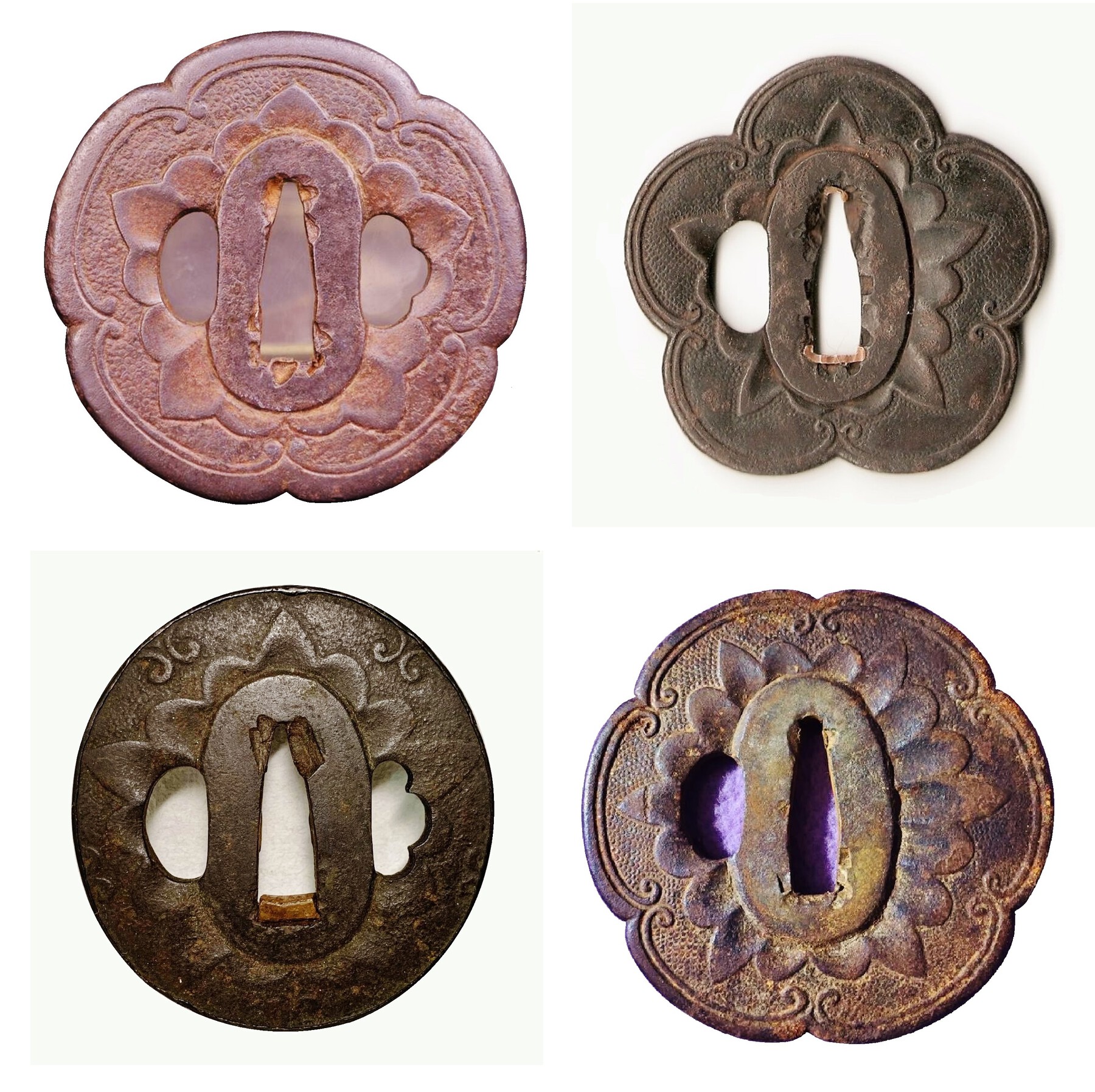

Spartancrest Posted September 28, 2020 Report Posted September 28, 2020 I agree with Curran, it is a style, there are very modern versions. These are four of mine [before they were cleaned of rust] They have the same lobed layout with the 'draw handle' motif [stylized Chinese influence clouds?] with some 'extra' carving by way of a flower centre. [the number of petals varies with the lobes] I don't claim they are Kamakura or Kamakura-bori just that the designs are very similar. 4 Quote
