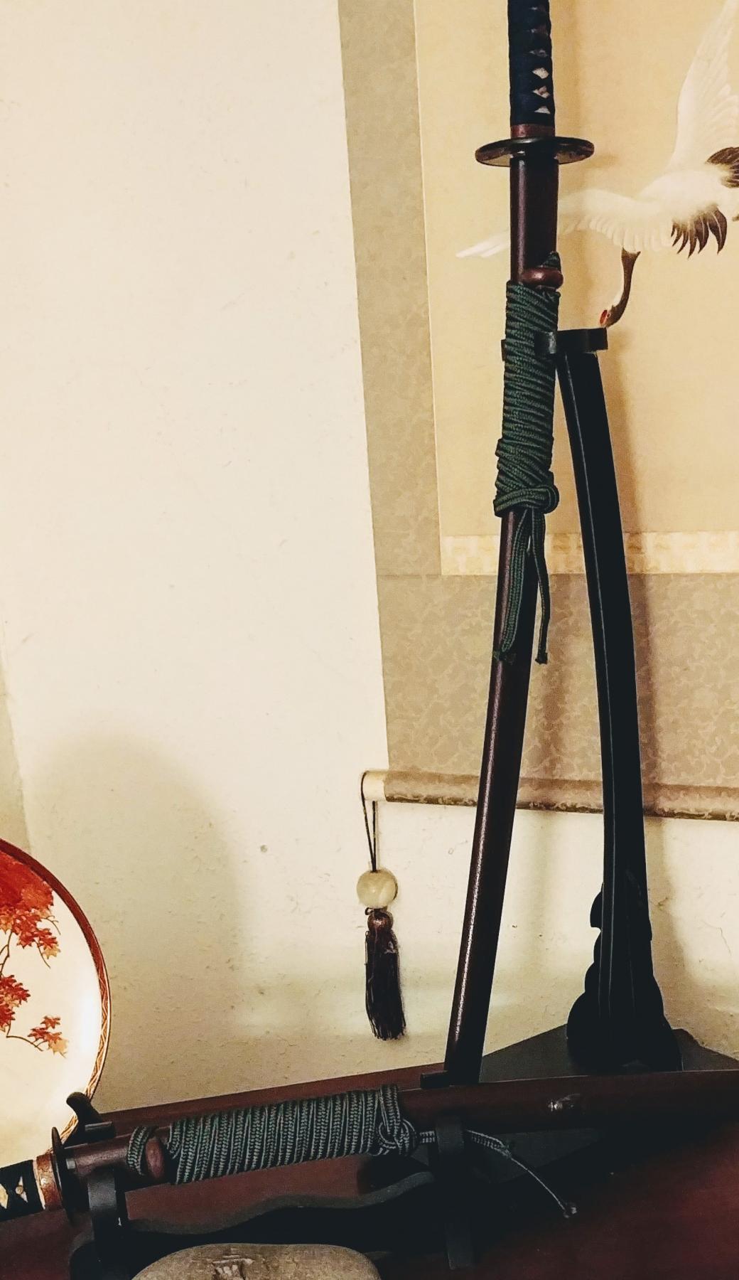

A very kind member gifted me these when he could not find the color we had selected from numerous charts. I have googled to no end in finding a way to tie as shown.
Been through all the vids on saego knots..having all thumbs is not helping.
Really dont want to end up with out a knot due to color and highlight.

John my style to but these are way long, and with the brown specks i just dont get same feel as with my other set.

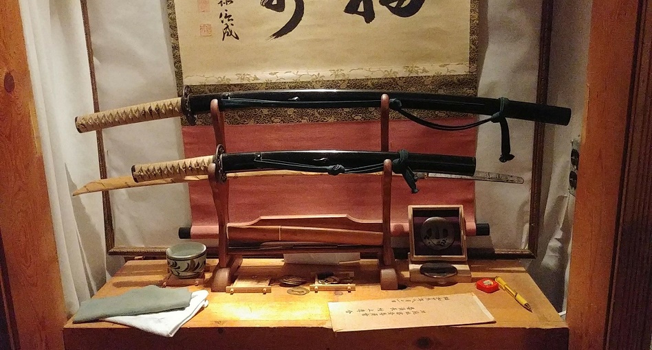

bit messy but did a quick shot for member to show how i desplay

The swords look beautiful, I think your overthinking it, just experiment at your leisure and eventually you will come upon something your happy with. Just remembered, someone I knew practiced tying on a section of wooden curtain rod , less intimidating and you can work at any angle thats comfortable.....worked for him.

Thanks for the flowers, Brian!  :) Yes, sageo are kind of a pet peeve of mine; I always look at how they are tied, and try to recreate them, to give my swords a liitle more variety.
Thanks Gman ill show after coffee and my eye's are awake.

Not great skills yet really very simple after a go or two. Yet to master is making them tight.
Not a good knot for tachikake, lucky i have two one taller than other.
