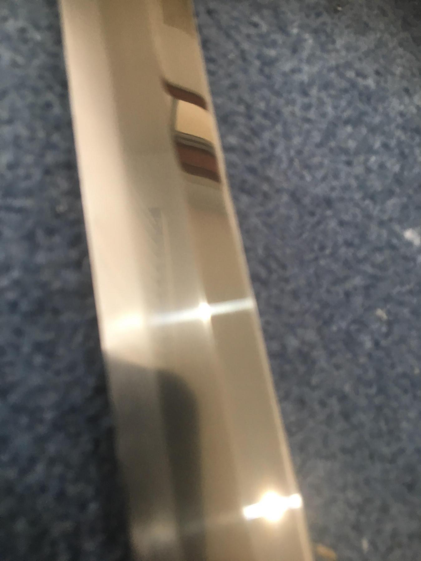

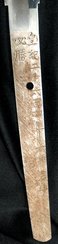

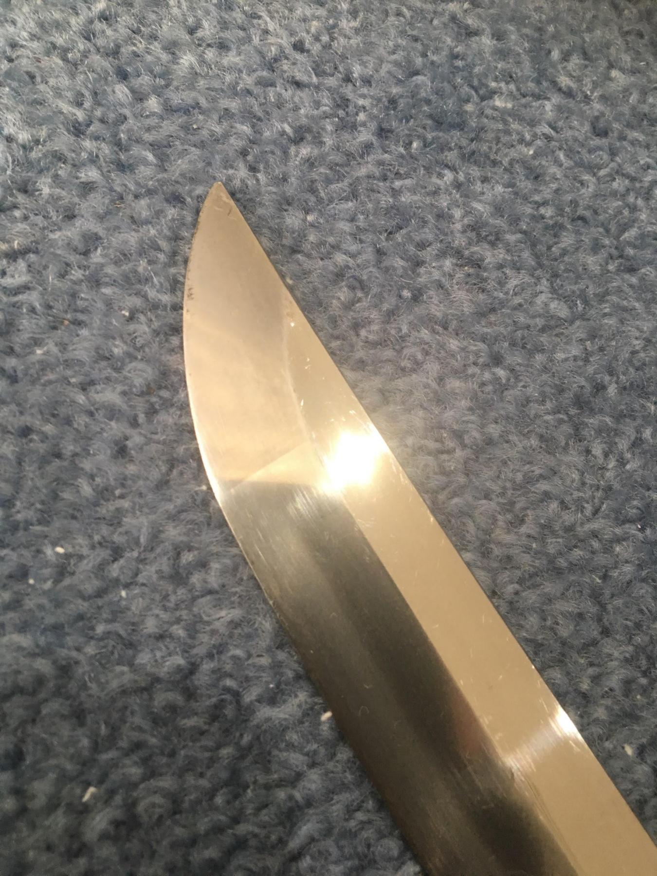

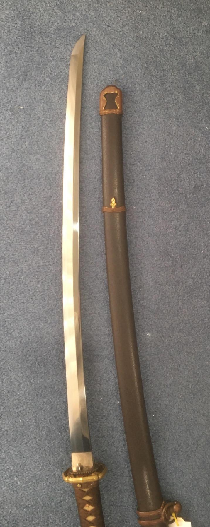

IJASWORDS Posted July 27, 2020 Report Posted July 27, 2020 Mark, thanks for reconnecting with this topic again. Your earlier research was interesting. Here are some photos that may help. 1 Quote
PNSSHOGUN Posted July 27, 2020 Report Posted July 27, 2020 Hard to tell from the photos but it actually reminds me of a Koa Isshin..... 1 Quote

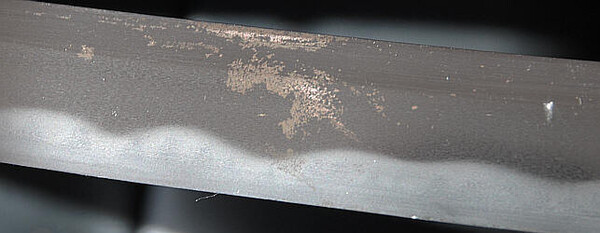

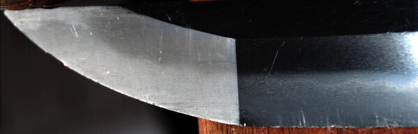

Curran Posted May 25, 2022 Report Posted May 25, 2022 https://www.samuraishokai.jp/sword/22613.html Western steel? This was an interesting thread. I'd think it a bit cheeky to make a tanto for the birth of the Crown Prince and use western steel. I'm here entirely to learn. As most know, I'm 97.5% fittings centric. This all came to my nose while researching a special tsuba made around the same time. Tantou [Ikkansai_Kunimori](Yasukuni Sword Maker)(The sword by which His Imperial Highness the Crown Prince is born commemoration) Quote
Bruno Posted May 27, 2022 Report Posted May 27, 2022 Hello Curran, Very nice commemorative tanto, but not made for the imperial family. Actually on the picture, there appears to be no hada and there is no nie so it certainly looks like an oil quenched western steel blade. In the Taisho and early Showa period, many smiths were using western steel because tamahagane was very hard to get- Yoshichika, Minamoto Kanenori, Hayama Enshin, all used western steel in this era. Using western steel was not disrespectful for them Quote
