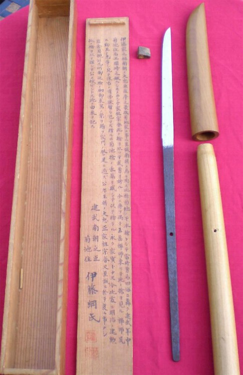

Dewa501 Posted May 18, 2008 Report Posted May 18, 2008 Having visited this sight for quite some time now I have been compelled to join in when I saw the threds about Kikuchi yari. I have been collecting Japanese spears for twenty years or so, and am lucky enough to own two full length Kikuchi yari. The first has a blade of eight inches and a nakago of twelve inches, not in good polish, but a clear sugaha hamon visible, the spear is signed Hishu no ju Kunitoki and dated to Kemmu, it is contained in a box with its history brushed on the inside if the lid (see Roald Knutsen's second book on pole arms) The second and larger spear has a blade of fourteen inches and a nakago of eleven inches, the blade is not signed and is out of polish so no great details, but is certainly contemporary with the other. Both spears have a huge thickness across the mune at the machi end, the larger spear has two mekugi-ana, no file marks remain on ether. Many questions need answers, the Kikuchi Han's history and records were destroyed in a castle fire, but we have managed to do some research though the good offices of a professor of history at Saga university. Thank you all for your most interesting inputs and thank you for the remarkable photograph. I will try to upload a photo, but I'm not to good at this sort of thing !! Chris F. Quote

Dewa501 Posted May 22, 2008 Author Report Posted May 22, 2008 Hi all. Brian, thank you for your interest and enthusiasm, yes, I am the owner of the yari in Kntusen's book, and looking at my notes I see that I have owned it since 1995, It came from a Gun show in the US where it laid on a dealers table for three days or so before my pall spotted it, no one showed any interest in it at all, these yari are very few and far between and it seems that is the case in Japan too, so far we have only come up with a handful, 4/5 in museums, (I'm sure there a more) Most of the research done at the time (98%) did go strait in the book, and its been an ongoing struggle to dredge up more info from Japan ever since. I could not believe my eyes when I saw Mr. Morita's photograph, I've been looking for something like this for years, it is surprising to find no trace of the Kikuchi yari in most of Japan's books on spears old or new. No one, as far as I know has seen one mounted on a pole, obviously, much the same as any other yari, but it was great to see one in the photo, its all grist to the research mill, however Roald Knutsen has found one depiction of a Kikuchi yari in an old triptych, from about the right time which appears to have a candy stripe pole maybe nine feet long, a very nasty weapon in the hands of a trained man. I think that's about all, but I must say that one has a strange feeling looking at it and thinking that it mat have been at Hakone on that day ! I will try more pics. Chris F. Quote
Dewa501 Posted May 24, 2008 Author Report Posted May 24, 2008 Hi all. Picture of Kikuchi yari and all of the bits. Sorry that its so lousy, It seemed OK on the computer.......... I guess you guys can do something with it. Chris F. Quote
