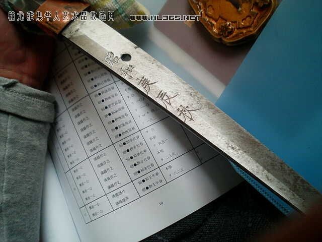

Bruce Pennington Posted September 12, 2019 Author Report Posted September 12, 2019 Showa 19 (1945): 興南一誠 (Kou-nan issei) [only 1 example] Do you have the pic? Moritasan! It is an honor. I enjoyed your chart Ohmurasan used on his site! I found this in a collection owned by Beng Chua of Singapore. Here is his page on this one: http://www.kinghouse.sg/collections_frame.asp?cat=8 It came with a general grade tassel (I know,this could have been added later). Here are the pics: 1 Quote

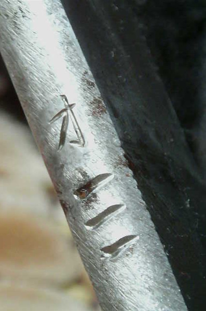

Kiipu Posted September 15, 2019 Report Posted September 15, 2019 John, thanks, that's "SE" 72 Is the nakago too rusty to get the date? Post #14 The katakana character is YA and not SE. ヤ 72. According to your table, this would date to 1942, possibly autumn. http://www.militaria.co.za/nmb/topic/26165-attention-mantetsu-owners-a-survey/page-1?do=findComment&comment=264433 2 Quote

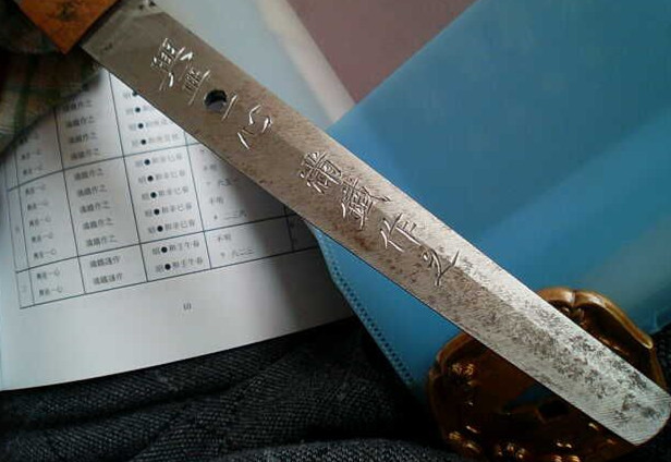

BANGBANGSAN Posted September 15, 2019 Report Posted September 15, 2019 Bruce Here is one more for you. 昭和庚辰秋(1940 Autumn),興亞一心,滿鐵作之。才(0) 一一一(111). 1 Quote
PNSSHOGUN Posted September 15, 2019 Report Posted September 15, 2019 Post #14 The katakana character is YA and not SE. ヤ 72. According to your table, this would date to 1942, possibly autumn. Thank you so much, I'm so glad this table exists so swords like mine with rusted dates can be identified. 1942 fits in with the Koshirae as well. Quote

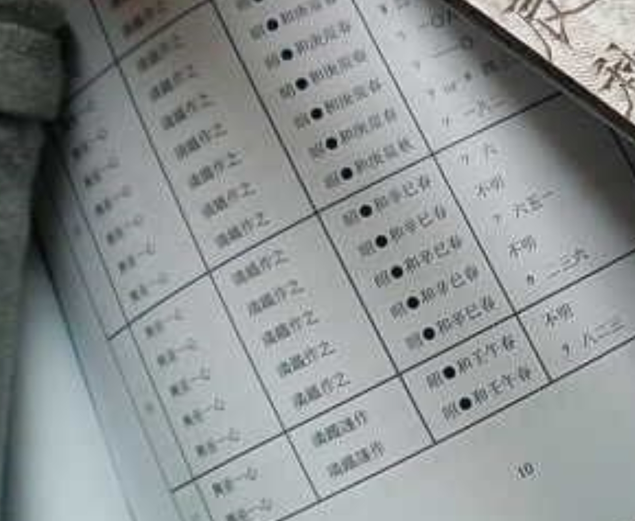

Bruce Pennington Posted September 15, 2019 Author Report Posted September 15, 2019 Bruce Here is one more for you. 昭和庚辰秋(1940 Autumn),興亞一心,滿鐵作之。才(0) 一一一(111). John,What da heck is this!? Thanks for the blade, didn't have that; but did you see the book in the background? It looks like a catalog of Mantetsu serial numbers! The website listed in the photo is a South China business group. Do you know anything about them and/or this book? Quote
Kiipu Posted September 15, 2019 Report Posted September 15, 2019 John, What da heck is this!? Thanks for the blade, didn't have that; but did you see the book in the background? It looks like a catalog of Mantetsu serial numbers! The website listed in the photo is a South China business group. Do you know anything about them and/or this book? SmartSelect_20190915-153645_Chrome.jpg The information is coming from the Ohmura website. It matches exactly. With that said, it would be interesting to find out what publication reprinted it. Possibly a club newsletter or such. http://ohmura-study.net/222.html Quote
BANGBANGSAN Posted September 15, 2019 Report Posted September 15, 2019 John, What da heck is this!? Thanks for the blade, didn't have that; but did you see the book in the background? It looks like a catalog of Mantetsu serial numbers! The website listed in the photo is a South China business group. Do you know anything about them and/or this book? SmartSelect_20190915-153645_Chrome.jpg Bruce It's me NOT John post the photos of that 1940 Mantetsu.I think the background book is Chinese collector's reprint of Ohmura's Mantetus info. Trystan Quote
