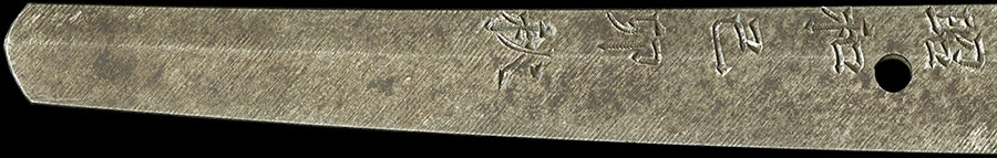

Bruce Pennington Posted May 3, 2019 Author Report Posted May 3, 2019 A minor update on the Mantetsu mei dateline. I've found a '39, chopped to waki size, but having bothe the Dalian Railway Stamp AND the Koa Isshin mei. It's a Spring of '39 so there might have been a transition early in the year where both appeared together. So for now, here's the mei timeline: Showa 13 (1938) Winter - Dalian Railway Stamp; no mei Showa 14 (1939) Spring – Dalian Railway Stamp; 興亜一心 (Koa-Isshin) 満鉄作之 (Mantetsu Saku Kore) Showa 14 (1939) to Showa 16 (1941) : 興亜一心 (Koa-Isshin) 満鉄作之 (Mantetsu Saku Kore) Showa 17 (1942) : 興亜一心 (Koa-Isshin) 満鉄謹作 (Mantetsu Kin-Saku) Showa 17 (1942) to Showa 18 (1943) : 興亜一心 (Koa-Isshin) 満鉄作 (Mantetsu Saku) Showa 18 (1943) to Showa 19 (1944) : 満鉄鍛造之 (Mantetsu Tanzo Kore) Showa 19 (1945): 興南一誠 (Kou-nan issei) [only 1 example] Quote

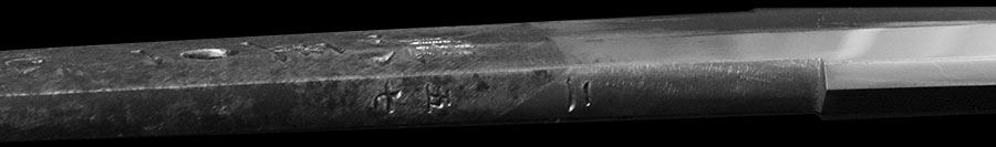

Bruce Pennington Posted May 29, 2019 Author Report Posted May 29, 2019 Thanks Chris. I got in touch with the owner and he sent pictures! It's a Spring '43, Fu 48, Koa. So, assuming the blades were numbered in order, sequencially, we now have 3 "lines" with both Koa and non-Koa/Nan mei, and they are NOT in order! Hi 226 Nan 591 Koa Fu 1385 Nan 48 Koa Sa 52 Nan 361 Koa Sa 459 Nan If the theory about SMR sending unfinished blades to Mukden (as we know they did for Tokyo Arsenal) to be "finished," is correct, that would mean that the unfinished blades were numbered BEFORE they were sent out, and the mei was added by the finishing establishment. If the theory, that the Koa's and Nan's were ALL made by SMR, and '43 was a transition year between making Koa's and transitioning to non-Koa mei, the numbers SHOULD be in order. The first numbers cranked out should be Koa's and the later numbers Nan's; but as we can see with the HI and FU lines, it's just the opposite! and the SA line is backwards, but goes to Nan at again. There might be a logical explanation for this, but on the face of it, seems unlikely. Based on this TINY bit of evidence, Mukden theory seems to be more plausible for now. 1 Quote

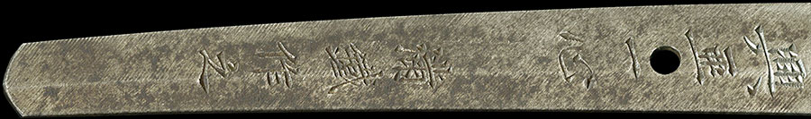

PNSSHOGUN Posted August 3, 2019 Report Posted August 3, 2019 Another one with NTHK papers but later Mantetsu-To mei: https://www.Japanese-sword-katana.jp/katana/1910-1115.htm 1 Quote
Bruce Pennington Posted August 3, 2019 Author Report Posted August 3, 2019 Great John, didn't have that one! It's a "Nan" stamped, non-Koa, with "W", my second '44 marked so. These muddy my theory that Mukden made these Nan-stamped blades because I'm fairly certain the W inspector mark originates at the Tokyo Arsenal. I suppose one idea is that the Tokyo Arsenal had an inspector working the Mukden arsenal, or Mukden inspectors used the W on authority of Tokyo? I wish I knew more about how that process worked. Quote

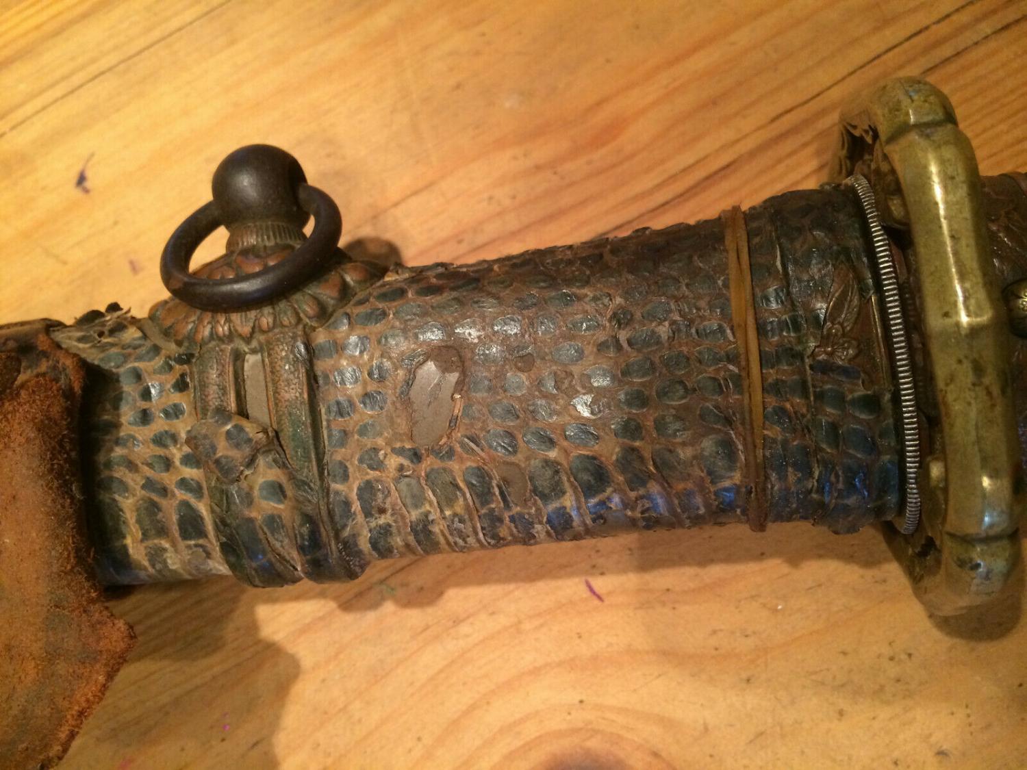

Bruce Pennington Posted September 11, 2019 Author Report Posted September 11, 2019 Here's an interesting one, not because it's a Mantetsu, but because of the "snakeskin" saya cover! Very unusual!!! It's for sale on fleabay now. 1 Quote
