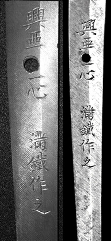

Bruce Pennington Posted April 14, 2019 Author Report Posted April 14, 2019 Thanks to Ontario_Archaeology for this find on a Japanese auction site https://buyee.jp/item/yahoo/auction/w307428001/detail#googtrans(ja|en). Claims to be carried by a Col Nakagawa on Peleliu; FULL HAMON. It's the second one I've come across recently with wavy hamon, and both are Spring '41's. I've got the inscription posted over on Translation Assistance, so I'll update if significant news comes from it. As always, I welcome your thoughts. I'm aware Mantetsu made some custom blades, but these wavy hamon blades generate a bunch of suspision about gimei jobs on otherwise unsigned nihonto to drive the sell price up. 1 Quote
PNSSHOGUN Posted April 14, 2019 Report Posted April 14, 2019 Another Gimei from whoever Komonjo sources his listings from. 1 Quote

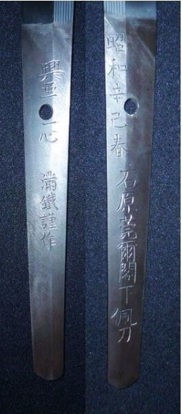

BANGBANGSAN Posted April 15, 2019 Report Posted April 15, 2019 Bruce I found some photos for another Mantetsu had similar signature in style and position,it also papered.It says belongs to General 石原莞爾 Kanji Ishiwara.Seems quite a few these sword with newly registered paper pop up in Japan this year. I think there are goup of Japanese doing this on Mumei blade ,just try to fool collectors. Quote
Brian Posted April 15, 2019 Report Posted April 15, 2019 Definitely a syndicate doing this regularly. Not sure if they are refinishing and signing mumei swords, or having them made. Either way, I am sure there are investigations ongoing. Quote
Bruce Pennington Posted April 15, 2019 Author Report Posted April 15, 2019 John, Thanks for the photo. I agree they all have the same look. They all have attributions to generals or admirals or colonels. Brian, I’m finally there with you on this. The file marks are never correct for Mantetsu blades. And they all have these unique marks that I’ve pointed to in this photograph.191B2472-1591-4E37-80AF-E88373FE7290.jpeg John, Thanks for the photo. I agree they all have the same luck. They all have attributions to generals or admirals or colonels. Brian, I’m finally there with you on this. The file marks are never correct for Mantetsu blades. And they all have these unique marks that I’ve pointed to in this photograph. Quote
BANGBANGSAN Posted April 15, 2019 Report Posted April 15, 2019 John, Thanks for the photo. I agree they all have the same luck. They all have attributions to generals or admirals or colonels. Brian, I’m finally there with you on this. The file marks are never correct for Mantetsu blades. And they all have these unique marks that I’ve pointed to in this photograph.191B2472-1591-4E37-80AF-E88373FE7290.jpeg All these sword wrote 佩刀(Carried by)not very convinced. Quote
reeder Posted April 15, 2019 Report Posted April 15, 2019 John, Thanks for the photo. I agree they all have the same luck. They all have attributions to generals or admirals or colonels. Brian, I’m finally there with you on this. The file marks are never correct for Mantetsu blades. And they all have these unique marks that I’ve pointed to in this photograph. 191B2472-1591-4E37-80AF-E88373FE7290.jpeg Those are from polishing... 2 Quote
Bruce Pennington Posted April 16, 2019 Author Report Posted April 16, 2019 Thanks Brandon. I just learned that on a similar discussion on the Translation Assistance thread. They said these "signature" marks by the polisher have been used for centuries. I'm not a nihonto collector, so I haven't come across them before (or noticed them if I did). I guess the problem is the same, though. Even if the polisher was a current one from today, not WWII, it doesn't prove or disprove, by itself, the age or legitimacy of the blade. If the marks are unique to a particular polisher, I think it adds some building evidence that a particular seller in Japan is turning mumei blades into Mantetsu blades and having them polished by his favorite polisher. They all have the same look, polish, and attribution characteristics. Quote

reeder Posted April 16, 2019 Report Posted April 16, 2019 These polisher marks are not specific to any polisher. It tells you nothing more than it was polished. Sword is not correct. Quote

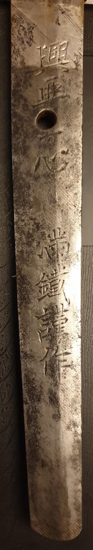

Bruce Pennington Posted April 17, 2019 Author Report Posted April 17, 2019 Bruce this blade is very well forged. The signature looks perfect for me. I know that you look for authencity of ww2. But i really think that is a genuine mantetsu sword. It looks done yesterdayI'm firmly on the fence (though wavering to fake). The mei and serial numbers are as good as any Mantetsu out there. New- I first thought "well, the polisher would have cleaned the whole thing, that's why it looks new." I checked my polished Mantetsu, and while he shined the nakago, there is patina still imbeded in the kanji cuts. Soooo, either the one in question was cut recently, and no patina, or the polisher REALLY cleaned the nakago - UNKNOWN. We have a sample of 2 (maybe 3), but both the current ones looks identical and too new. I'm saving this one like I did the last one - "under suspicion". I would love to see (assuming fakery) one come out with an identical serial number to an existing one in the database. But, there were approx. 38,000 of these made, with a database of 160, so the odds are in their favor right now. Quote
Bazza Posted April 17, 2019 Report Posted April 17, 2019 It looks done yesterday ... and I think I see "chatter" on the file strokes, i.e., not a trained metal smith?? BaZZa. 2 Quote

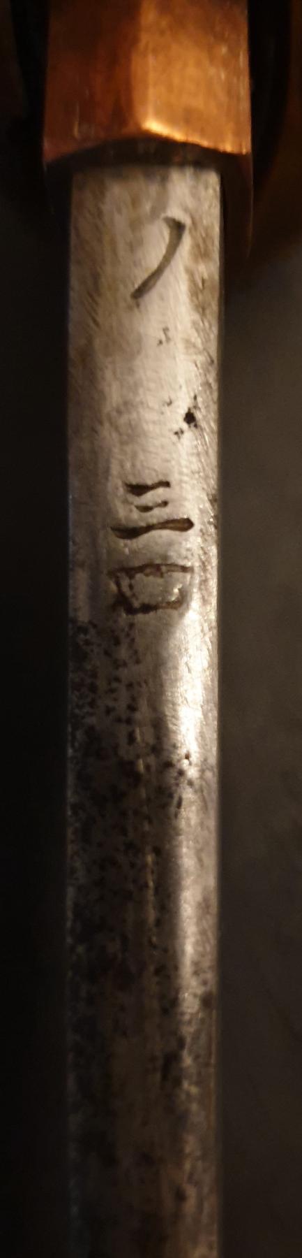

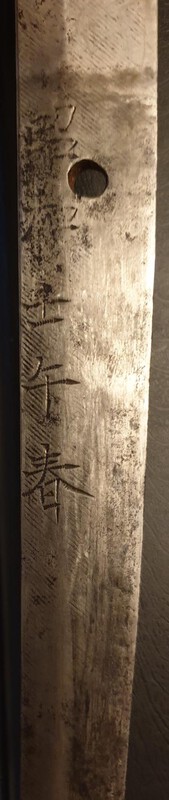

Bazza Posted April 17, 2019 Report Posted April 17, 2019 Bruce, here is more grist for your mill. The attached photos are titled "Bazza's...jpg", but in fact the sword belongs to a friend of mine who has at last sent me photos of his Mantetsu. I don't have any other photos so can't comment on condition, but the tang suggests it has had a hard life. So in essence this is a contribution to your survey. BaZZa. Quote
Bruce Pennington Posted April 17, 2019 Author Report Posted April 17, 2019 Bruce, here is more grist for your mill. The attached photos are titled "Bazza's...jpg", but in fact the sword belongs to a friend of mine who has at last sent me photos of his Mantetsu. I don't have any other photos so can't comment on condition, but the tang suggests it has had a hard life. So in essence this is a contribution to your survey. BaZZa. Thanks, great one! It's my first and only "No" serial number! And yes, the nakago looks quite worn! I don't see how a nakago could get so worn under a tsuka. I almost want to think it was previously heavily rusted and has been cleaned, but "cleaned" would look shiny and buffed, where this still looks old and just worn. Interesting one. Quote
