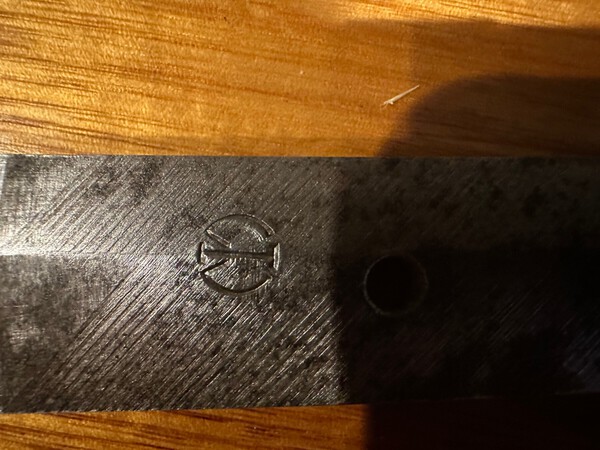

PeterCollector Posted November 4, 2024 Report Posted November 4, 2024 Hello, dear fellow collectors, I just want to share my latest sword made my Mantetsu. What is really nice is that whole sword is numbered "6" or "9" - on each of its part. Blade is in full mint condition, marked two times with "w" charakter, one time "6" on the back and below ith is also marked with bad punch "6". Please can you help me with exact datation of the sword? There is also little marking on pommel. It looks like sword was made with set of only four seppa, but everything holds tight without any movings. The sword is in state in which I bought it, I did not polished it, on ly cleaned it with piece of cloth. I hope you like the sword and if you see any red flags, please tell me, but I hope there is nothing to worry about the sword. Kind regards Peter 1 Quote
PeterCollector Posted November 4, 2024 Report Posted November 4, 2024 Here are few closeup photos of the blade, I hope you like it. Kind regards Peter 1 1 Quote
Bruce Pennington Posted November 4, 2024 Author Report Posted November 4, 2024 It's a real beauty, Peter! Thanks for posting! The small stamp on the kabutogane is the Tokyo 1st Army Arsenal inspector stamp. The mei is Koa Isshin Mantetesu made this Date: Spring 1942 Serial number: ノ302, or "NO 302". The NO series was right in the middle of the 1942 production year. If they counted the year by fiscal year (April to next Mar), it would put your blade around Oct of '42. If calendar year, it would be around Jun '42. You can read more on the following, but in short, the "W" or "M" was a half-way inspection stamp used by the army. The Mysterious W Stamp 1 1 Quote

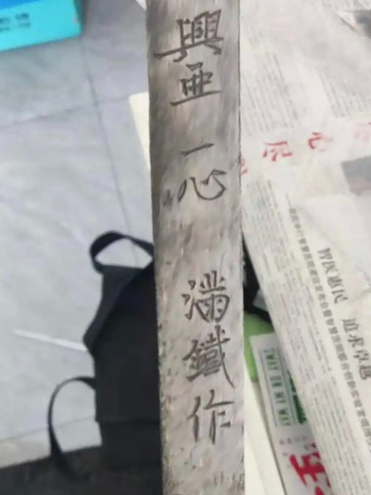

BANGBANGSAN Posted November 27, 2024 Report Posted November 27, 2024 @Bruce Pennington Unfinished Mantetsu made in China Quote
Bruce Pennington Posted November 28, 2024 Author Report Posted November 28, 2024 Sad to see that! Is it actually up for sale, or are they still finishing it? Quote
