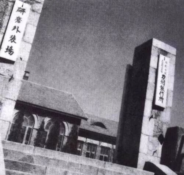

Bruce Pennington Posted December 6, 2022 Author Report Posted December 6, 2022 This photo may have already been posted, but I'm too lazy to scan back through 33 pages of this thread to find out! From @BANGBANGSAN "This photo was taken at Mantetsu sword factory front gate, kanji on the left says 研磨外裝場(Polish&Fitting Factory), on the right, says 刀劍製作所(Sword Manufacture Factory) 3 Quote

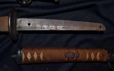

BANGBANGSAN Posted February 8, 2023 Report Posted February 8, 2023 On 2/2/2022 at 7:53 AM, PNSSHOGUN said: Another from yahoo.jp auctions, no pictures of the serial number. There is some Kanji on the Tsuba, wonder what it says? https://buyee.jp/item/yahoo/auction/u1035189279 Kanji on Tsuba: Expand @Bruce Pennington @Kiipu It looks like 昭和十七年 1942(壬午) 於大連 at DaiRen 1 Quote
Kiipu Posted February 8, 2023 Report Posted February 8, 2023 Thanks Trystan for the additional translation. 於大連 = oite Dairen = at Dalian (Chinese 於大连). 1 Quote
BANGBANGSAN Posted February 8, 2023 Report Posted February 8, 2023 On 2/8/2023 at 6:13 PM, Kiipu said: Thanks Trystan for the additional translation. 於大連 = oite Dairen = at Dalian (Chinese 於大连)--于大连 Expand That is a 1942 Mantetsu sword,maybe the owner got it direct from 大連 Mantetsu factory? Quote
Bruce Pennington Posted February 8, 2023 Author Report Posted February 8, 2023 On 2/8/2023 at 4:41 PM, BANGBANGSAN said: It this Ma 77 in Taichi mount? Expand It's in shirasaya in the photos I have: 1 Quote
Bruce Pennington Posted February 8, 2023 Author Report Posted February 8, 2023 On 2/8/2023 at 6:13 PM, Kiipu said: 於大連 = oite Dairen = at Dalian (Chinese 於大连). Expand On 2/8/2023 at 8:00 PM, BANGBANGSAN said: That is a 1942 Mantetsu sword,maybe the owner got it direct from 大連 Mantetsu factory? Expand I'm thinking this might indicate the whole rig, blade and fittings were made at the SMR factory. 1 Quote
