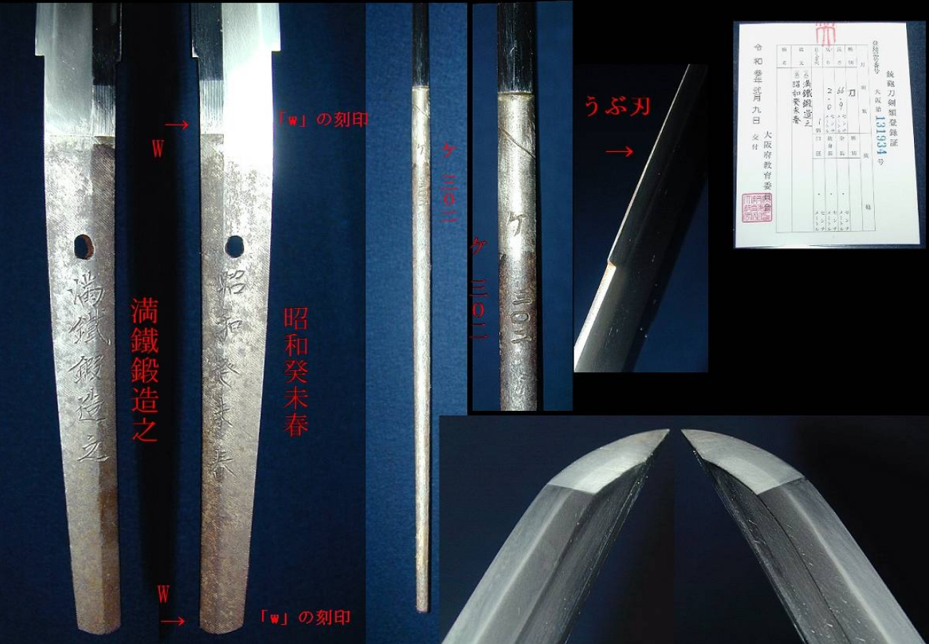

Kiipu Posted June 10, 2022 Report Posted June 10, 2022 The 南 did not start making a nakago appearance until the following 32nd フ series. 「W」の刻印. Ignore the の when translating into English. It simply states "engraved W." 1 Quote

DTM72 Posted July 5, 2022 Report Posted July 5, 2022 On 6/10/2022 at 1:01 PM, Bruce Pennington said: Thanks John, didn't have that one! Interesting there is no "NAN" stamp. Although, these can be struck lightly and hard to see. Can someone quote the comment by the "W" stamp? Just curious what they were saying here: Expand @Bruce Pennington Not sure if anyone answered your question on this. There is a tiny "W" in the polishers stripes, near the mune in the shinogi-ji. Can't say I've seen the W in that location before. 1 Quote

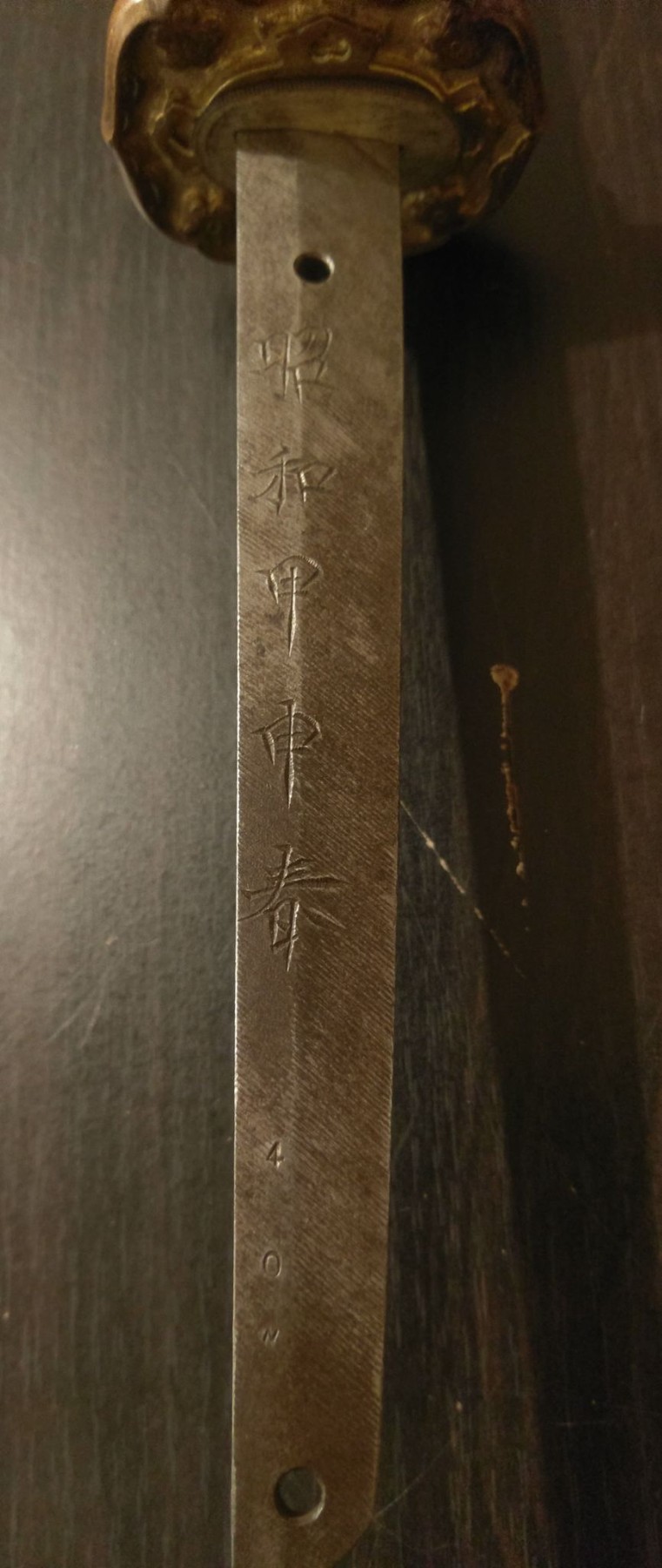

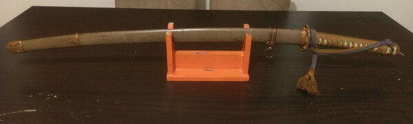

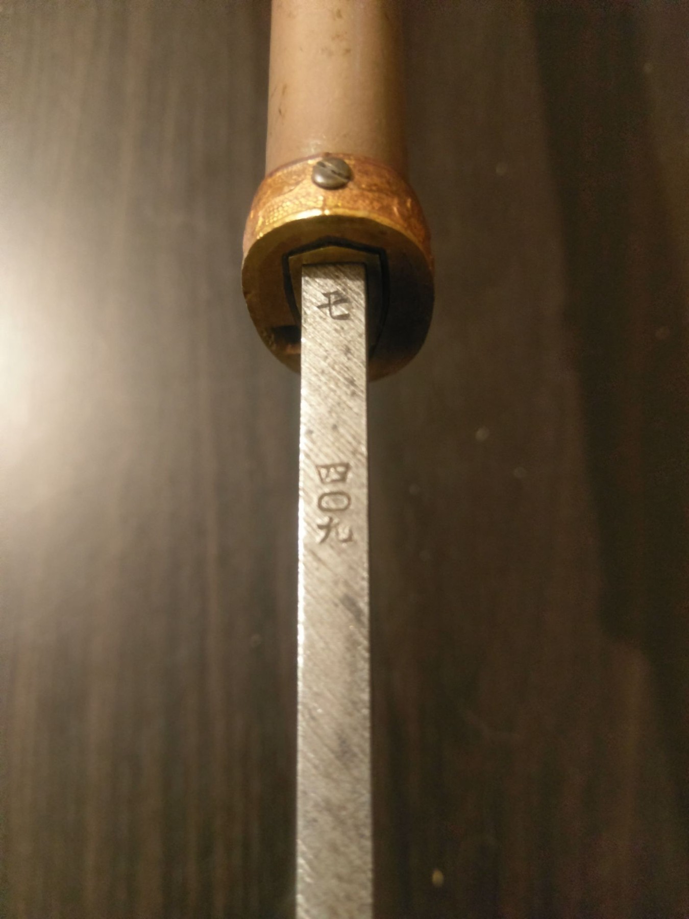

ZedKopp Posted October 25, 2022 Report Posted October 25, 2022 Hi, all! Here is my contribution to this most informative thread. This is the only Mantetsu that I currently have in my collection. Signed Mantetsu Kitae Tsukuru Kore. Dated Spring 1944. Nanman Arsenal mark on nakago. Matching numbers (40) on all four seppa as well as the tsuba and nakago. W mark on nakago. Gilt copper fittings including both menuki. Unknown mark on kashira. Suguha hamon. Any further information would be greatly appreciated. My apologies for the low quality of the photographs. My phone camera isn't very good unfortunately! Cheers! 2 Quote

Bruce Pennington Posted October 25, 2022 Author Report Posted October 25, 2022 Welcome Zac! Excellent presentation, thank you! Your serila number - MO/モ 409 is the second series out of 5 for year 1944. If the series were spread evenly over the year, and we don't know that they were, this would put your date in July through mid-September of '44. I only have 4 '44s in the MO series, now: 104 Nan 228 Nan 409 Nan 799 Ren Concerning the "W/M" stamp, yours is the latest so far, all 4 of the Nan-stamped '44s have the mark. All the previous ones are in 1942/43. From the photo, it looks like the same' is celluloid? Mine is too, and it seems it was used fairly often on Mantetsu fittings. On a "stamped numbers" note, yours is the first 1944 Mantetsu with the stamped numbers on the face of the nakago with matching numbers on fittings. I believe these to be done by the fittings shop. 1 Quote

Bruce Pennington Posted October 25, 2022 Author Report Posted October 25, 2022 On 10/25/2022 at 1:51 PM, ZedKopp said: A further question; the saya on this example is a light purple/lavender color. Is this uncommon? I have only been able to find one other similar example. Expand We'd need to see a photo, Zac. Quote
ZedKopp Posted October 25, 2022 Report Posted October 25, 2022 On 10/25/2022 at 10:34 PM, Bruce Pennington said: We'd need to see a photo, Zac. Expand The saya can be seen in the first picture I uploaded. Let me know if there is an issue with the photograph and I will upload it again. Quote
Kiipu Posted October 25, 2022 Report Posted October 25, 2022 Zac, this particular variant, the interim Type 100/98, was only made in two series, the 44th ヒ and 45th モ series. It consists of a Type 100 blade fitted out as a Type 98. It is an army contract blade that was made in Dairen, Kwantung Leased Territory, that was then sent to Tōkyō, Japan, to be finished. Your sword is the last one known to have used the 南 inspection mark and also the last one to be finished in Japan. After this, they switched to the 連 inspection mark and were finished in Manchuria. Thanks for sharing your sword and may many more come your way. 2 1 Quote
