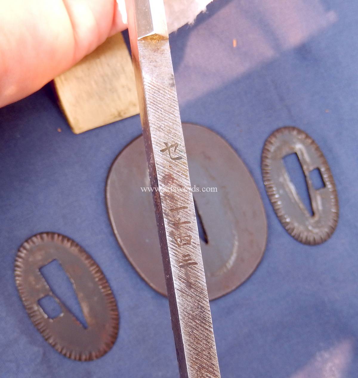

1. 昭和甲申春(1944 Spring)滿鐵鍛造之       セSe 二五七五2575 (Type 3 Mount)
2. 昭和壬午秋(1942 Autumn) 興亚一心 滿鐵作   ヤYa 七九79
3. 昭和葵末春(1943 Spring) 滿鐵鍛造之        エE 三六七367
4. 昭和壬午秋(1942 Autumn) 興亞一心 滿鐵作   クKu 三二七327(With leather cover)
5. 昭和壬午春(1942Spring) 興亞一心 滿鐵謹作 ウU 九九99
6. 昭和葵末春(1943 Spring)  滿鐵鍛造之        メMe 八七87
My Other 2 at my friend's place that I posted before
1.昭和甲申春(1944 Spring) 滿鐵鍛造之        セSe 一0六六1066(Type 3 Mount)
2.昭和甲申春(1944 Spring) 興亞一心 滿鐵作  (イ)I 一六四四1644(Wavy Hamon)

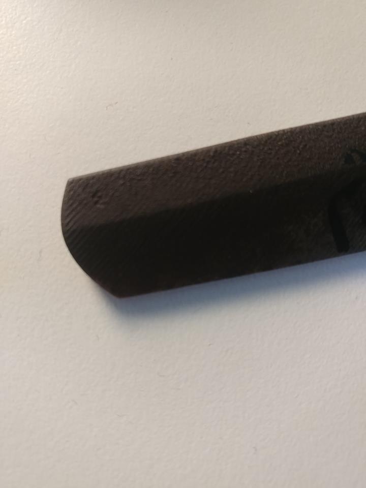

After seeing Trystan's batch of Mantetsu, 2 of his have flat nakago mune (Spg '44 SE 2575, and Spg '44 SE 1066). So my idea of it being a very early style just went out the window!
Tom,
Thoes 2 with  flat nakago mune were all in late war Type 3 mount.
Bruce

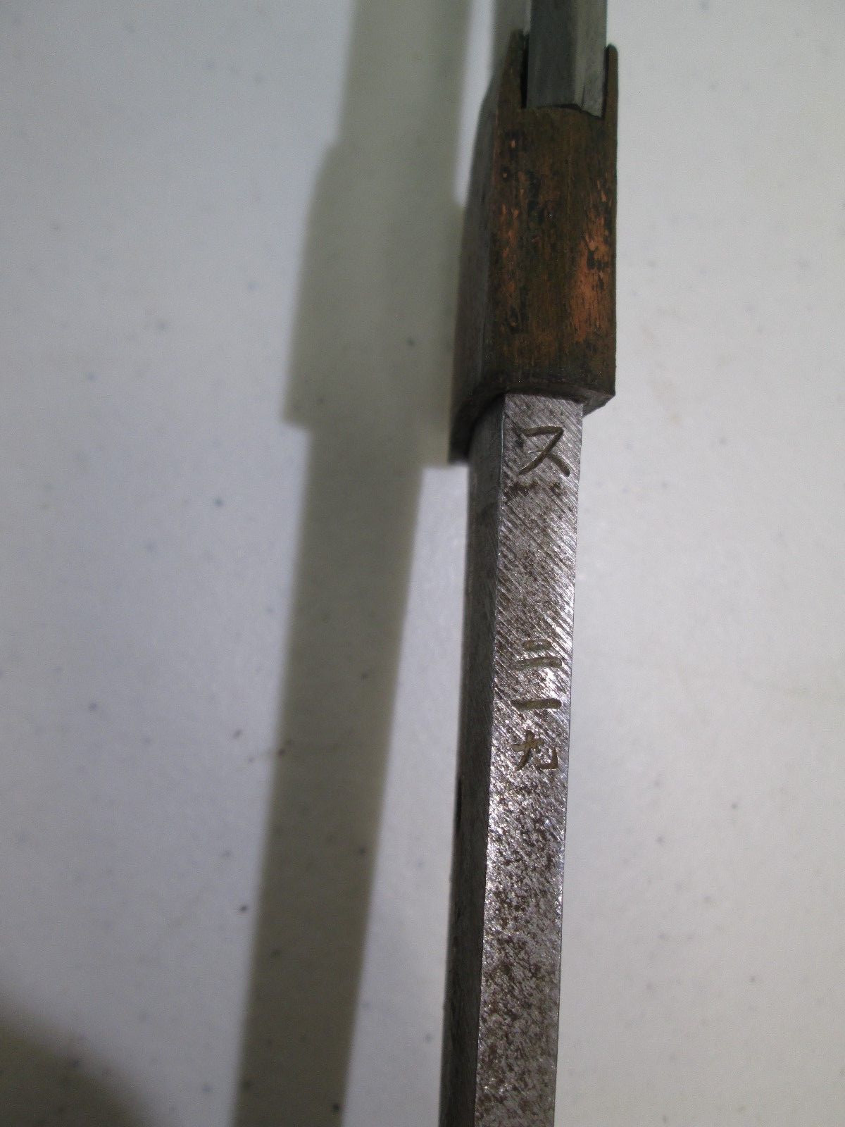

Bill's late war type 3 Spg '44 Mnatetsu(Se 一一四三1143) also flat nakago mune. And Another Late war Type 3 Spg '44 Mantetsu (スSu 二一九)219 )I found out has same  flat nakago mune as well.
So,I guess maybe the flat nakago mune was only for Mantetsu in  late war Type 3 mount?

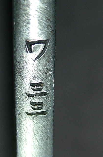

Update:

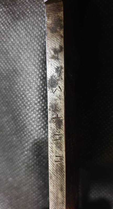

Another unexpected development! I started finding serial numbers marked with kanji that didn't fit the katakana very well. Turns out they are HIRAGANA!! The Japanese-fluent will have to forgive me, but I didn't even know about hiragana. As it was explained to me, katakana are for "foreign" sounds, while hiragana are Japanese sounds. Hiragana are recognizable (to me) in that they appear to be written in a fluid "script" like style, while the katakana are blocky "print" style, in English terms.
I've included a picture of one. It's a hiragana "To", which has a resemblance to the katakana "To". I'm not sure how this affects my efforts to identify a methodological pattern to the numbering of blades. We will see .....

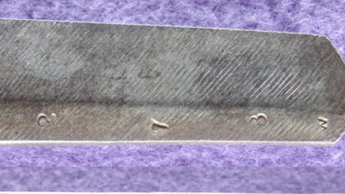

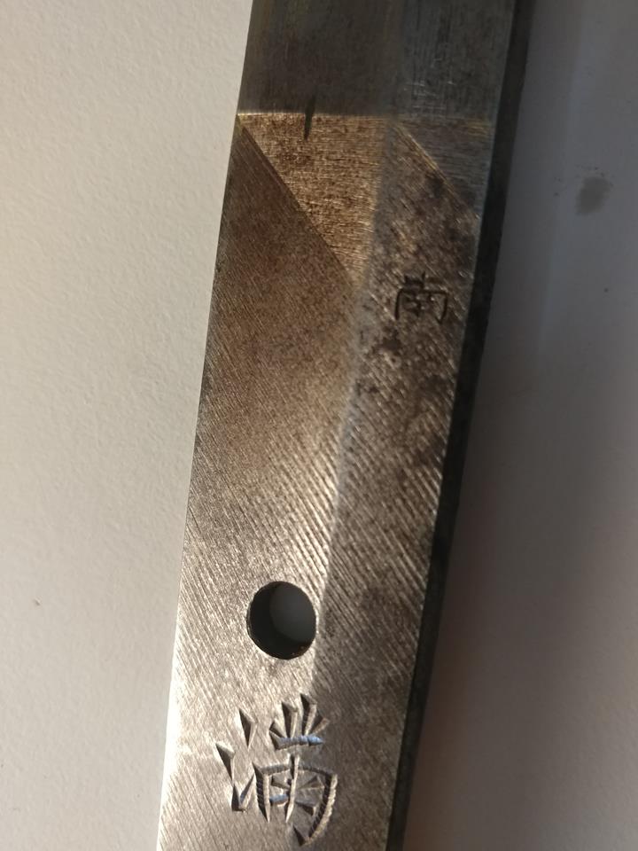

Ok, a MAJOR discovery! It's discussed in full on this thread http://www.militaria.co.za/nmb/topic/27137-very-unusual-konan-essei-mantetsu/, but I want to add it here as someone may only come across this thread in a google search.
I have found a Spring 1945 Mantetsu blade with a different slogan "Kou-nan Issei". It isn't marked with the usual Mantetsu made this logo, but the workmanship, kanji style, and mune serial number all say "MANTETSU". The owner also has info/evidence that this was made for only "a few" upper level commanders toward the end of the war. I'm writing to him about that evidence. Hopefully he'll let us know.
The serial number is unusual in that it has both a hiragana and katakana kanji before the number "22".
It is "I Na 22"post-3487-0-17171600-1542039597_thumb.jpgpost-3487-0-02581000-1542039618_thumb.jpg
