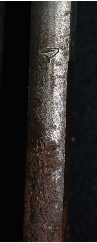

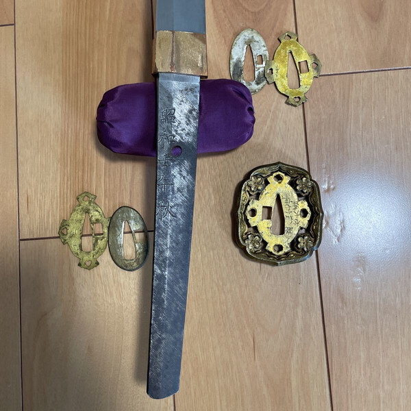

BANGBANGSAN Posted January 24, 2022 Report Posted January 24, 2022 @Bruce Pennington @Kiipu One more from Matt’s shop 昭和壬午秋 1942 Autumn マ 七八 Ma 78,it‘s the first 30 Series マ found so far. Quote
Bruce Pennington Posted January 24, 2022 Author Report Posted January 24, 2022 Thanks Trystan! I actually have it's "sister" Ma 77 on file: 1 Quote
BANGBANGSAN Posted January 24, 2022 Report Posted January 24, 2022 On 1/24/2022 at 10:49 PM, Bruce Pennington said: Thanks Trystan! I actually have it's "sister" Ma 77 on file: Expand I didn't see Ma 77 post on your chart though... Quote

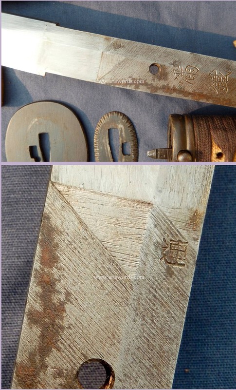

BANGBANGSAN Posted January 27, 2022 Report Posted January 27, 2022 @Bruce Pennington@Kiipu It seems we might found the meaning of 南 and 連/連工 mark .南 means the blade was made in 南満陸軍造兵廠本廠,and the 連/連工means the blade was made in 南満陸軍造兵廠大連製造所軍刀工場. http://ohmura-study.net/205.html From Ohmura 南満陸軍造兵廠は、昭和13年6月「南満工廠建設要綱」が決まり、同年8月、陸軍造兵廠南満工廠※の編成が決定された。 奉天郊外の文官屯に約300万坪の敷地を有し、軍人・軍属12,000名、満人傭工等 数千人の規模だった。此処で将校用軍刀が製造された。 昭和20年4月、兵器行政本部から離れ、関東軍直轄の関東軍造兵廠となった。 製造軍刀の種類; 陸軍将校用軍刀、生産工場: 南満陸軍造兵廠本廠及び南満陸軍造兵廠大連製造所軍刀工場 生産期間 昭和19年10月~20年8月 (実際は昭和18年春より製造されている。たまたま特定期間が記載された事に注意) Quote
Bruce Pennington Posted January 28, 2022 Author Report Posted January 28, 2022 For the vast majority of us who don't read Japanese, what Trystan is showing us is a discussion Ohmura had on that link about the Mantetsu operation. Of the Ren stamp, Ohmura states: Nanman Army Arsenal inspection mark "Nan". inspection mark "Nan".※ Ren stamp: Nanman Army Arsenal Dalian Factory inspection mark. "Ren" Ohmura's discussion: "For Nanman Army Arsenal, organization was determined in August,1938. It had the site of about 9.917 K㎡ in Wenguantun of the Mukden suburbs. And 12,000 persons in all belonged the military man and the army civilian employee to this arsenal. And thousands of Manchu operatives worked. Nanman Arsenal was included in Kantō-Gun and turned into Kantō-Gun Arsenal in April, 1945. From the spring of 1943, an officer's Guntō was made from Nanman Arsenal and Nanman Arsenal Dalian Factory. The blade with the stamp of "Nan" and "Ren" receives the impression that Nanman Army Arsenal made with Mantetsu's introduction of technological know-hows uniquely. However, probably, these blades were dedicated by Nanman Arsenal with semimanufactured goods from Mantetsu, when they were guessed from the Mei of "Mantetsu Kore o Tanzō". The truth is still a mystery. " So, at the end, even Ohmura was uncertain of the implications. My first question is - what is meant by "Nanman Army Arsenal Dalian Factory"? The Nanman Army Arsenal was not located in Dalian. SMR was. So, if they are calling the SMR operation at Dalian a Nanman factory, then the Ren stamped blades were made by SMR not Nanman arsenal. As to Nanman making blades, we know for a fact that they were polishing blades at Nanman in '44 and '45. Is that because they were making the blades there, or because SMR was sending them unfinished blades as they were doing for Tokyo 1st Arnsenal? Not all '43 and '44 blades have the stamps. Why? Were the non-stamped blades made at SMR and the stamped ones at Nanman? Another factor is that the Nan-stamped blades were all in '43 and the first two lines of '44, then they stop, and the Ren stamp appears after that: If the Ren-stamped blades were made in Dalian (SMR), why did the Nanman arsenal (Nan stamps) stop? In the end we may find that Ohmura's hypothesis is correct and logical explanations will appear answering the questions. But for now, my speculative opinion is that SMR was making blades the whole time. In '43, they taught Nanman smiths how to make Mantetsu blades and their production enhanced the quotas required of SMR. The Army likely assigned Nanman Arsenal supervisory authority over the whole SMR operation and the Nan stamp was in use. By '44, they established an office to specifically oversee the Dalian factory, hence the Ren stamp. It still doesn't explain why the Nan stamp disappeared after the appearance of the Ren stamp though. So, like Ohmura said, it's still a mystery to me. 1 Quote
BANGBANGSAN Posted January 28, 2022 Report Posted January 28, 2022 On 1/28/2022 at 3:53 AM, Bruce Pennington said: For the vast majority of us who don't read Japanese, what Trystan is showing us is a discussion Ohmura had on that link about the Mantetsu operation. Of the Ren stamp, Ohmura states: Nanman Army Arsenal inspection mark "Nan". inspection mark "Nan".※ Ren stamp: Nanman Army Arsenal Dalian Factory inspection mark. "Ren" Ohmura's discussion: "For Nanman Army Arsenal, organization was determined in August,1938. It had the site of about 9.917 K㎡ in Wenguantun of the Mukden suburbs. And 12,000 persons in all belonged the military man and the army civilian employee to this arsenal. And thousands of Manchu operatives worked. Nanman Arsenal was included in Kantō-Gun and turned into Kantō-Gun Arsenal in April, 1945. From the spring of 1943, an officer's Guntō was made from Nanman Arsenal and Nanman Arsenal Dalian Factory. The blade with the stamp of "Nan" and "Ren" receives the impression that Nanman Army Arsenal made with Mantetsu's introduction of technological know-hows uniquely. However, probably, these blades were dedicated by Nanman Arsenal with semimanufactured goods from Mantetsu, when they were guessed from the Mei of "Mantetsu Kore o Tanzō". The truth is still a mystery. " So, at the end, even Ohmura was uncertain of the implications. My first question is - what is meant by "Nanman Army Arsenal Dalian Factory"? Expand 南」 南満陸軍造兵廠 "Nan" Nanman Army Arsenal 「連」 南満陸軍造兵廠大連製造所 "Ren" Nanman Army Arsenal Dalian Factory. It seems 関東軍 made some changes after took over 南満陸軍造兵廠 on April 1944. MRS fitting Mantetsu all have the 連 連工 mark. 1)工程: 刀身 ; 満鉄撫順製鉄所製純鉄を心棒として高炭素鋼の筒中に挿入鍜伸、荒砥ぎ、熱処理、仕上げ砥ぎ その他; 外装、鍔付け、握り付け、鞘入れ、刀緒付け 1) Process: Sword blade; Inserted into a high carbon steel cylinder using pure iron manufactured by Mantetsu Fushun Steel Works as a mandrel. Others; fitting, Tsuba, Tsuka, scabbard, sword tassel They only mention the inserted steel was from Fushun Steel Works, but not say if the 皮鉄(outer steel?) are the same. If they use different 皮鉄 then the blade is not the same as earlier Mantetsu. 1 1 Quote

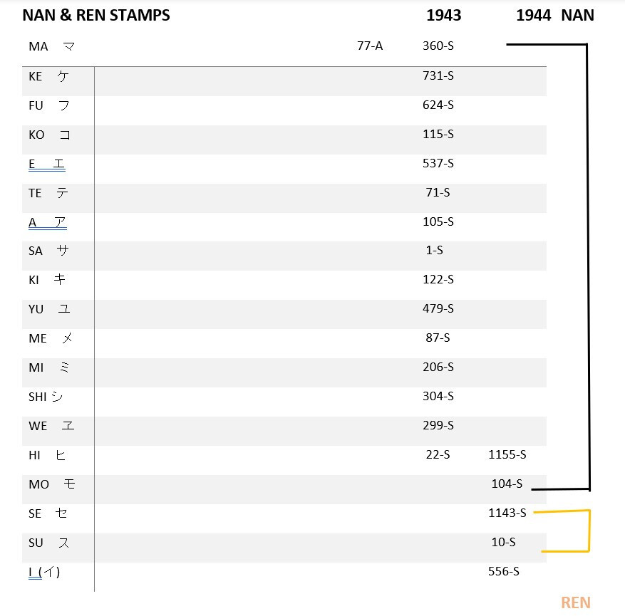

Bruce Pennington Posted January 28, 2022 Author Report Posted January 28, 2022 On 1/28/2022 at 4:35 AM, BANGBANGSAN said: It seems 関東軍 made some changes after took over 南満陸軍造兵廠 on April 1944. MRS fitting Mantetsu all have the 連 連工 mark. Expand Interesting observation. There was definitely a transition. Here are the MRS gunto I have on file 1938 N156 (only the SMR logo) 1944 Se 1029 Ren at top of nakago 1944 Se 1143 Ren at top 1944 Se 1310 Ren at top 1944 Se 2430 連工 1944 Se 2575 連工 1944 Su 10 連工 1944 (?) 199 連工 1945 い 142 (not viewed, no full photo) 1945 い 1170 no stamps, full views 1 Quote
BANGBANGSAN Posted January 28, 2022 Report Posted January 28, 2022 On 1/28/2022 at 1:50 PM, Bruce Pennington said: Interesting observation. There was definitely a transition. Here are the MRS gunto I have on file 1938 N156 (only the SMR logo) 1944 Se 1029 Ren at top of nakago 1944 Se 1143 Ren at top 1944 Se 1310 Ren at top 1944 Se 2430 連工 1944 Se 2575 連工 1944 Su 10 連工 1944 (?) 199 連工 1945 い 142 (not viewed, no full photo) 1945 い 1170 no stamps, full views Expand My 1944 Se 1066 Also has連 at top 1 Quote
Bruce Pennington Posted January 29, 2022 Author Report Posted January 29, 2022 Right! I was just listing the ones with MRS fittings above. Here are the Ren blades I have on file: 連 1944 セ 1029 1944 セ 1066 1944 セ 1143 1944 セ 1310 Is 1066 in MRS fittings? My photos on file just show the rounded tsuba, but no fittings. Quote
BANGBANGSAN Posted January 29, 2022 Report Posted January 29, 2022 On 1/29/2022 at 2:44 AM, Bruce Pennington said: Right! I was just listing the ones with MRS fittings above. Here are the Ren blades I have on file: 連 1944 セ 1029 1944 セ 1066 1944 セ 1143 1944 セ 1310 Is 1066 in MRS fittings? My photos on file just show the rounded tsuba, but no fittings. Expand Yes,it is in RS mount,I posted it before, here you go. 1 Quote
Bruce Pennington Posted January 29, 2022 Author Report Posted January 29, 2022 On 1/29/2022 at 4:27 AM, BANGBANGSAN said: here you go. Expand Excellent, thanks Trystan! I've updated my files on that one. Quote

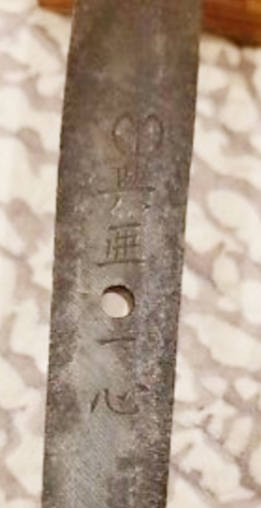

BANGBANGSAN Posted January 30, 2022 Report Posted January 30, 2022 On 1/29/2022 at 2:18 PM, Bruce Pennington said: Excellent, thanks Trystan! I've updated my files on that one. Expand Bruce Here is an unusual one that has wavy Hamon 昭和甲申春 興亞一心 滿鐵作 strangely with NO Ser# on nakago,says in Shirasaya ,but not photo of the mount. 1 Quote
Bruce Pennington Posted January 30, 2022 Author Report Posted January 30, 2022 Yes, I saw that one on ebay a year ago. I have it on file as a "possible fake" because I'm not comfortable with some of the writing, and the lack of number. There are a few wavy blades on file, but they all have numbers. Could this one have been a custom order? If so, it might explain the more stylish writing. That's why I haven't totally ruled it out of the survey files. Here is the photo of the shirasaya: I also have a '39 Koa that was cut down to a waki with no number. So, this one could be legit, and a custom order, maybe. Here's the waki: Quote

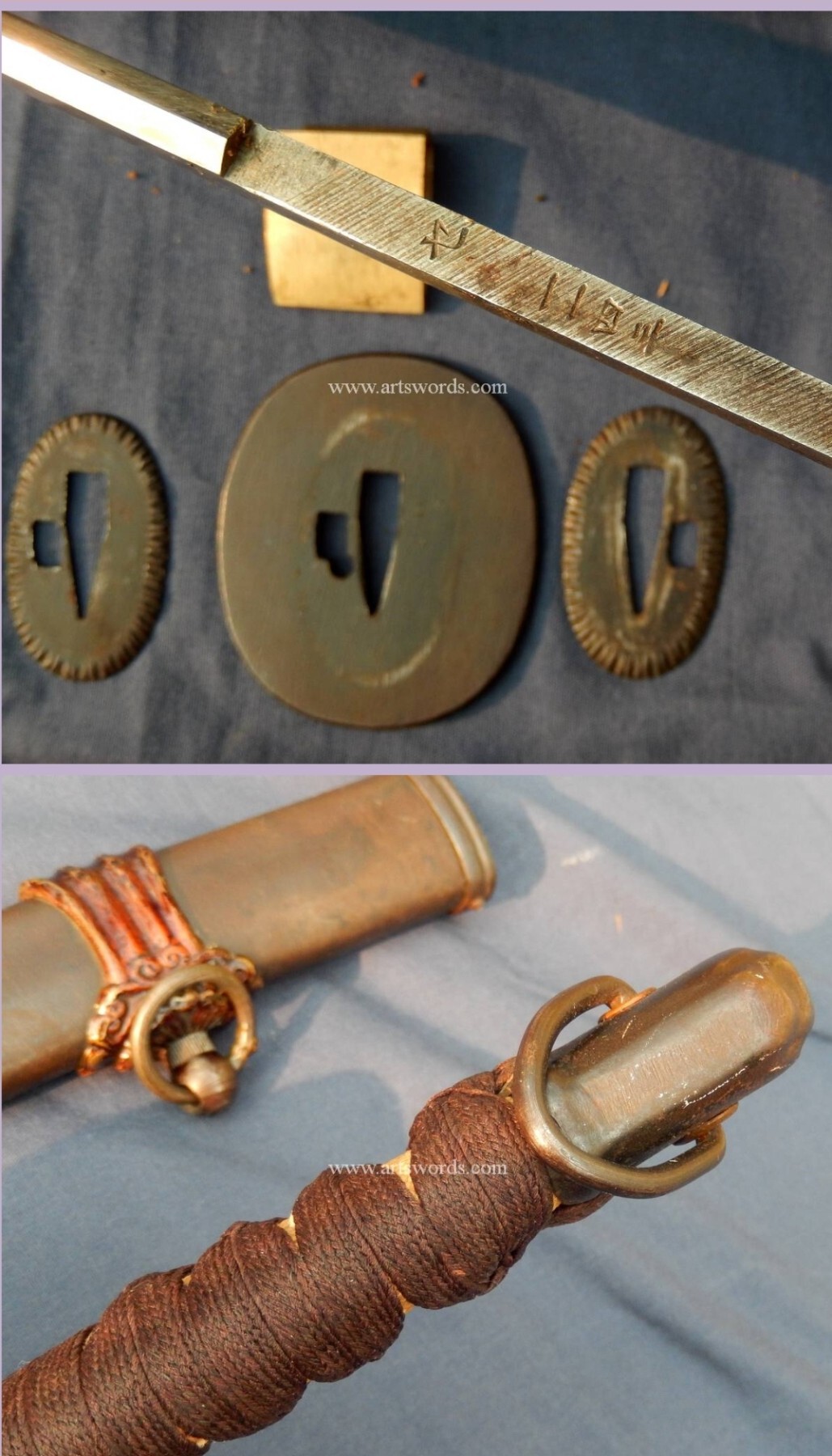

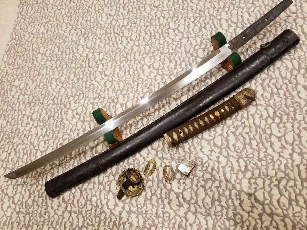

waljamada Posted February 9, 2022 Report Posted February 9, 2022 https://www.artswords.com/one_of_the_rarest_imperial_japanese_late_type_44_gunto_090718.htm Hopefully not a repost but a Mantetsu blade with a stamp in interesting type 3 mounts I haven't seen before. Quote
IJASWORDS Posted February 9, 2022 Report Posted February 9, 2022 Hi Adam, well spotted. Here are 2 of mine with Mantetsu blades. They are not Japanese made, but both the blade and Koshirae were made in China by the then Japanese controlled Manchurian Railway Company. Collectors now call them MRS swords. They are extremely rare with around a dozen documented. Both blades and Koshirae were made there from 1938. It is likely these swords were issued to the occupying Japanese troops in the freezing Manchurua province. The blades all have a nice MEI. and MUNE stamps. These swords never made it to the Pacific War, hence none surrendered or captured. Nor are there surrender photos. For a long time, they wrongly referred to as Type 3 prototypes, or home defense swords. 3 Quote
waljamada Posted February 9, 2022 Report Posted February 9, 2022 Neil, love seeing the niche blades and learning the history behind them. A very interesting pocket of the Mantetsu blades and love that they have a unique look to signify their historical place/time. Quote
