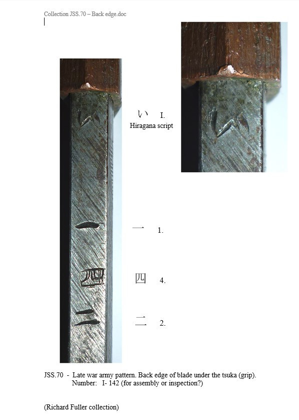

Kiipu Posted October 7, 2021 Report Posted October 7, 2021 A possible 49th series Mantetsu, serial number い 二八. info about first aquisition Attention @IJASWORDS 1 Quote
Bruce Pennington Posted October 8, 2021 Author Report Posted October 8, 2021 Thomas, Thank you! I wonder why I missed that one in my scouring of the forums for Mantetsu? Maybe at the time I was thrown off by the fact that it was mumei and didn't understand the significance of the serial number. At any rate, as I posted on his thread, here are our updated known 1945 serial numbers: い 28 mumei (Steeve) い 67 Konan Essei (from a book with a Diary citation) い 90 Konan Essei (from a book with a Diary citation) い 213 Konan Essei (from a book with a Diary citation) い 289 Konan Essei (from a book with a Diary citation) い 449 Konan Essei (from a book with a Diary citation) い 622 Konan Essei (Beng Shua Collection) い 1170 mumei (NGF Collection) There is one on page 82 of Richard Fuller's Japanese Military and Civil Swords and Dirks book, that I'm sure is a '45. I just wrote to him in hopes that he still has the gunto and can send a serial number to confirm. 1 Quote

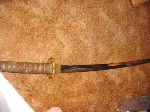

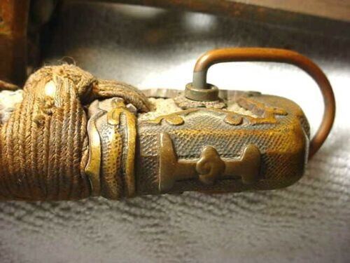

Bruce Pennington Posted October 12, 2021 Author Report Posted October 12, 2021 Bingo! Richard's mumei blade in MRS fittings is a Mantetsu! Serial number い 142. Odd that it fits in the middle of other numbers that were marked with the Konan Essei slogan. Quote
Bruce Pennington Posted October 12, 2021 Author Report Posted October 12, 2021 Which makes the 1945 list: い 28 mumei (Steeve) MRS fittings い 67 Konan Essei (from a book with a Diary citation) い 90 Konan Essei (from a book with a Diary citation) い 142 mumei (Richard Fuller collection) MRS fittings い 213 Konan Essei (from a book with a Diary citation) い 289 Konan Essei (from a book with a Diary citation) い 449 Konan Essei (from a book with a Diary citation) い 622 Konan Essei (Beng Shua Collection) Type 98 fittings い 1170 mumei (NGF Collection) MRS fittings 1 Quote
Kiipu Posted October 12, 2021 Report Posted October 12, 2021 On 10/12/2021 at 1:49 PM, Bruce Pennington said: Bingo! Richard's mumei blade in MRS fittings is a Mantetsu! Serial number い 142. Odd that it fits in the middle of other numbers that were marked with the Konan Essei slogan. Expand Is this sword, serial number い142, the same as the one pictured in his book that you illustrate at the link below? Attention Mantetsu Owners: A Survey, Page 17 Quote
Bruce Pennington Posted October 12, 2021 Author Report Posted October 12, 2021 Yes, one and the same. Quote

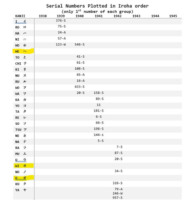

Bruce Pennington Posted December 24, 2021 Author Report Posted December 24, 2021 Thomas - @Kiipu, Got to looking at the 3 unobserved katakana in the Mantetsu lines and realized that one of them is the "HE" also used by the Heijo factory of the Jinsen Arsenal. I'm starting to wonder if it is an intentional omission to avoid confusing the mark on Mantetsu blades from Jinsen Arsenal work. If so, do you think the WI ヰ and O オ are intentional omissions as well? If so, what other uses of the kanji were out there being used, that these would be confused with? 1 Quote
Kiipu Posted December 24, 2021 Report Posted December 24, 2021 All I can say is be patient. There are some series that have only one blade reported. It is important to have clear pictures of the serial numbers just for the reason you give. Many of the katakana can be confused with other katakana characters. While by no means a complete list, below are some examples that can be confused one with another. ホネ チテ ヌスヲラ ワウフ タクケ ノソツシ コユ エヱ And finally, it is that time of year to give a big "Thank You" to all that have contributed a Mantetsu or two to the database. Without you, there would be nothing to work with. A special thanks to Bruce for putting it all together for all to enjoy! 2 Quote
BANGBANGSAN Posted December 24, 2021 Report Posted December 24, 2021 On 12/24/2021 at 2:29 PM, Bruce Pennington said: the "HE" also used by the Heijo factory of the Jinsen Arsenal. I'm starting to wonder if it is an intentional omission to avoid confusing the mark on Mantetsu blades from Jinsen Arsenal work. I like that idea Expand 1 Quote
