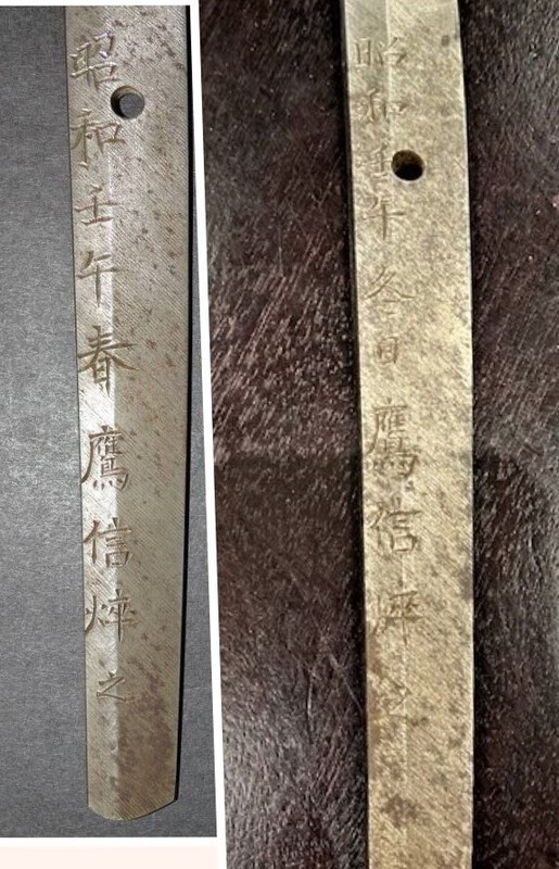

BANGBANGSAN Posted February 3, 2021 Report Posted February 3, 2021 On 12/29/2020 at 6:47 AM, Bruce Pennington said: We have another Mantetsu with the same inscription by Takanobu. It's a Spring '42, where this new one is Winter '42. Expand Bruce According to Ohmura san:「春」銘が多く「秋」銘の刀が少い。「夏」銘を見かけない。 ※2の現物写真で初期満鐵商標刻印の刀身に「冬」銘が確認されている. http://ohmura-study.net/222.html There are many "spring" inscriptions and few "autumn" inscriptions. I don't see the "summer" inscription. The "winter" inscription is confirmed on the blade with the initial Mantetsu trademark engraved in the actual photo of * 2. The winter made Mantetsu only saw on the very early ones.The blade Quenched by Takanobu 鈴木鷹信 might not follow that rule? Quote

Bruce Pennington Posted February 4, 2021 Author Report Posted February 4, 2021 On 2/3/2021 at 9:18 PM, BANGBANGSAN said: The winter made Mantetsu only saw on the very early ones. Expand Trystan, Yes, I only have Winter blades in '38 and '39. So this would be a big exception. The big "BUT" in the room, though, is as a custom made blade, he could have deviated from the norm. It is the same problem we are having with all these potential "custom" blades. All the deviations we see are because they are custom. I've some some comparisons of the latest one with no serial number. It seems to fit almost all aspects of a Mantetsu. My only notable complaint is the "tetsu." It's pretty bad. I found some slight variations on "tetsu" with other blades, but none as bad as this one. Personally, I feel that if the mei cutter is going to mess anything up, it wouldn't be the company name! The seller was told that the blade "might" have been made for the Yasukuni shrine - I doubt the company would have let a blade go to a shrine with their name cut messy. UNLESS, the mei was cut by the smith doing the custom blade, and not by a professional mei cutter. Harumph! too many what ifs. I've filed it in the "Possible Fakes" file of the Mantetsu study. Quote

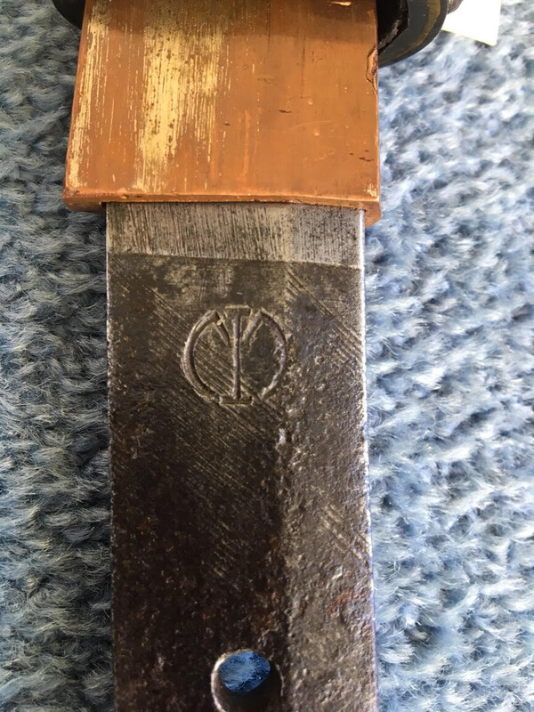

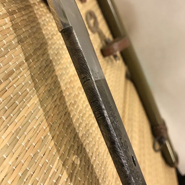

Bruce Pennington Posted February 6, 2021 Author Report Posted February 6, 2021 The seller sent this photo of the nakago mune Quote

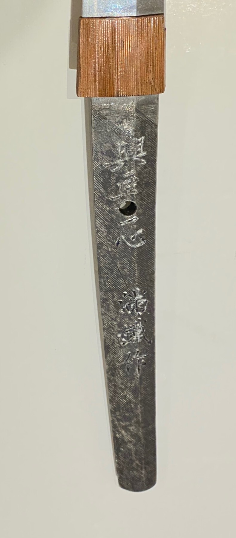

BANGBANGSAN Posted February 17, 2021 Report Posted February 17, 2021 Bruce One more: 昭和壬午秋 興亞一心 滿鐵作 1942 Autumn ク八七八 Ku 878 1 1 Quote
Bruce Pennington Posted February 18, 2021 Author Report Posted February 18, 2021 On 2/17/2021 at 7:34 PM, BANGBANGSAN said: One more Expand Good one Trystan! Thanks! I suppose there's no chance of getting a better view of that mark at the end of the nakago? I could be a "W/M", but can't make it out in that shot. 1 Quote
BANGBANGSAN Posted February 18, 2021 Report Posted February 18, 2021 Unfortunately, no closeup photo for this sword. 1 Quote

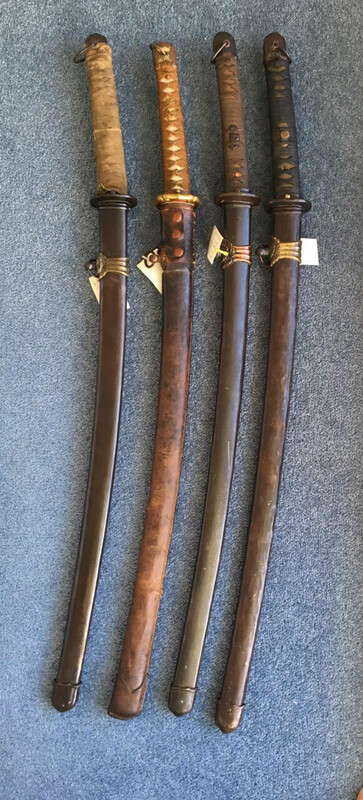

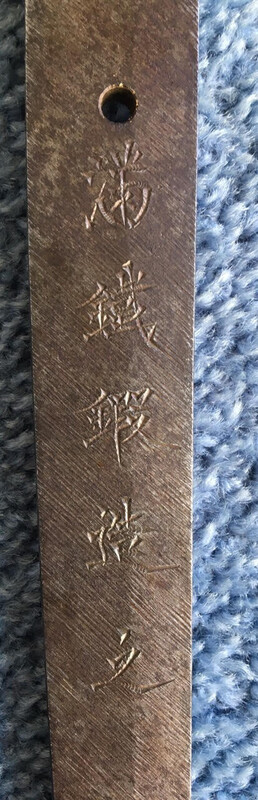

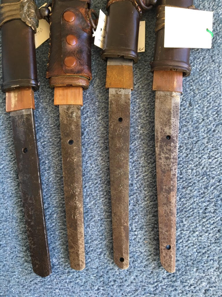

IJASWORDS Posted February 19, 2021 Report Posted February 19, 2021 Thought I would pull together Mantetsu/Koa Isshin swords from 1938 to 1945 inclusive (in date order) , I have the years in-between, but this is to show the variety of Mei. Bruce has the Mune stamps already. The purpose of doing this is to discover what other Mei may exist out there. The 1938 has a Manchurian Railway stamp, right through to the 1945, that only has a Mune stamp. 1 Quote
Bruce Pennington Posted February 19, 2021 Author Report Posted February 19, 2021 Neil, It's amazing to see what a huge brute that '45 is, based on the nakago. Is the blade accordingly larger than the others too? 1 Quote

BANGBANGSAN Posted February 21, 2021 Report Posted February 21, 2021 On 2/19/2021 at 12:56 AM, IJASWORDS said: Thought I would pull together Mantetsu/Koa Isshin swords from 1938 to 1945 inclusive (in date order) , I have the years in-between, but this is to show the variety of Mei. Bruce has the Mune stamps already. The purpose of doing this is to discover what other Mei may exist out there. The 1938 has a Manchurian Railway stamp, right through to the 1945, that only has a Mune stamp. Expand Neil Your 1938 Mantetsu unlike all the other Mantetsu in the same Rinji mount, has only one 目釘穴 instead of two. Also, the other Rinji Mantetsu we saw was all made in 1944 or no year on the tang, we don't see Rinji Mantetsu made in any other years but your 1938. It got me thinking, is it possible an early Mantetsu blade remount later for some reason? Trystan 2 Quote
IJASWORDS Posted February 22, 2021 Report Posted February 22, 2021 Hi Trystan, of course anything is possible, but in the case of the 1938, there is only one hole in the handle as well. And everything fits perfectly. At one time, I had similar thoughts to you, but wondered if the factory was cleaning out its factory of retained samples of blades, and decided to mount them, who knows. I only wish there was more information on this model, in the mean time the detective work continues. By the way Trystan, do you know of any Mantetsu blades in regular Japanese RS (type 3) mounts? 1 Quote
BANGBANGSAN Posted February 22, 2021 Report Posted February 22, 2021 On 2/22/2021 at 12:29 AM, IJASWORDS said: Hi Trystan, of course anything is possible, but in the case of the 1938, there is only one hole in the handle as well. And everything fits perfectly. At one time, I had similar thoughts to you, but wondered if the factory was cleaning out its factory of retained samples of blades, and decided to mount them, who knows. I only wish there was more information on this model, in the mean time the detective work continues. By the way Trystan, do you know of any Mantetsu blades in regular Japanese RS (type 3) mounts? Expand Not sure why ,my 2 Rinji Mantetsu both have 2 holes on the tang , but one hole on the handle, I think your other 2 maybe the same. I never saw Mantetsu in regular Type 3 mount. 1 Quote

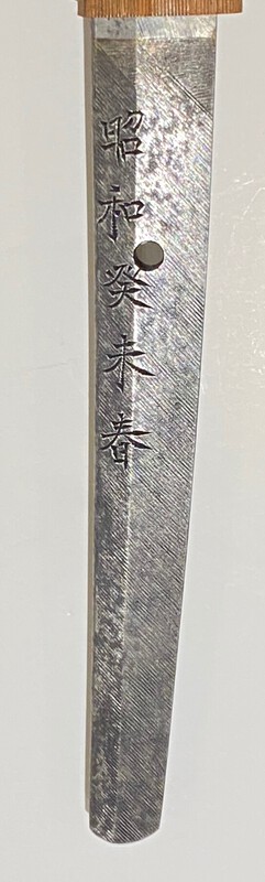

Moley Posted April 15, 2021 Report Posted April 15, 2021 Hi Bruce, Are you still doing the survey and compiling the chart ? If so here are details of my Mantetsu. Shona Mizunoto Hitsuji (Spring 1943 ) Serial Number Yu 432 Gwyn Quote
Bruce Pennington Posted April 15, 2021 Author Report Posted April 15, 2021 On 4/15/2021 at 4:33 PM, Moley said: Hi Bruce, Are you still doing the survey and compiling the chart ? If so here are details of my Mantetsu. Shona Mizunoto Hitsuji (Spring 1943 ) Serial Number Yu 432 Gwyn Expand You bet I am! Thanks Gwyn. I could use pics of both sides of the nakago too. I like a shot or 2 if the fittings as well. There has been some interest in tracking them to see if we can figure out whether SMR, or local shops, or Tokyo shops were doing the fittings. Quote

Bruce Pennington Posted April 15, 2021 Author Report Posted April 15, 2021 On 4/15/2021 at 5:09 PM, Moley said: Here you go Bruce. Expand Those are perfect, Thanks Gwyn! Quote

Kiipu Posted April 15, 2021 Report Posted April 15, 2021 On 4/15/2021 at 4:33 PM, Moley said: If so here are details of my Mantetsu. Shona Mizunoto Hitsuji (Spring 1943 ) Serial Number Yu 432 Expand This is the first commercial 39th (ユ) series to surface. The 39th series low is YU 115 and the high is YU 543. Of the six reported, three are army contracts, two are unknown, and one is commercial. What are the fittings for your sword: Type 94, 97, 98, 100, CV, SS, or SMR? 四三二 = YU 432 昭和癸未春 = Spring 1943.six report, 興亜一心 = Kōa Isshin. 満鐵作 = Mantetsu saku = Made by SMR. Quote
Bruce Pennington Posted April 16, 2021 Author Report Posted April 16, 2021 On 4/15/2021 at 9:32 PM, Kiipu said: army contracts, two are unknown, and one is commercial. Expand Thomas, I'm not used to this terminology. Are you referring to the fittings - IJA fittings vs civil fittings? Quote
