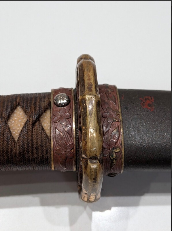

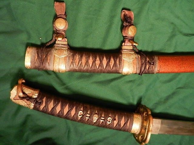

No Clue Posted December 18, 2020 Report Posted December 18, 2020 BTW- The tsuba is 3/8 inches thick. Also, read something about origami... would or could this sword qualify? I'm kind of thinking No... Quote
Bruce Pennington Posted December 19, 2020 Author Report Posted December 19, 2020 (edited) Nikki, I've attached an origami for you: Sorry! Couldn't resist that one! Ha! If you mean that it could receive papers from Shinsa, we do know that Mantetsu blades are starting to get papered. It's at the "historical value" rating. As to fixing up your gunto, you aren't being specific. Do you mean a blade polish? I had mine polished by David Hofhine. It costs over $2,000, so you'll need a good hobby-fund account, but it's worth it. Oh, and the wait-list is about 2 years. For the tsuka (handle) re-wrap, there are a number of guys, and someone might have a good recommendation. I've never dealt with it. I believe Fred Lohman does it, but there are others too. If you try Lohman, use the phone number. I never get an answer to email from them. Edited December 19, 2020 by Bruce Pennington 1 1 Quote

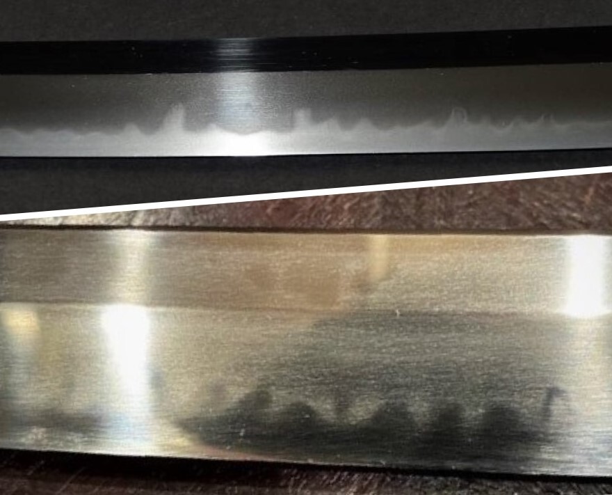

No Clue Posted December 19, 2020 Report Posted December 19, 2020 LOL! I love it ! It definitely needs polish, but blade has a couple rough spots on cutting edge and of course the tsuka. Two year wait ?! Historical value means more to me than dollar value. I don't have to sell it but stupid for me to keep it, if I can find the best home for it whether it be a private collector or museum.... Especially for Historical reasons. Quote
No Clue Posted December 19, 2020 Report Posted December 19, 2020 WOW!!!! What a difference on pre and post polished. Quote

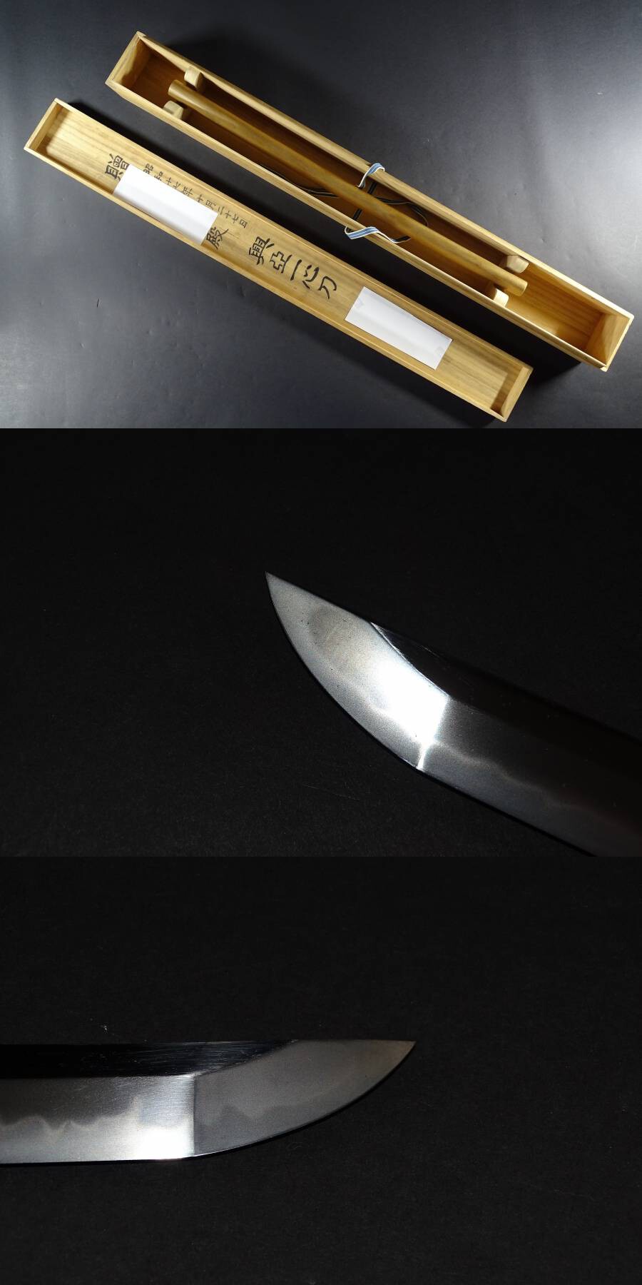

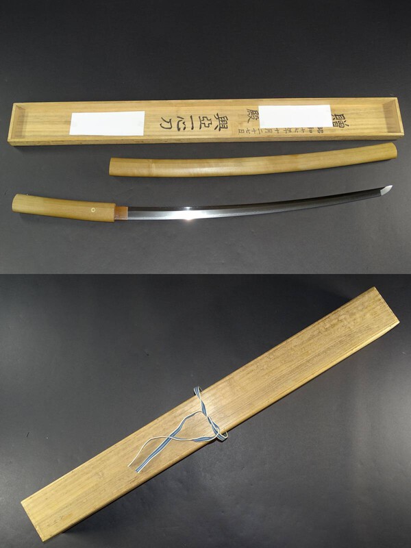

PNSSHOGUN Posted December 29, 2020 Report Posted December 29, 2020 A fake, or real? IMO one of the high end fakes. https://buyee.jp/item/yahoo/auction/v772567074/detail Quote
b.hennick Posted December 29, 2020 Report Posted December 29, 2020 I'm not sure about the blade. I do like the box! 1 Quote
Bruce Pennington Posted December 29, 2020 Author Report Posted December 29, 2020 3 hours ago, PNSSHOGUN said: A fake, or real? IMO one of the high end fakes. https://buyee.jp/item/yahoo/auction/v772567074/detail Posting pics for posterity. Can anyone translate the kanji under the date? Quote
Bruce Pennington Posted December 29, 2020 Author Report Posted December 29, 2020 I requested a photo of the nakago mune. Buyee says they'll forward the request and get back with me. I won't be surprised to find a blade that was a special order. We have seen presentation Mantetsu, and tachi Mantetsu. But we haven't seen a convincing blade with such a hamon yet. Hopefully we'll get a reply on the serial number request. I'd still like to hear what the added comment is under the date. Quote
mecox Posted December 29, 2020 Report Posted December 29, 2020 Date is Showa Mizuno-e Uma Haru Spring (March-April) year of Horse (1942) Below date: Taka Nobu Yaku Kore (Takanobu Yaki-iye Kore) "Takanobu did the yaki-ire" Quote
PNSSHOGUN Posted December 29, 2020 Report Posted December 29, 2020 Look closer at the writing on the box, it is of pretty poor quality, certainly not of a level to be presented in any official capacity. Quote

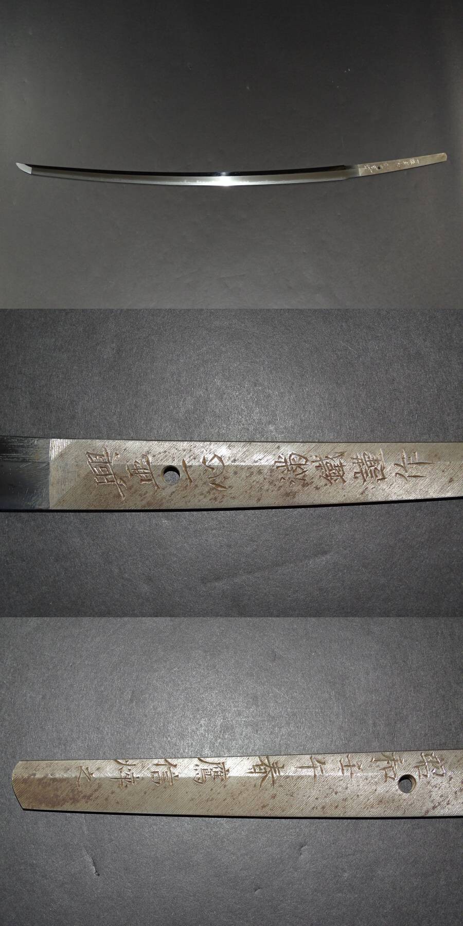

Bruce Pennington Posted December 29, 2020 Author Report Posted December 29, 2020 We have another Mantetsu with the same inscription by Takanobu. It's a Spring '42, where this new one is Winter '42. The mei cutting is different on each, but that could be due to different mei cutters (word for that?). Both have the wavy hamon: Quote
16k Posted December 29, 2020 Report Posted December 29, 2020 What I think is weird about those wavy Hamon is that the Hamon look just like the type of Hamon you’d have on a Seki made blade. It doesn’t necessarily mean they are fake Mantetsu, but I wonder if they were actually made in Manchuria or at the Seki factory. Quote
mecox Posted December 29, 2020 Report Posted December 29, 2020 Bruce that mei cutting on the winter blade looks pretty rough......more like a copy? 1 Quote
Bruce Pennington Posted December 29, 2020 Author Report Posted December 29, 2020 4 hours ago, 16k said: I wonder if they were actually made in Manchuria or at the Seki factory. All we know about Takanobu is that he was the engineer managing the Mantetsu blade production for SMR. Of course this doesn't preclude him from traveling, and working with a smith in Seki to try his hand at some of the craft, but it's simply not known. 3 hours ago, mecox said: the winter blade looks pretty rough......more like a copy? Yes, oddly, the winter blade mei is the worst I've ever seen on a Mantetsu, while this Spring 1942 mei looks good. The serial number on the W42 is ヤ 246, which is the correct katakana for the year, but the "winter" stands out because all the other "YA" numbers are "Autumn." I got an email back from Buyee, and they simply said "Oh sorry, we see you're not eligible to buy this item. See ya!" and didn't answer my question! Grrrr. I'll try again with more explanation. Quote

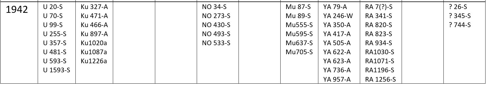

Kiipu Posted December 29, 2020 Report Posted December 29, 2020 Cross reference to the other reported 鷹信焠之. Mantetsu with attribution Attention Mantetsu Owners: A Survey (post #527) 1 Quote
Bruce Pennington Posted December 31, 2020 Author Report Posted December 31, 2020 SO! Thanks to Kelly (Japan auctions), we got word from the seller of the latest, Spring '42, Takanobu blade, that there IS NO serial number! Argggggh. The first one we found, Winter '42, has a serial number that is appropriate for the 1942 year, but the mei is ugly for a Mantetsu (which could be explained by the idea that Takanobu, himself, cut the mei). This latest one has perfect, beautiful Mantetsu styled mei, but no serial number! And both have wavy hamon, not the standard suguha, but you would expect that in a custom blade made by a big-shot in the company that doesn't normally smith blades. Hrumph! The first one, linked above by Thomas, was posted in 2009, quite a few years before we started seeing suspect Mantetsu blades coming out of Japan. So, to me, the evidence tilts toward legit. This second one comes out in the gimei Mantetsu age, with great mei, but no serial number. So, it could be a fake, and the forger missed the detail about the serial number. I just don't picture a gimei forger knowing the Mantetsu operation well enough to say "Gee, let me pick an obscure, almost unknown engineer in SMR to the collecting world, to create a faked custom blade". Quote

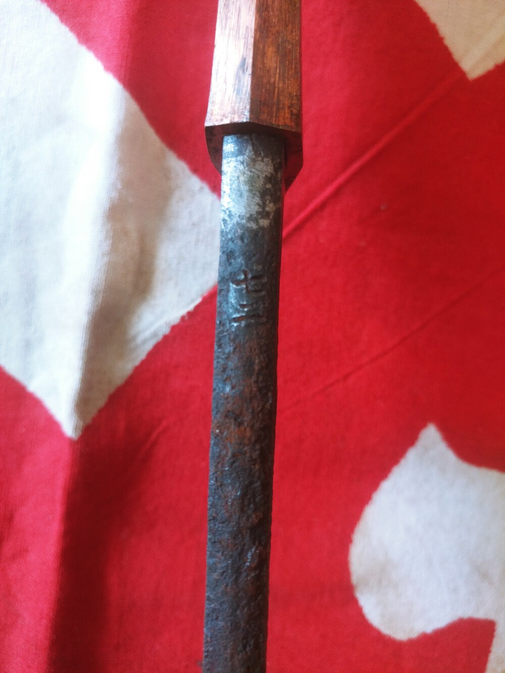

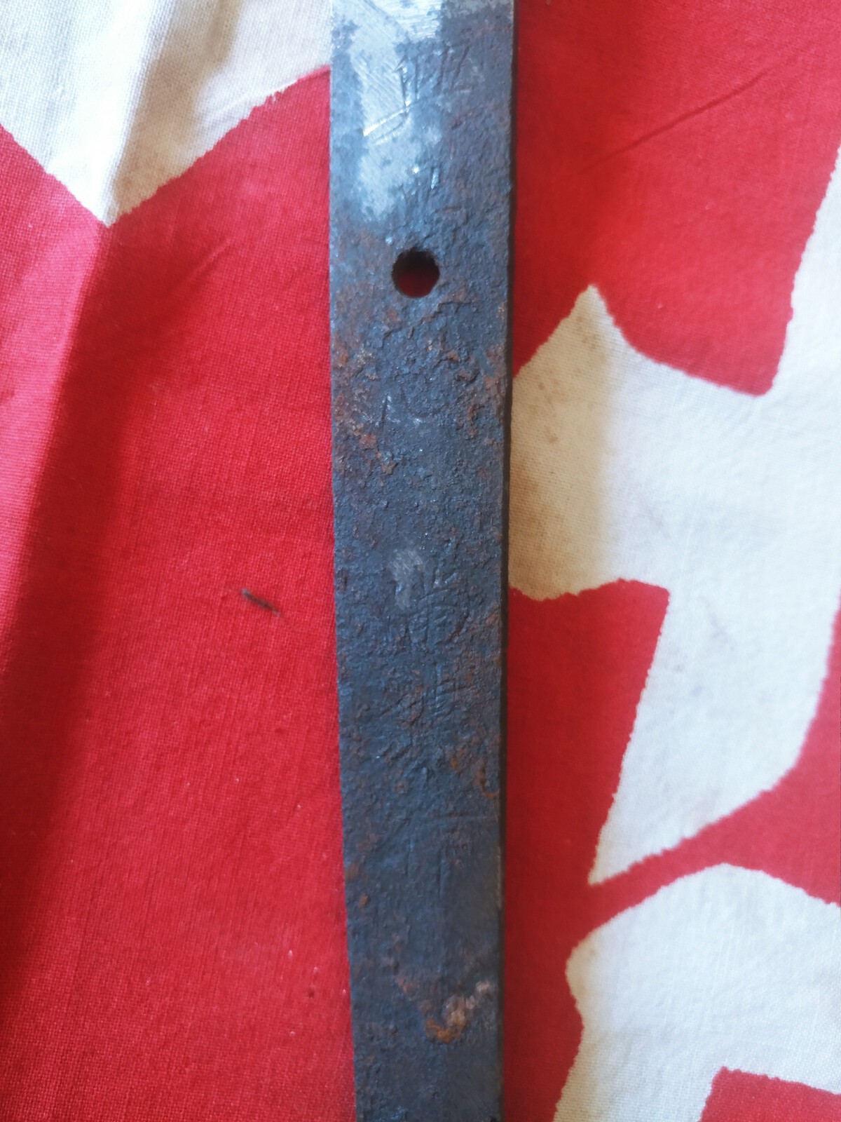

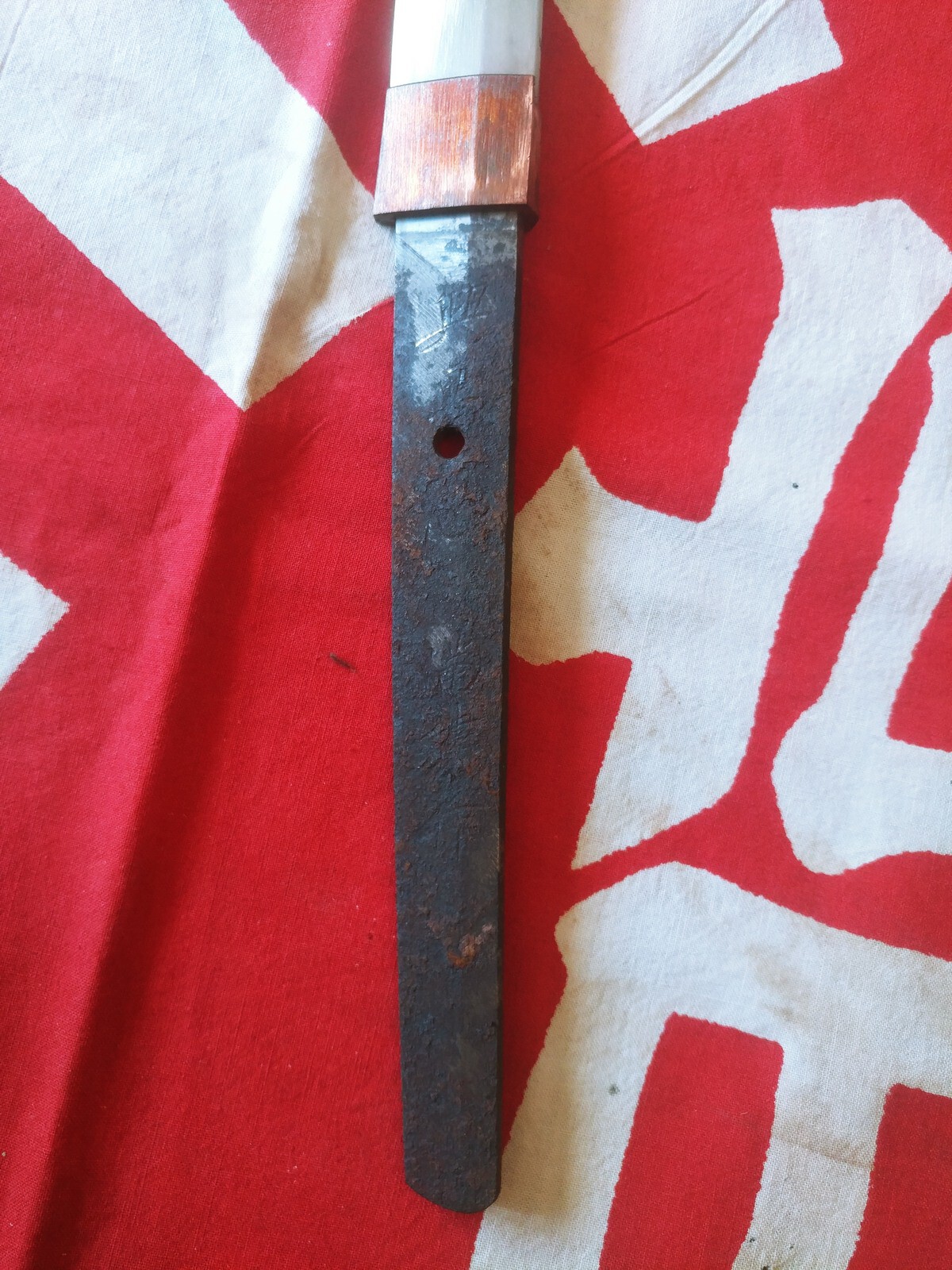

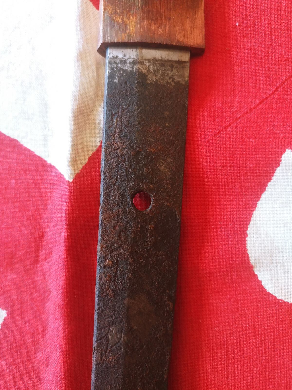

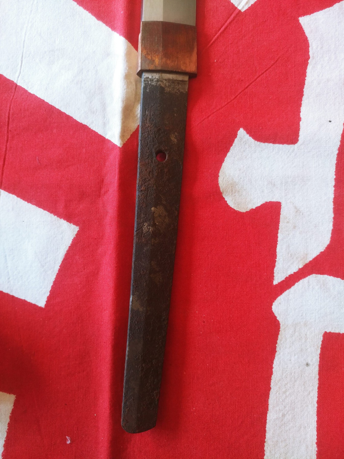

PNSSHOGUN Posted February 3, 2021 Report Posted February 3, 2021 Photos of my Koa Isshin Nakago, Thomas had been able to identify it from the Mune numbers as Spring/Autmun 1942 but I have since cleaned the Nakago of some of the active rust and the date can be read. This is great as it means the numbers check out for dating swords with obscured Nakago! Quote Is this the same sword as reported below? If so, it is serial number ヤ 七二. (YA 72). Attention Mantetsu Owners: A Survey (Post #14) This is a 1942 Army contract blade before they changed the markings in 1943 to 満鐵鍛造之. The fact that it is army can still be determined by the 東 inspection mark on the kabutogane. I carefully looked at the nakago pictures and I can read all of the characters except for one. Reverse: 興亜一心 満鐵作. Obverse: 昭和 午秋 (I can not see the middle character which would be 壬). 1 1 Quote

Bruce Pennington Posted February 3, 2021 Author Report Posted February 3, 2021 7 hours ago, PNSSHOGUN said: Spring/Autmun 1942 Thanks for the pics, John! Yours is the lowest number of the "YA" line, now. We have a YA 79, so yours was 7 blades before it in production. Love the backdrop, too, for the photos. I can see it is for sure "Autumn". Quote

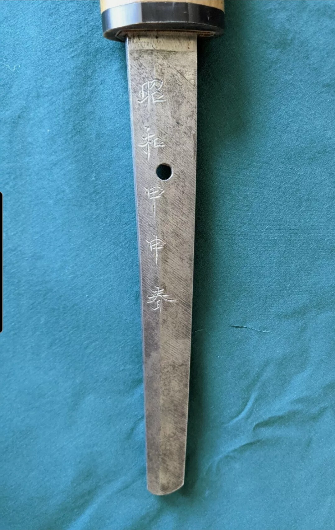

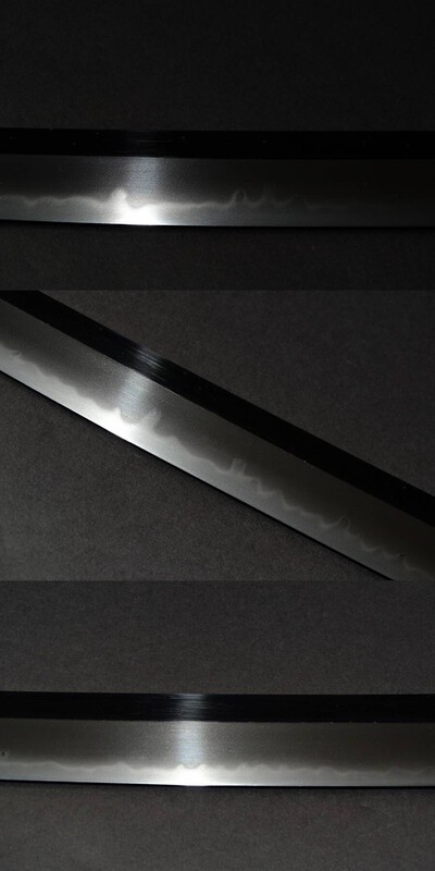

waljamada Posted February 3, 2021 Report Posted February 3, 2021 Another wavy hamon Mantetsu. Kinda odd these are popping up all of a sudden in a clump. Could be its just coming to my attention in a clump and not in general. Also this one has no stamps/number on the back of the nakago. Quote
16k Posted February 3, 2021 Report Posted February 3, 2021 Might be me, but the signature looks off and more recent than the rest of the nakago. And the Hamon looks like a Seki blade. 1 Quote
