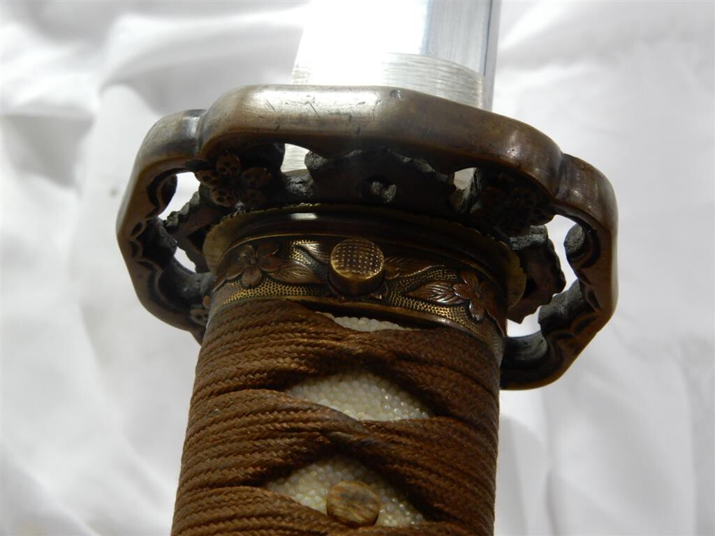

BANGBANGSAN Posted November 18, 2020 Report Posted November 18, 2020 Has anyone noticed early Mantetsu's Pierced Tsuba is thicker than regular Tsuba? What's the difference between early official Mantetsu fitting and later 98 fitting used on Mantetsu? 1 Quote
Bruce Pennington Posted November 18, 2020 Author Report Posted November 18, 2020 16 minutes ago, Bruno said: How many Mantetsu-to have you referenced so far? 216 with full numbers, mei, and date. There would be more, but many pictures found on the web don't show the serial numbers. 1 Quote
PNSSHOGUN Posted November 18, 2020 Report Posted November 18, 2020 @BANGBANGSAN it's an early Type 94 Tsuba, they are considerably thicker than normal. I believe the Koa Isshin swords have their own unique Koshirae makers early on, they have a unique Kabuotgane and Tsuka-Ito. 1 Quote

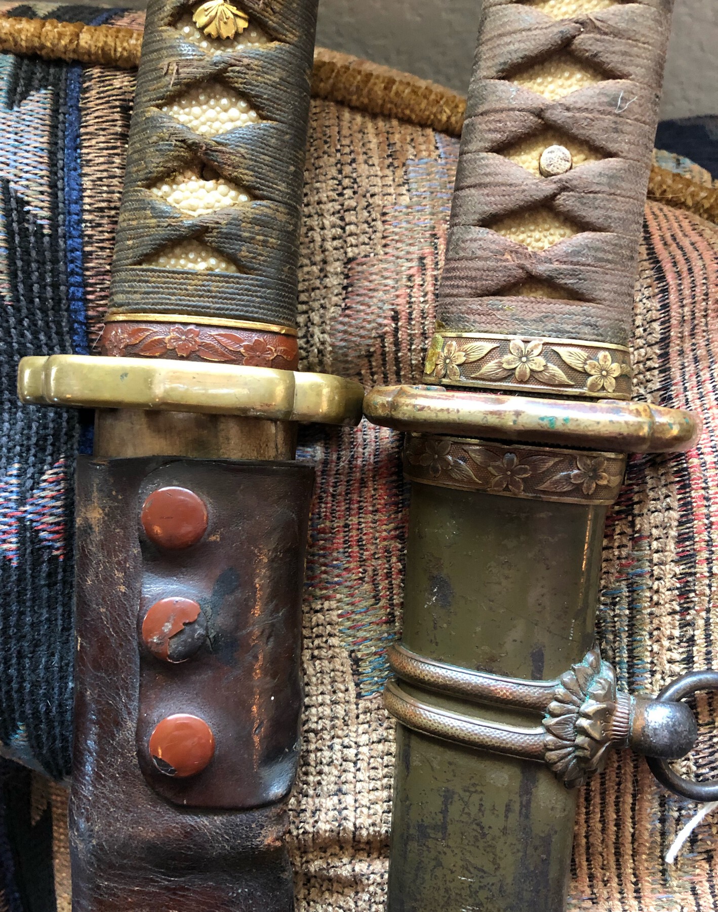

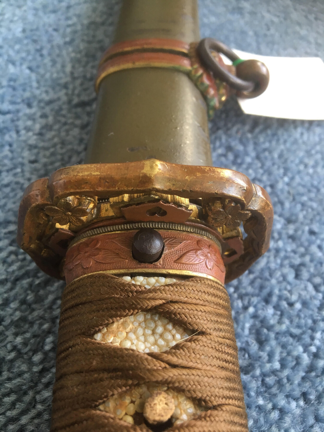

Bruce Pennington Posted November 18, 2020 Author Report Posted November 18, 2020 28 minutes ago, BANGBANGSAN said: early Mantetsu's Pierced Tsuba Wow, Trystan, my '39 Mantetsu has that same exact tsuba! Had to have been the same koshirae shop! My thought was the same as John's on the thickness, but was hoping he'd comment. He's far more knowledgeable on koshirae. Here's mine. Next to my '41 Mantetsu Quote

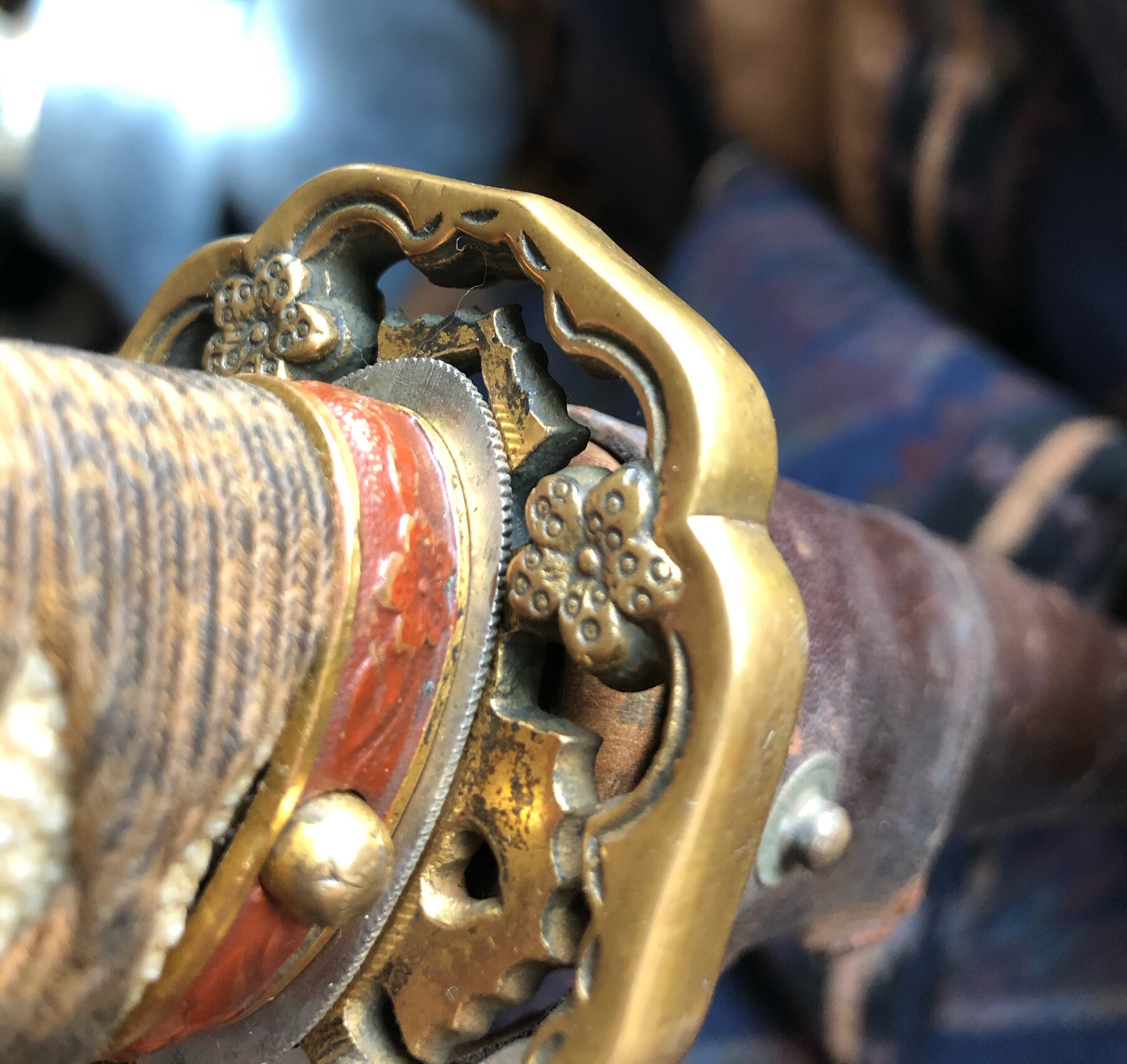

IJASWORDS Posted November 18, 2020 Report Posted November 18, 2020 This 1939 Mantetsu has many of the attributes of a model 94, centre lock etc, it even looks like a second hanger was evident from the paint damage. Quote
Bruce Pennington Posted November 18, 2020 Author Report Posted November 18, 2020 That General's Mantetsu at auction has the same fat tsuba with the identical pattern around the edge-face. Quote

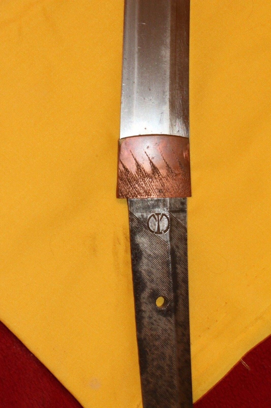

Stephen Posted November 18, 2020 Report Posted November 18, 2020 Went back and looked at all habaki Think they sent you the other sword pix. I may be wrong. Silver on the yasukuni blade Copper on Mantetsu Quote

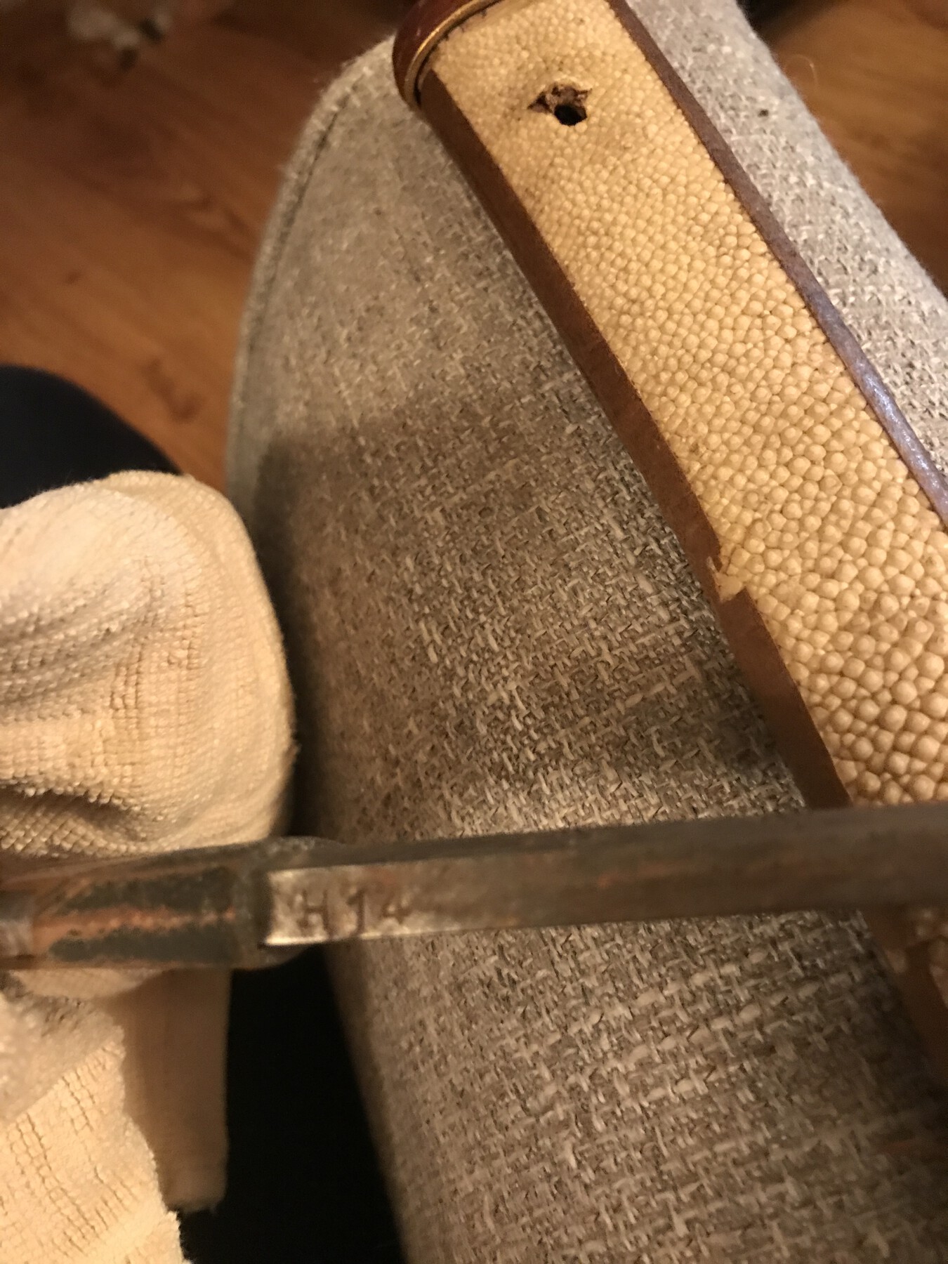

No Clue Posted December 18, 2020 Report Posted December 18, 2020 Hi there! I have been browsing the topic. Very interesting! So, I just posted a few photos of a Mantetsu. Serial Number H14. Seen any others with an "H" ? Quote
No Clue Posted December 18, 2020 Report Posted December 18, 2020 The "H" almost looks like the earlier capital "I" I've seen on these posts regarding the SMR. ( if you look at it the opposite way) Quote
Bruce Pennington Posted December 18, 2020 Author Report Posted December 18, 2020 Nikki, Welcome to Mantetsu World! HA! Your "H" 14 is new to us, and fabulous! Please do me a favor and give us photos of both sides of the full nakago, and it would be great to see the fittings it came in. I'm guessing this should be a 1938. Quote
No Clue Posted December 18, 2020 Report Posted December 18, 2020 I asked for Translation and yes, he said 1938. I'm not sure , due to being a novice, but I will provide any pics I can. I am pretty sure it isn't top notch, but in fair condition. Give me till tomorrow for most of pics as the light is better in daylight. I will try and post some tonight. Quote
Kiipu Posted December 18, 2020 Report Posted December 18, 2020 Your sword in an early Mantetsu, serial number H14, that was made in the second year of production. Production is thought to have started in late 1937. It is fitted out as an army Type 98 Guntō. It looks to have the thick crossguard (tsuba) that BangBangSan has pointed out recently. Your handle is missing a few items but I will let Bruce handle this aspect of the sword. Thank you for sharing information about your sword and here is a link to taking care of it. Japanese SWORD CARE AND ETIQUETTE Links to additional photographs of Mantetsu H14. Read forums, need more, on Manchurian.... I have no idea and need help please in Translation Nakago Mune H14 Nakago Reverse SMR logo Nakago (tang) Obverse 昭和戊寅秋 = 1938 Autumn 1 Quote
