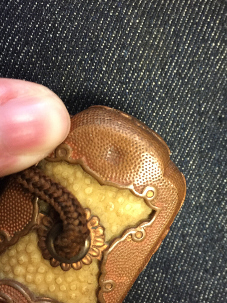

Bruce Pennington Posted September 3, 2020 Author Report Posted September 3, 2020 On 9/2/2020 at 6:18 PM, Kiipu said: Check the kabutogane for a possible 東 inspection mark. Expand Thomas, I hadn't made that connection! Are you seeing the "TO" on the kabutogane of the "M" stamped blades? Quote
Kiipu Posted September 3, 2020 Report Posted September 3, 2020 The combination only shows up on some 1942 Mantetsu blades. I have posted in the past about this. https://www.militaria.co.za/nmb/topic/26165-attention-mantetsu-owners-a-survey/?do=findComment&comment=311598 1 1 Quote

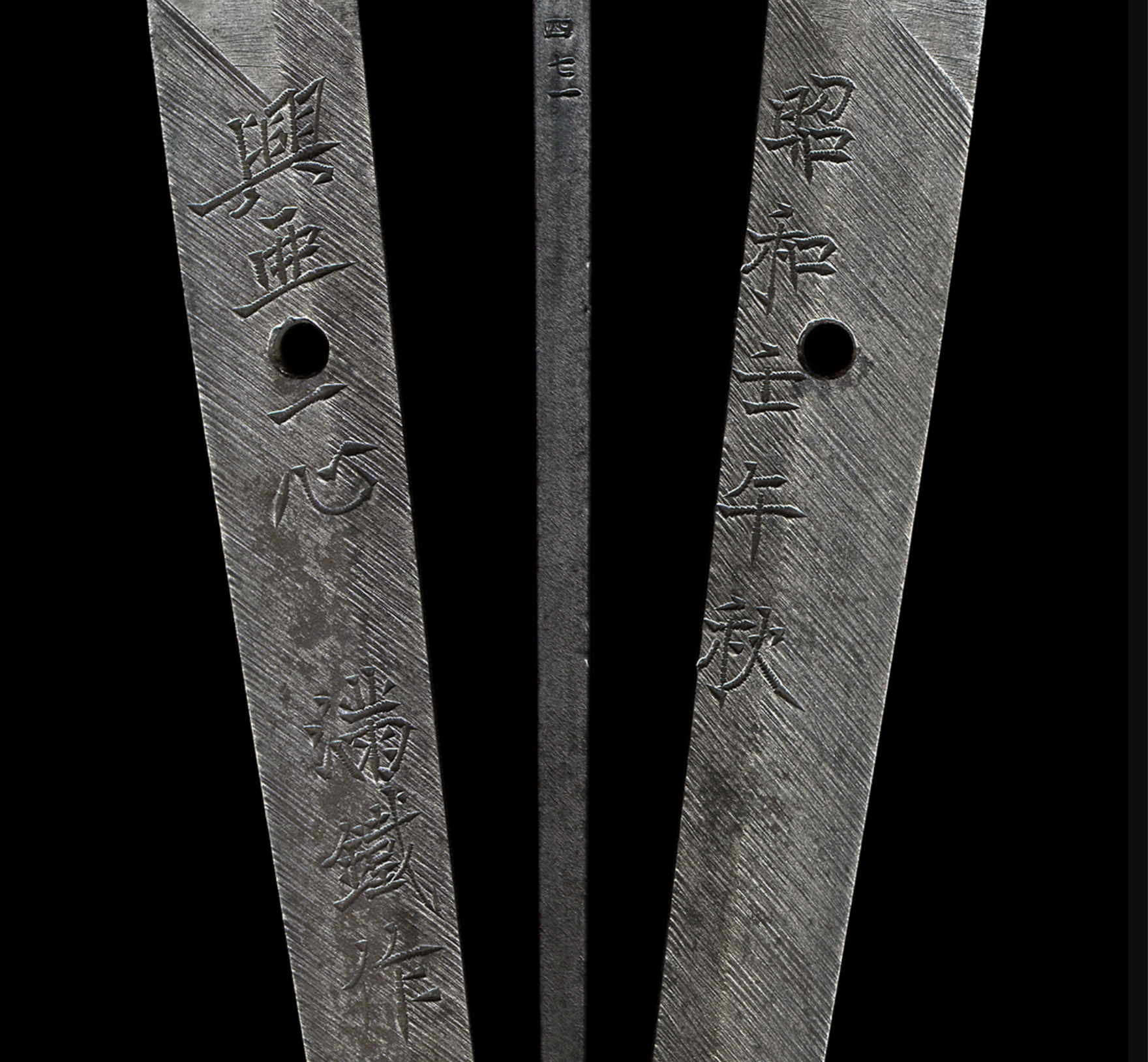

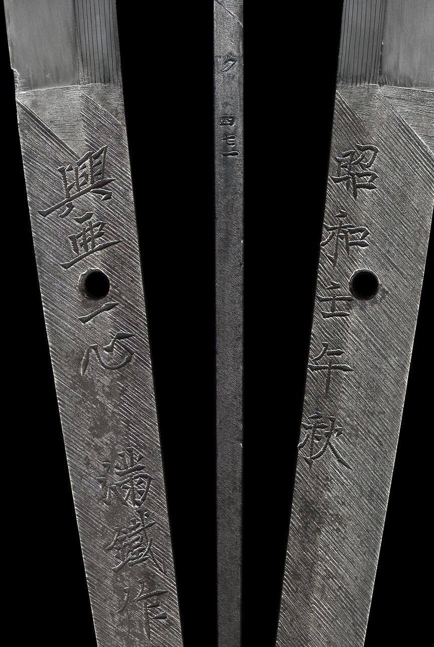

Kiipu Posted November 9, 2020 Report Posted November 9, 2020 28th Series Mantetsu, Early Army Contract. ク 四七一 = KU 471. 昭和壬午秋 = Autumn 1942. M inspection mark along with subassembly number. 満鐵作 = SMR made. 1 Quote
Bruce Pennington Posted November 9, 2020 Author Report Posted November 9, 2020 On 11/9/2020 at 5:22 PM, Kiipu said: ク 四七一 = KU 471. 昭和壬午秋 = Autumn 1942 Expand Got it, thanks Thomas! Quote

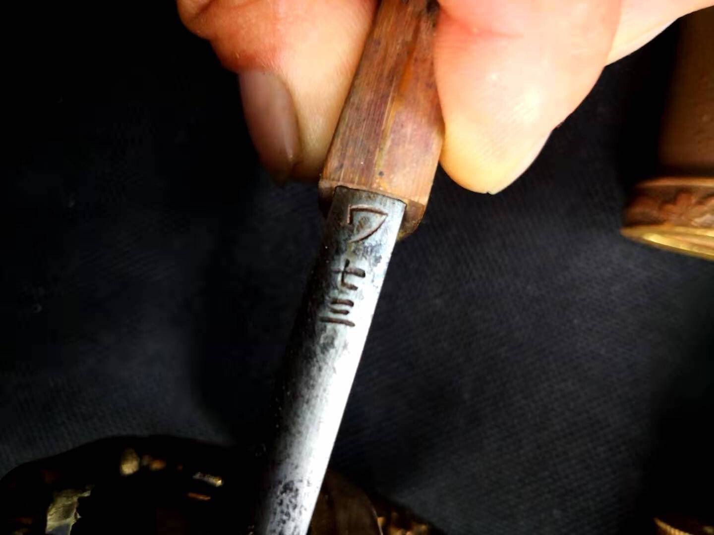

Kiipu Posted November 12, 2020 Report Posted November 12, 2020 (edited) ワ 六 = WA 6 No pictures. http://ohmura-study.net/222.html ワ 一三四 = WA 134. https://www.militaria.co.za/nmb/topic/28631-railway-swords-stamps/?do=findComment&comment=290148 ワ 一五八 = WA 158. https://yakiba.com/Kat_Mantetsu4.htm https://www.militaria.co.za/nmb/topic/26165-attention-mantetsu-owners-a-survey/?do=findComment&comment=265512 Edited November 12, 2020 by Kiipu 1 Quote

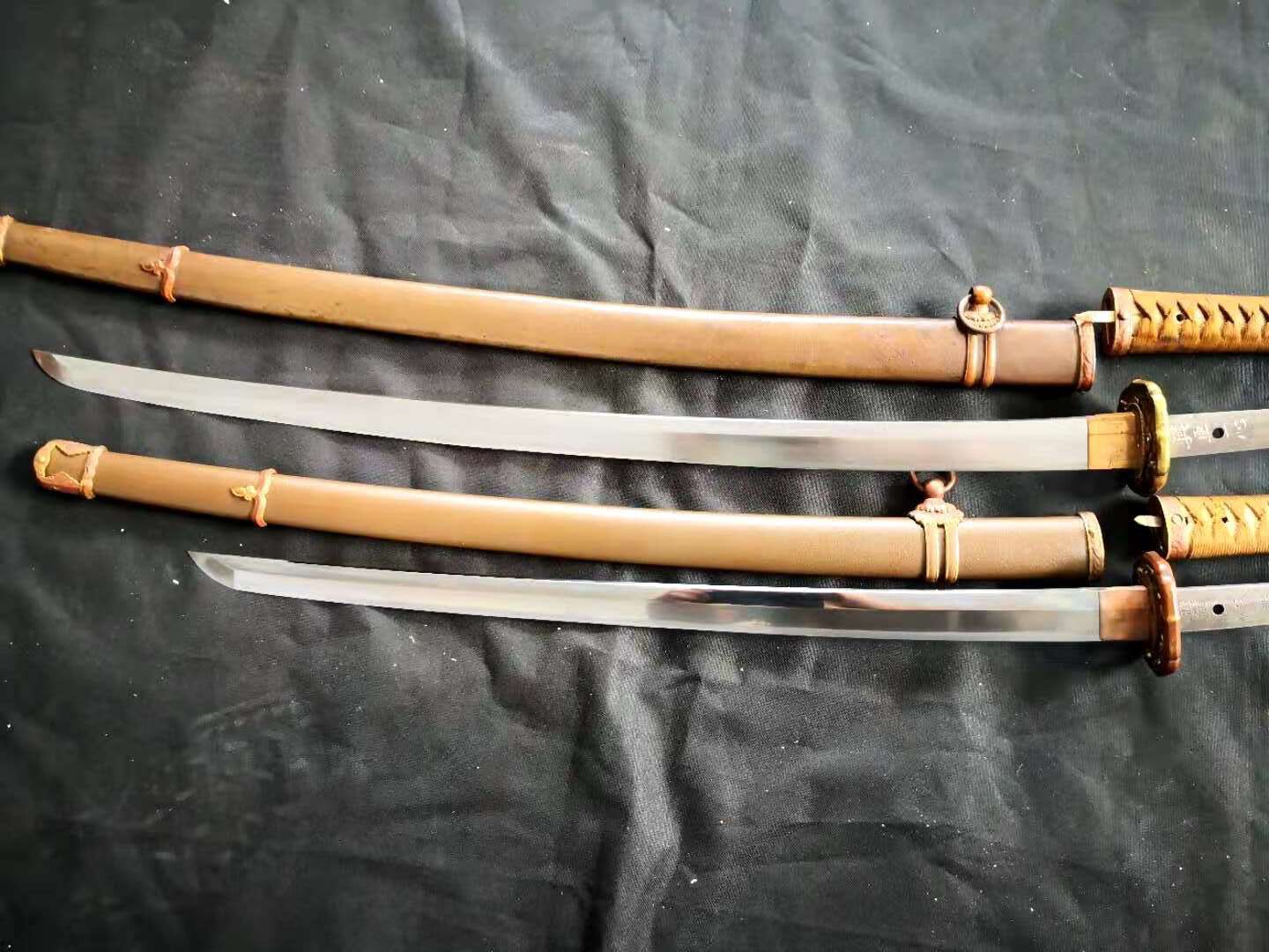

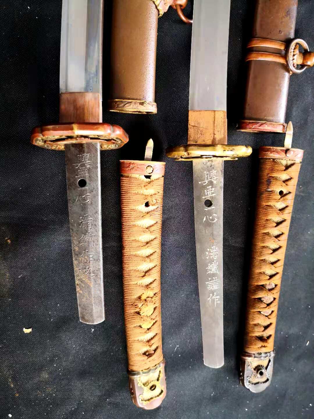

Bruce Pennington Posted November 12, 2020 Author Report Posted November 12, 2020 Thanks Trystan for the new addition! It is the second production waki I have record of and the first one is Autumn 1940 Wa 33! So like, Thomas said, this "line" of production seems to have some experimentation, or custom orders, in it! I don't have pics of the whole waki (33) but here is what I have: Quote
Kiipu Posted November 12, 2020 Report Posted November 12, 2020 Serial number not stated but is looks like it could be ワ 三三? Mantetsu Wakizashi Quote
Bruce Pennington Posted November 12, 2020 Author Report Posted November 12, 2020 Yes, that's the one. The link to the yakiba.com site doesn't work, though. Quote
Bruce Pennington Posted November 12, 2020 Author Report Posted November 12, 2020 On 11/12/2020 at 5:12 PM, Kiipu said: 1941春 ワ 六 Details unknown. 1940秋 ワ 三三 Wakazashi. 1940秋 ワ 七三 Wakazashi Type 98. 1941春 ワ 一三四 SMR Tachi. Expand Thomas, I don't have records of the 6 or 134. Do you a source or photos? Quote
BANGBANGSAN Posted November 12, 2020 Report Posted November 12, 2020 On 11/12/2020 at 7:53 PM, Bruce Pennington said: Thomas, I don't have records of the 6 or 134. Do you a source or photos? Expand Bruce Thomas already post the link ワ 六 = WA 6 No pictures. http://ohmura-study.net/222.html ワ 一三四 = WA 134. https://www.militaria.co.za/nmb/topic/28631-railway-swords-stamps/?do=findComment&comment=290148 ワ 一五八 = WA 158. https://yakiba.com/Kat_Mantetsu4.htm https://www.militaria.co.za/nmb/topic/26165-attention-mantetsu-owners-a-survey/?do=findComment&comment=265512 1 Quote
Bruce Pennington Posted November 12, 2020 Author Report Posted November 12, 2020 On 11/12/2020 at 7:57 PM, BANGBANGSAN said: Bruce Thomas already post the link Expand Thanks again, Trystan. I somehow missed the Wa 6 when I transcribed the Komiya chart, and I had the pics of 134 in my files, but had never entered it in the Word document chart. Now both are logged. Quote
Kiipu Posted November 12, 2020 Report Posted November 12, 2020 Bruce, I updated the post after the fact and that is why you missed it. It took some time to find the Mantetsu 13 series swords that BangBangSan was looking for. Thankfully, Stegel-san reposted those tachi pictures which had serial number ワ 一三四. 1 Quote
