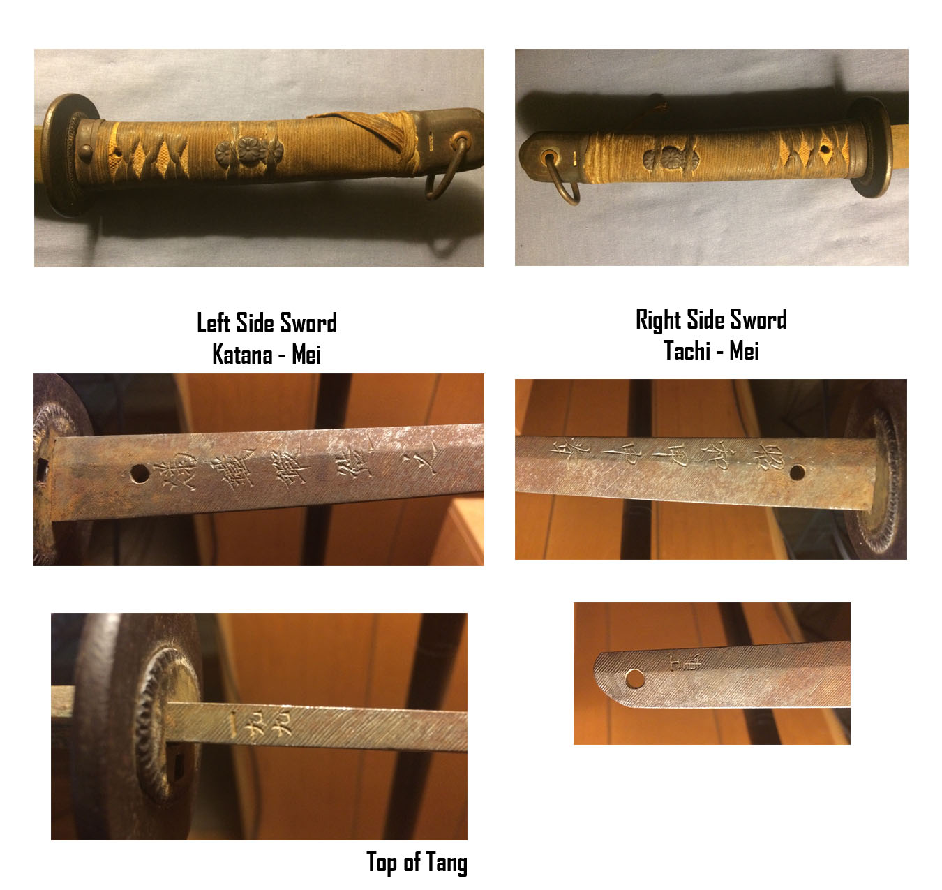

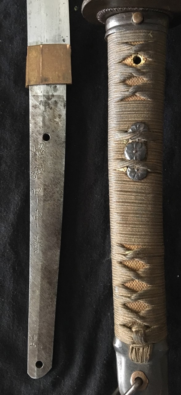

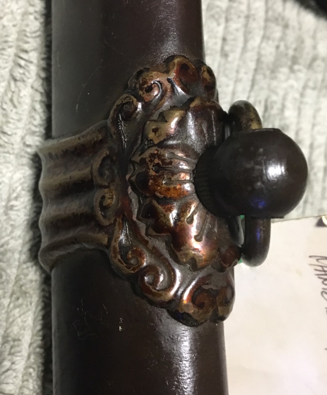

IJASWORDS Posted April 3, 2020 Report Posted April 3, 2020 Here are close ups of the suspension rings.... First one is a Spring 1944 Mantetsu Tanzo Kore, SE2340. Second is the 1945 mumei, I1170. Although late war, the detail is still nice. Note the cherry blossom motif. 1 Quote
Bruce Pennington Posted April 3, 2020 Author Report Posted April 3, 2020 I see. The angle of the original photo made the blossom look different. But it is flatter than the earlier version. I'm just not familiar with that style ashi and didn't realize it's the style of the late-war Rinji fittings. Thanks Neil! Quote

IJASWORDS Posted April 5, 2020 Report Posted April 5, 2020 Bruce, plain oval tsuba were used on the Navy swords from day one. So the simplification may or may not be the case. If you look at the ashi/suspension ring design construction and materials, this is definitely not a simplification. It is big ornate, and made in 4 pieces, where if simplification was the criteria, a one or two piece band would have sufficed. I will certainly agree with you that the RS model may have inspired the design, but they are different in every way. Remember reading how certain Japanese made blade's were failing in the cold of Manchuria, and the SMR developed Mantetsu blades to withstand the cold brittleness. Please confirm with Nick K, but my theory is..... "This unique model sword was designed and developed at the Nan-Man arsenal, with a Mantetsu blade made at SMR, for officers fighting in the Manchurian campaign. The blade would withstand the cold, the canvas same wouldn't crack in the cold like celluloid or ray skin, it was relatively light but still had ornate features befitting an officer. It shares nothing with the RS pattern, including a sarute which the RS lacks". Bruce, like you wished there was documentation, but the Russians and Chinese who liberated Manchuria, probably didn't think preserving records was a priority. Quote

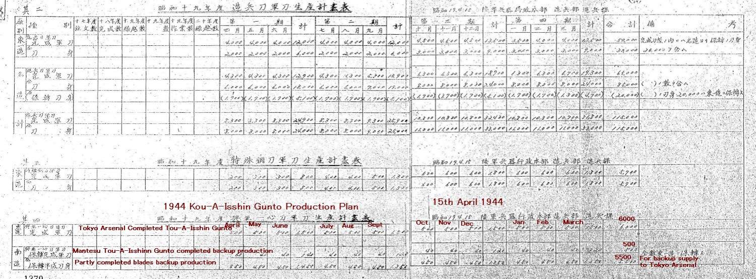

Bruce Pennington Posted April 6, 2020 Author Report Posted April 6, 2020 Just got word back from Richard Fuller and he doesn't own that one. He does have a '41 Koa, NE 414, that I didn't have though! Thomas, My real question is about the production numbers. After re-reading the chart, I feel like it's saying that SMR was producing 1,000 blades per month, not 500. Am I reading this right? Quote
IJASWORDS Posted April 6, 2020 Report Posted April 6, 2020 Where Thomas has underlined machinery, it mentions 11 presses. Probably explains why this model has it's components made of pressed metal, and not cast like Japanese made RS swords. 1 Quote
IJASWORDS Posted April 6, 2020 Report Posted April 6, 2020 Another photo you don't have. A range of 1938 to 1945. You have all the numbers. 1 Quote
Kiipu Posted April 7, 2020 Report Posted April 7, 2020 Thomas, My real question is about the production numbers. After re-reading the chart, I feel like it's saying that SMR was producing 1,000 blades per month, not 500. Am I reading this right? Fiscal year 1944 planned production of military Kōa Isshin-tō came to 6,000 swords. The monthly average was 450 semi-finished blades and 50 finished military swords. All were to go to Tōkyō 1st Army Arsenal and Nan-Man Arsenal was responsible for arranging the transfer. Quote
Bruce Pennington Posted April 7, 2020 Author Report Posted April 7, 2020 Fiscal year 1944 planned production of military Kōa Isshin-tō came to 6,000 swords. The monthly average was 450 semi-finished blades and 50 finished military swords. All were to go to Tōkyō 1st Army Arsenal and Nan-Man Arsenal was responsible for arranging the transfer. So, is:"Mantetsu Koa Isshin Gunto completed back-up production....500" and "Partly completed blades back-up production ......................5,500" a breakdown of the 6,000 "Tokyo completed Koa Isshin"? Quote
BANGBANGSAN Posted April 7, 2020 Report Posted April 7, 2020 Is it possible Neil's Unsigned Mantetsu is one of the semi-finished blade? Fiscal year 1944 planned production of military Kōa Isshin-tō came to 6,000 swords. The monthly average was 450 semi-finished blades and 50 finished military swords. All were to go to Tōkyō 1st Army Arsenal and Nan-Man Arsenal was responsible for arranging the transfer. 1 Quote
Kiipu Posted April 7, 2020 Report Posted April 7, 2020 So, is:"Mantetsu Koa Isshin Gunto completed back-up production....500" and "Partly completed blades back-up production ......................5,500" a breakdown of the 6,000 "Tokyo completed Koa Isshin"? Tōkyō 1st Army Arsenal received 450 semi-finished blades and 50 finished military swords from Nan-Man per month. [More than likely the manufacturer of these blades and swords was Mantetsu.] The 450 semi-finished blades were then completed as swords by Tōkyō. Add the 450 completed swords by Tōkyō to the previous 50 finished swords received from Nan-Man and the Tōkyō total comes to 500 finished military swords per month. 500 swords per month times 12 months comes to 6,000 swords per year. 500 x 12 = 6,000 Quote
