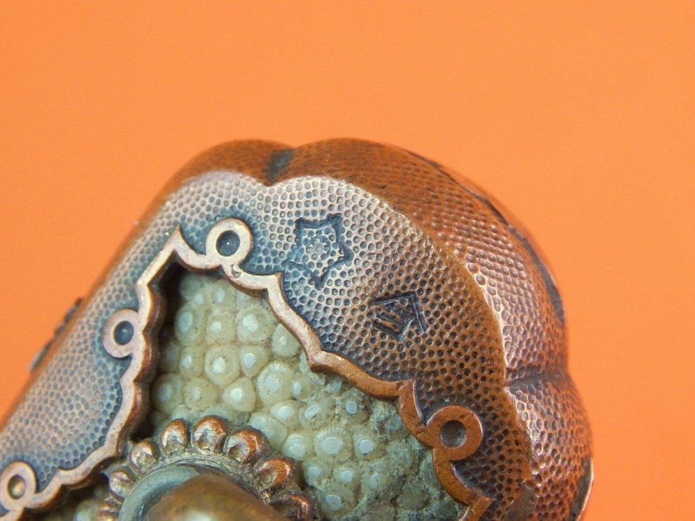

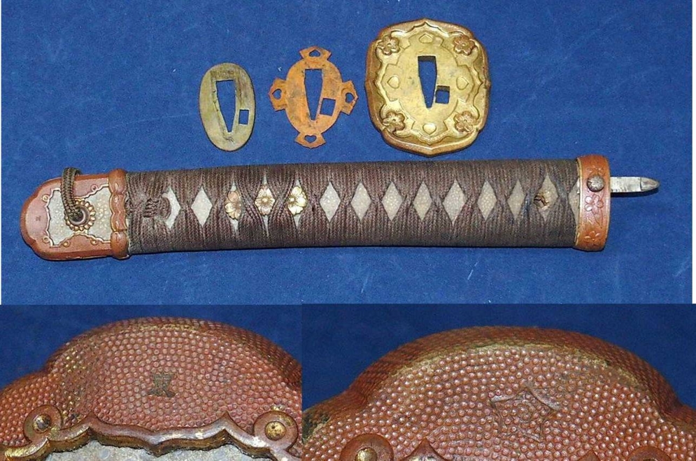

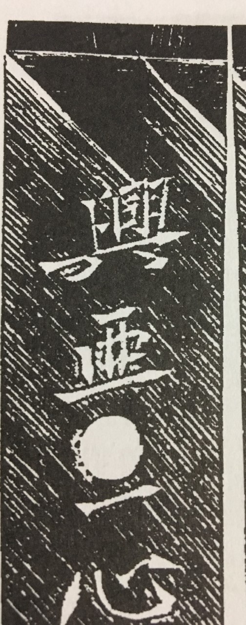

Kiipu Posted March 5, 2020 Report Posted March 5, 2020 I see the "To" but don't see the Nakano stamp? It is not pictured, just illustrated. He states it is on the other side of the kabutogane. 反対側に以下の二つの刻印 The following two stamps on the other side Quote
Bruce Pennington Posted March 6, 2020 Author Report Posted March 6, 2020 It is not pictured, just illustrated. He states it is on the other side of the kabutogane. Ah So! Too bad, I'd like to have that stamp for the Stamps Doc. Quote
Bruce Pennington Posted March 6, 2020 Author Report Posted March 6, 2020 It's possible we have some guys with similar kabutogane. I cannot find the thread, but someone started a thread specifically for high-quality fittings, and some of these stamped kabuto's were posted. Maybe someone can find it and we can check with each owner. Quote
BANGBANGSAN Posted March 6, 2020 Report Posted March 6, 2020 Bruce The link is here http://www.militaria.co.za/nmb/topic/19448-first-time-i-have-seen-this-mark-on-kabo/ Quote
Bruce Pennington Posted March 6, 2020 Author Report Posted March 6, 2020 Bingo! Thanks Trystan! I’ll add that stamp to the Stamps Doc. Quote

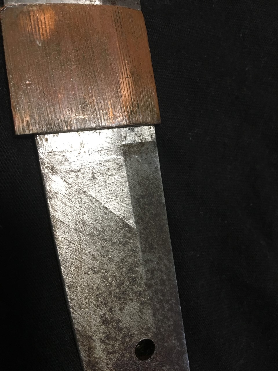

Bruce Pennington Posted March 21, 2020 Author Report Posted March 21, 2020 I just got another one.Nice Sam! Can you do me a big favor and post a pic to the serial number without the habaki? The kanji, as view could be either a "Ra" or "U", and it's blocking the top of the kanji. Thanks dude! The etched kanji on the tsuba simply match the painted assembly numbers on the nakago "2 8 7" Quote
Possumcop Posted March 21, 2020 Report Posted March 21, 2020 Bruce, The Habaki is on very tight, I tried to remove it but didn't want to mess anything up. I will try again and update when I can. The 3 seppa have the 287 to match the tsuba kanji. The Tsuka is a little loose and looks to be missing 1 maybe 2 seppa. Quote
Possumcop Posted March 24, 2020 Report Posted March 24, 2020 Here is a better picture of the serial number and another w/m. Quote
Bruce Pennington Posted March 24, 2020 Author Report Posted March 24, 2020 Wow Sam, thanks for the update, I had it completely wrong on that katakana! It's "RO 273". It's not significant that the fitting numbers are different than the blade number. The korshirae companies used their own numbering system when outfitting a blade. Quote
Bruce Pennington Posted March 25, 2020 Author Report Posted March 25, 2020 RO not NO? Dang, typo, sorry - NO 273. A mind is a terrible thing to waste ..... sheesh. Quote

Kiipu Posted March 26, 2020 Report Posted March 26, 2020 I just got another one. Does the kabuto-gane have a 東 inspection mark? If so, what side? ノ = NO. Quote
Possumcop Posted March 26, 2020 Report Posted March 26, 2020 Kiipu, it does not have that stamp. 1 Quote
Bruce Pennington Posted March 26, 2020 Author Report Posted March 26, 2020 It’s got marks but I cannot tell if they are stamps or not I’m fairly certain mine does. 1 Quote
BANGBANGSAN Posted March 26, 2020 Report Posted March 26, 2020 Looks like T J It’s got marks but I cannot tell if they are stamps or notB637B38F-63E3-490F-9F82-3145DE90FF6D.pngI’m fairly certain mine does. 1 Quote

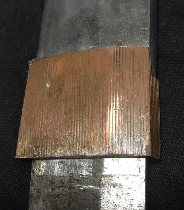

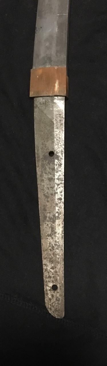

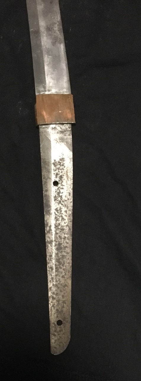

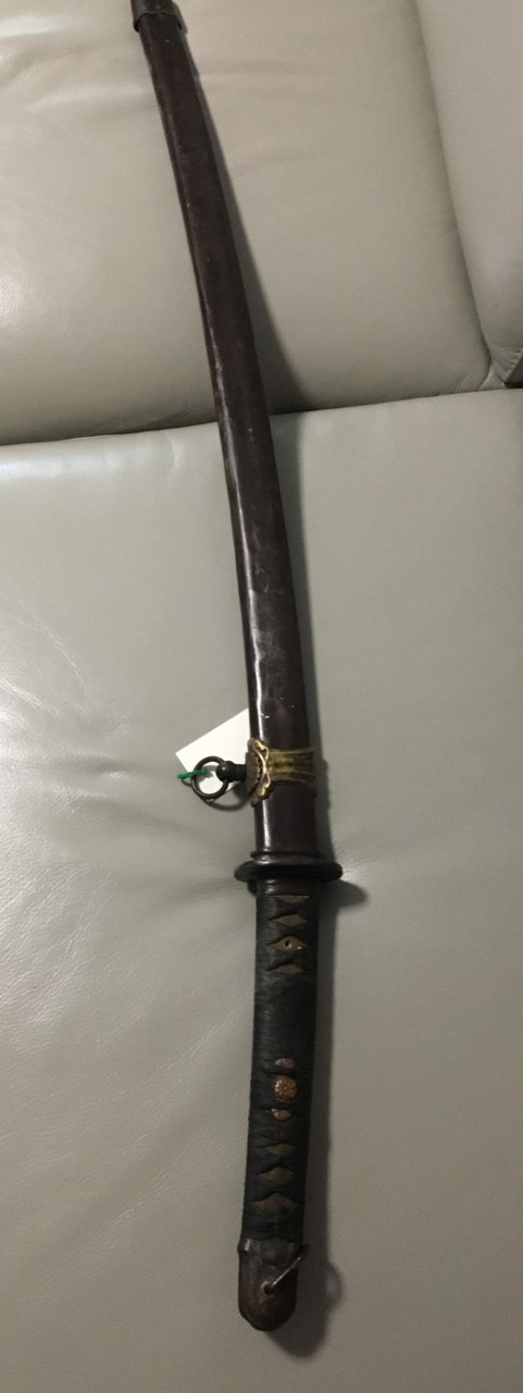

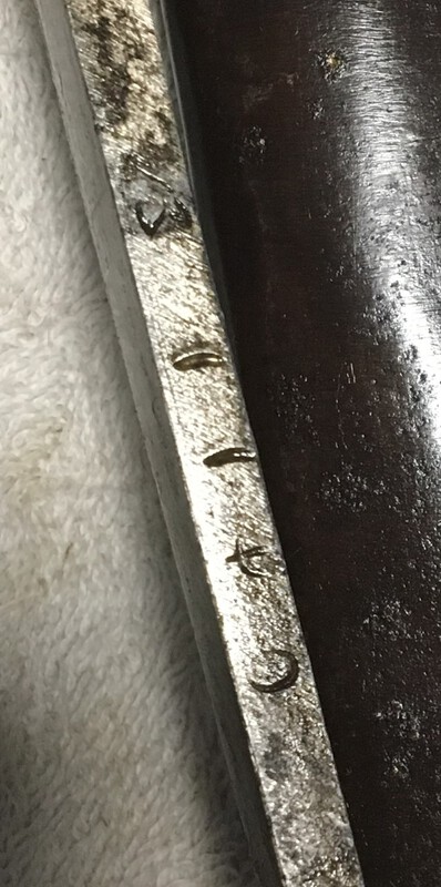

IJASWORDS Posted April 2, 2020 Report Posted April 2, 2020 Hey Bruce, I picked up a very late war rinji, with a mumei blade that looks Mantetsu but no mei or date. BUT, had mune stamps reminiscent of Mantetsu. It is possibly a 1945 desperado, as most of this model had Mantetsu blades. I have three already, you have those numbers. Do these numbers ring a bell? Could it be a RARE one? Looks like Something 1170. 1 Quote
PNSSHOGUN Posted April 2, 2020 Report Posted April 2, 2020 Neil, we can probably tell from how the Nakago is finished, Habaki and Sugata. Quote
16k Posted April 2, 2020 Report Posted April 2, 2020 Looks very Mantetsu indeed! Down to the Habaki? Could symbol be hiragana “RO"? 1 Quote
IJASWORDS Posted April 2, 2020 Report Posted April 2, 2020 JP, habaki looks very Mantetsu, and the file marks match as well. Quote
Bruce Pennington Posted April 2, 2020 Author Report Posted April 2, 2020 Well, Neil, you never cease to amaze! Your serial number is "い" (hiragana for "I") 1170 and is only found on 1945 blades, so your observation about the year was spot-on. I agree the entire nakago, and the kesho yasurime are classic Mantetsu. But no mei! Your "desperado" label may be true too, as the serial number is the highest I've seen. All our '45s so far are 3-digit numbers. This COULD be one of the last Mantetsu made!!! That would be a real find, wouldn't it! The fittings are even "unique-er" than any of that style you've shown us before. Specifically, that ashi is something I haven't seen before. Yes, the band I've seen, but the part where the ring attaches to the band seems unique. Well, one for the record books. I'll add this to the Mantetsu Study files. 1 Quote
BANGBANGSAN Posted April 2, 2020 Report Posted April 2, 2020 Neil Very cool!I saw one like yours before,but the blade in not so good condition. Hey Bruce, I picked up a very late war rinji, with a mumei blade that looks Mantetsu but no mei or date. BUT, had mune stamps reminiscent of Mantetsu. It is possibly a 1945 desperado, as most of this model had Mantetsu blades. I have three already, you have those numbers. Do these numbers ring a bell? Could it be a RARE one? Looks like Something 1170. 1 Quote
IJASWORDS Posted April 2, 2020 Report Posted April 2, 2020 Thanks Guys, the collector I got it from just described it as a late war mumei blade. It wasn't till I pulled it apart that the mune stamps, file marks and habaki filled me with hope that it could be one of the last 1945's made. The blade is stained, but no rust pits or scratches. I am not one who interferes with swords, but will give it a good oily rub to see how it comes up. I am actually pleased there is no mei, as it is very unique, showing that there was no time to inscribe the nakago, but still had the serial number stamped on it. It will be interesting to see if there is any later numbers than this I1170, or other mumei Mantetsu turn up. 1 Quote

Bruce Pennington Posted April 3, 2020 Author Report Posted April 3, 2020 It is the first ヱ WE that I am aware of. Just to clarify, are there any M partial inspection marks on the nakago? If so, what side? Sorry, but the only other stamps are "6 2" matching the tsuba & seppa. No "M". Quote
PNSSHOGUN Posted April 3, 2020 Report Posted April 3, 2020 That is a great find Neil, interesting how the Mantetsu almost comes full circle, from just the SMR on the earliest examples stamp to Mumei on the last. 2 Quote
