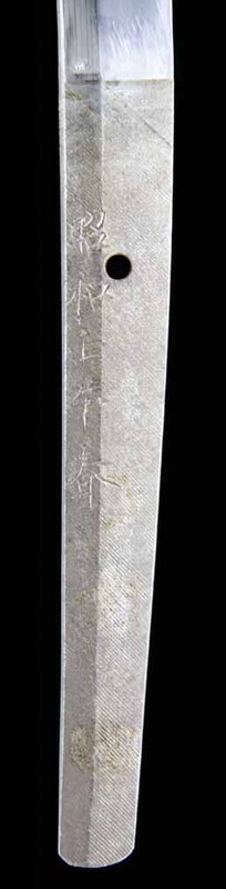

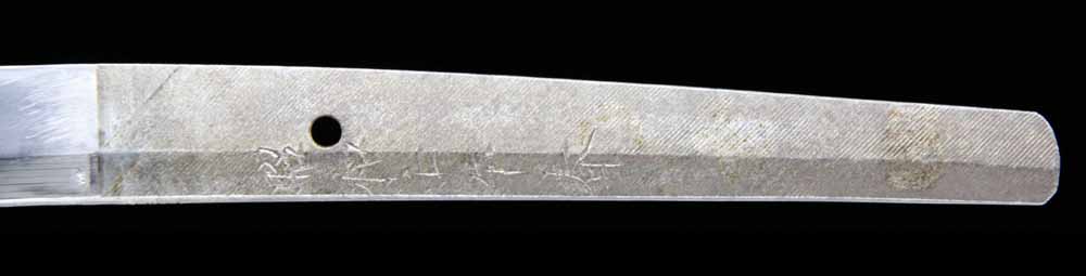

Bruce Pennington Posted December 11, 2019 Author Report Posted December 11, 2019 I have no documentation on why the parentheses was used in this situation. It is not something I have encountered before. I do think that the (イ) falls between ス and い. See the example below. 昭和甲申春 ス 二一九 昭和甲申春 (イ) 五五六 昭和甲申春 (イ) 一六四四 昭和乙酉春 い 六二二 I think so too, Thomas. It's like they hit the end of the Iroha list in '44 before they were done with production. And perhaps they already had the "い" slated for the first '45 run, so they started over with イ, but knowing that they couldn't start over with katakana, decided to bracket it, signifying an "oops" moment. Just wild speculation, I know, but that's what I do really well, Ha! Quote

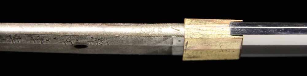

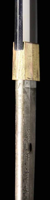

Kiipu Posted December 12, 2019 Report Posted December 12, 2019 My 43 with W stamp has one too! In my post #353, I was referring to Mantetsu 興亜一心 blades with only an M inspection mark on the nakago. These blades may have went to Tōkyō 1st Arsenal as they have a 東 final inspection mark on the kabuto-gane. The Mantetsu I recently bought (sa 520, nan, w, Spring 1943, already in Bruce’s database) has a celluloid same too, so climate may have been a factor... of the lack of Same material. Gotta say, though that I noticed this only recently and contrary to my other swords (granted, all of them older), this same has resisted the test of time without a crack. The Mantetsu that you have does not fit into this pattern as it has additional inspection marks. What kind of reverse markings [omote mei] does your sword have? http://www.militaria.co.za/nmb/topic/26165-attention-mantetsu-owners-a-survey/page-3?do=findComment&comment=271699 Quote

Kiipu Posted December 15, 2019 Report Posted December 15, 2019 I have noticed two of the 1942 dated Mantetsu swords have the combination of a M partial inspection stamp on the nakago and a Tōkyō 1st Army Arsenal 東 final inspection mark on the kabuto-gane. I wonder if this holds true for the other 1942 M stamped Mantetsu blades. ウ二〇 昭和壬午春 http://www.militaria.co.za/nmb/topic/29923-wts-w-stamped-koa-isshin-mantetsu/ ヤ一〇四八 昭和壬午秋 http://guns.allzip.org/topic/188/748295.html#p12 Make it three. http://kajiyahiroshi.com/nihonto/gunto/ka038052/token-ka8052.html 1 Quote
Bruce Pennington Posted December 15, 2019 Author Report Posted December 15, 2019 I see what you're thinking with this Make it three. http://kajiyahiroshi.com/nihonto/gunto/ka038052/token-ka8052.html At a certain level, the kabutogane stamped "To" supports the idea that these blades had been sent to Tokyo Arsenal for "finish" work. (posting the pics, in case the linked site goes inactive in the future) Quote
Kiipu Posted December 17, 2019 Report Posted December 17, 2019 I see what you're thinking with this At a certain level, the kabutogane stamped "To" supports the idea that these blades had been sent to Tokyo Arsenal for "finish" work. I am thinking one of two things happened. One, Tōkyō 1st Arsenal ordered some 興亜一心 blades from SMR in 1942 and Tōkyō 1st had them finished in Japan. Or two, Tōkyō 1st Arsenal gave SMR a contract in fiscal year 1943 and SMR sent some older blades it still had in inventory to meet the monthly production goal. In either case, the powers that be, soon ordered that the army contract blades be marked as 満鐵鍛造之. 1 Quote
