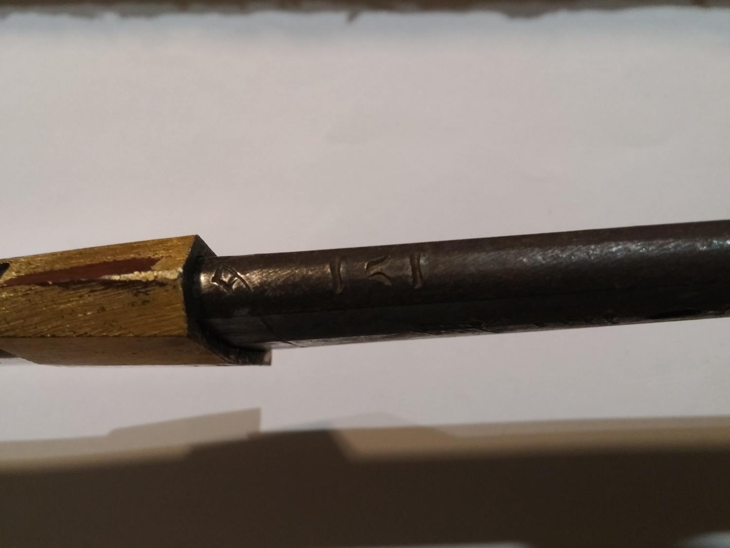

Edward S Posted August 23, 2018 Report Posted August 23, 2018 Hi Bruce, I have a Mantetsu. Spring 43. With 505 on mine. It also has three file scratches above 505 but I have never identified these marks. Edward S Quote

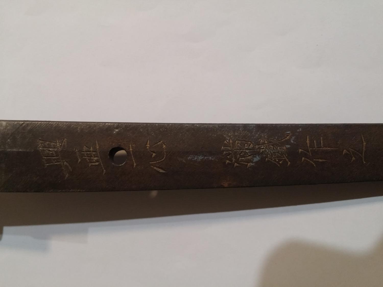

obiwanknabbe Posted August 23, 2018 Report Posted August 23, 2018 Here is mine.. think it reads spring 1940... 356 Quote
Bruce Pennington Posted August 24, 2018 Author Report Posted August 24, 2018 On 8/23/2018 at 1:44 PM, Edward S said: Hi Bruce, I have a Mantetsu. Spring 43. With 505 on mine. It also has three file scratches above 505 but I have never identified these marks. Edward S Edward, those scratches are a katakana kanji. Any chance you could give me a pic of that? It's actually the part of the serial number that I'm interested in the most! If a picture is difficult, maybe you could look at this chart and tell me which one is yours. Quote
Bruce Pennington Posted August 24, 2018 Author Report Posted August 24, 2018 On 8/23/2018 at 6:21 PM, obiwanknabbe said: Here is mine.. think it reads spring 1940... 356 Thanks Kurt! Yes Spring 1940, and "Chi" 356. Quote
Edward S Posted August 24, 2018 Report Posted August 24, 2018 On 8/24/2018 at 12:45 AM, Bruce Pennington said: Edward, those scratches are a katakana kanji. Any chance you could give me a pic of that? It's actually the part of the serial number that I'm interested in the most! If a picture is difficult, maybe you could look at this chart and tell me which one is yours. Quote
Edward S Posted August 24, 2018 Report Posted August 24, 2018 Hi Bruce, Here is the pic you wanted. Let me have your opinion on it please. Edward S Quote
Edward S Posted August 24, 2018 Report Posted August 24, 2018 Bruce, I can’t upload pic for some reason. The three scratches appear to be ‘mi’ from your chart. If you want pics, perhaps the administrator can give me a steer on uploading. Edward S 1 Quote
Bruce Pennington Posted August 24, 2018 Author Report Posted August 24, 2018 On 8/24/2018 at 2:36 PM, Edward S said: Bruce, I can’t upload pic for some reason. The three scratches appear to be ‘mi’ from your chart. If you want pics, perhaps the administrator can give me a steer on uploading. Edward S Thanks Ed, that’s what I was thinking also. No pictures necessary. Quote
